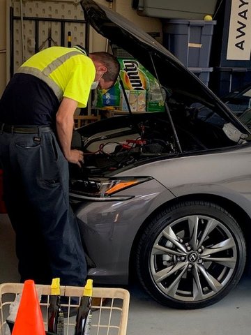

Thanks, at this moment that car is dead in the garage. Service is on the way to jump or tow to Lexus.
It's been 27 months, probably battery gave out on the F Sport.

The Lexus Roadside Surgeon came and jumped it. Now it's at the dealership getting a newie newie battery. Our cars are garaged, but yes Florida summer considerably shortens the life of a battery. The service rep said that I could have called and had a battery delivered and installed (under warranty) but that's no big deal as I asked her to do the 2 year service while they have it. Got an RX loaner for the night. They're going to reset the features that aren't working correctly.
