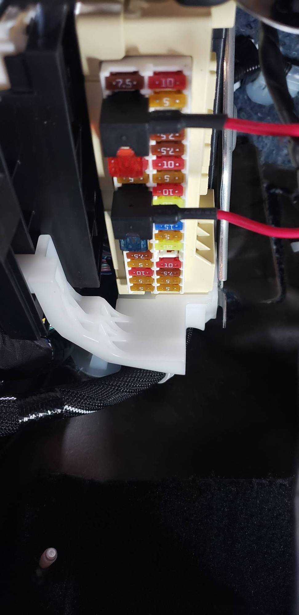

Thanks tike71. I'll check that out. But I need (2) fuse slots. Would you know another?

LOL, I realized that I don't need (2) constant Hot wires, just one. The other one I need to attach is an accessory fuse slot. I'll try this out tomorrow and find out. Thanks again.

Wow, you found the fuse box! I tried looking for it with a reflector mirror and torchlight, but could not locate it after the first try. Will try again when I am free

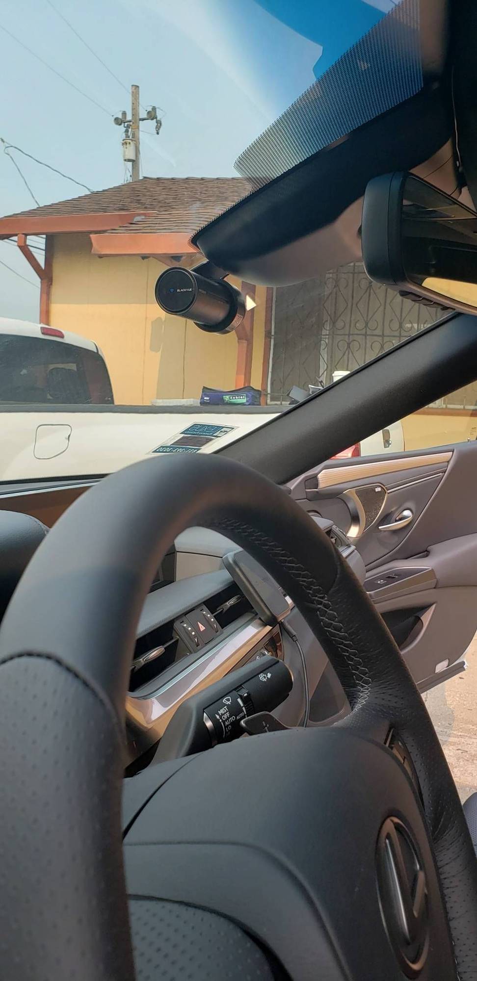

Finally installed the Blackvue DR750 CH-2:

Thanks for the reply. I'm trying to find out which of the fuse boxes have a constant 12V source when the car is OFF. Would anyone know what accessories have a contact 12V "ON'" when the car is off? I would really appreciate it.

Very nice. The ES is very similar to the Avalon. I did a write up last year on how to hard wire a dash cam for those who are interested. I became a religious dash cam user after hearing so many stories of being liable for not at fault accidents just due to the other parties' word. It's amazing how people blame the other driver for an accident they caused.
