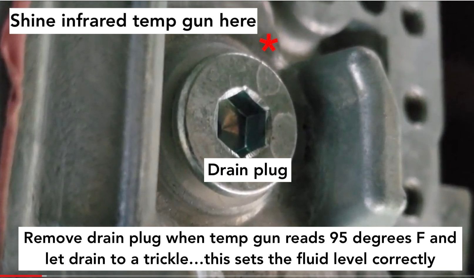

To correctly set the fluid level on the ES350 8 speed after draining and refilling: With engine idling about 4 minutes after cold engine startup on a 60-75 degree morning, shift from Park to R to D to R to Park then get under car and shine infared temp gun at the perimeter edges of the transmission case drain plug. When gun indicates 95 degrees F remove drain plug and let fluid drain to a trickle then reinstall drain plug. Fluid level is now correct.

After considerable research, I conclude the IR gun is not a reliable way to measure ATF temperature inside the pan. Now, you could calibrate an IR gun by making sure you measured the exact same spot on a perfectly clean pan surface and correlated that to actual ATF temperature using ScangageII, TechStream (or equivalent) but why bother if you already have the equipment to measure actual temperature?

Multiple youtube tutorials - some by actual dealership techs - show the IR gun reads the same or only 1-2 degrees cooler than the Scangauge II and Techstream. So if the factory manual says to check the fluid level when the Techstream reads 95 degrees F you could start checking it it at 93 or 94 degrees when using an IR gun.

Good luck. A little dirt or oil can change emissivity by 100x. Again, if the pan is perfectly clean and you measure at the exact right spot you could be close enough. Most average DIY’ers don't have a clue how an IR gun works. Knowing the actual fluid temperature is too important to leave to chance. The very fact that sometimes the numbers are close and sometimes they are not close enough tells you all should need to know.
