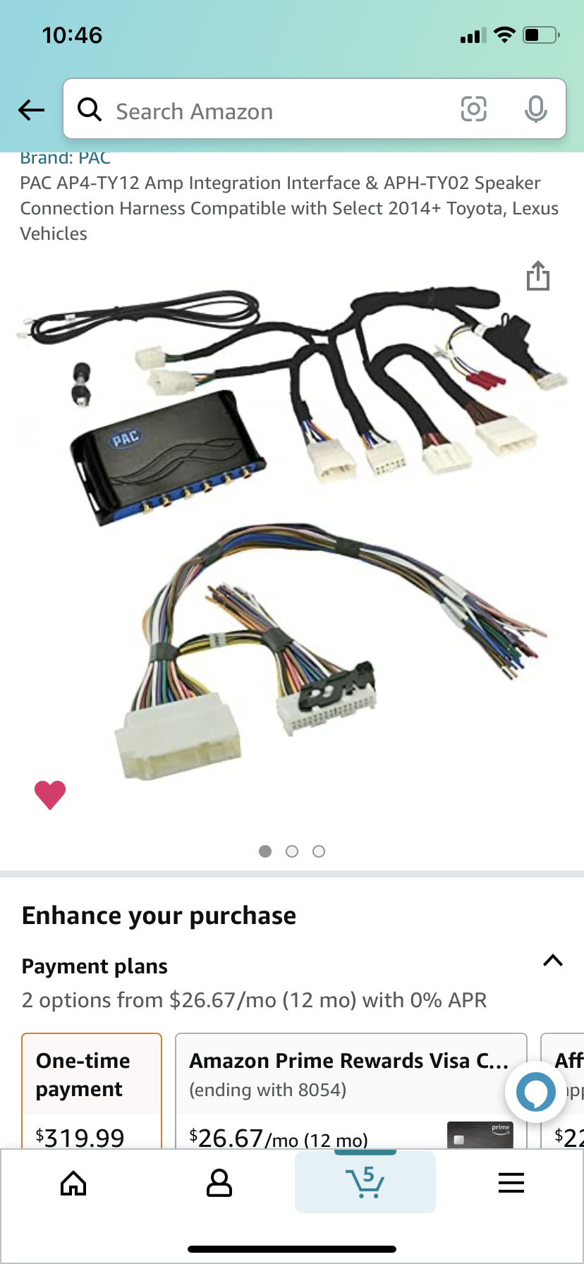

Default Any Good?
Originally Posted by TechNut
I also have the base audio and I completely agree with Mike. I don’t doubt there are audiophiles with a discerning taste that are going to have different standards and expectations. I would argue that for most of us, our tastes aren’t that refined, thus it’s a pretty minor issue. As Mike stated, it sounds like it did on the test drive. If I was that dissatisfied, I would sell it - life is just too short. Alternatively, there are some that have gone to a car stereo shop and purchased the bits needed to make the system function to their expectations. I understand it is a bummer on a new car, and not a cheap car, so please don’t think I am dismissing anyone else’s opinion, but my wife and I are perfectly happy with it.
I was wondering if anyone has tried this from PAC. I’m about to upgrade my sound system on my 2021 ES350. Thanks.

I recently replaced my 27 year old Miata sound system with one put in by the local stereo shop. Made a world of difference and didn’t cost much.
I don’t know much about sound systems and I’m perfectly satisfied with the system in my 2021 350 ES but if you’re unhappy, these local stereo guys can often do wonders affordably.
I've used the lower connector on my 7th GEN ES with great results. Works really well to aftermarket speakers accordingly. I still have the stock speakers in the doors but will be changing them soon. Some of the speakers were different from the diagram so I had to test each with a speaker wire powered and label whivh wire pair was which speaker because almost every wiring diagram I found online was wrong pin wise. Night and day difference so far tho and highly recommended. 💯
