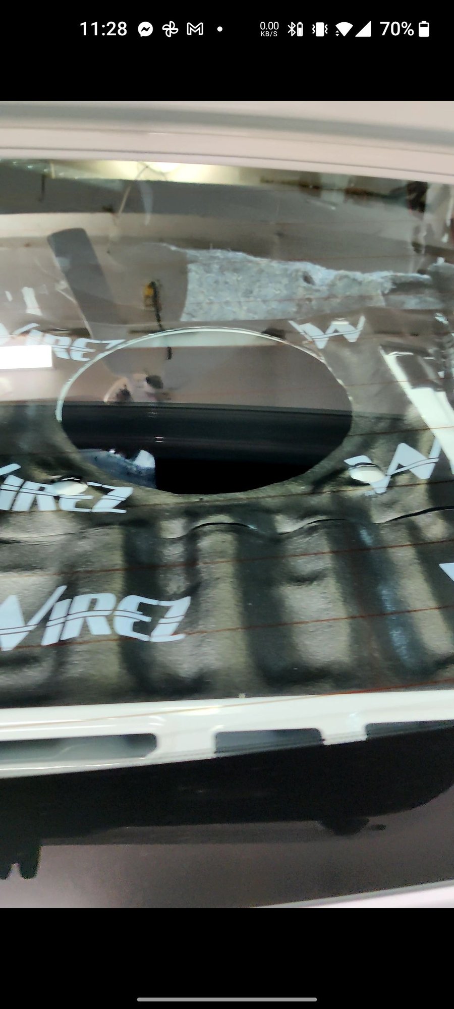

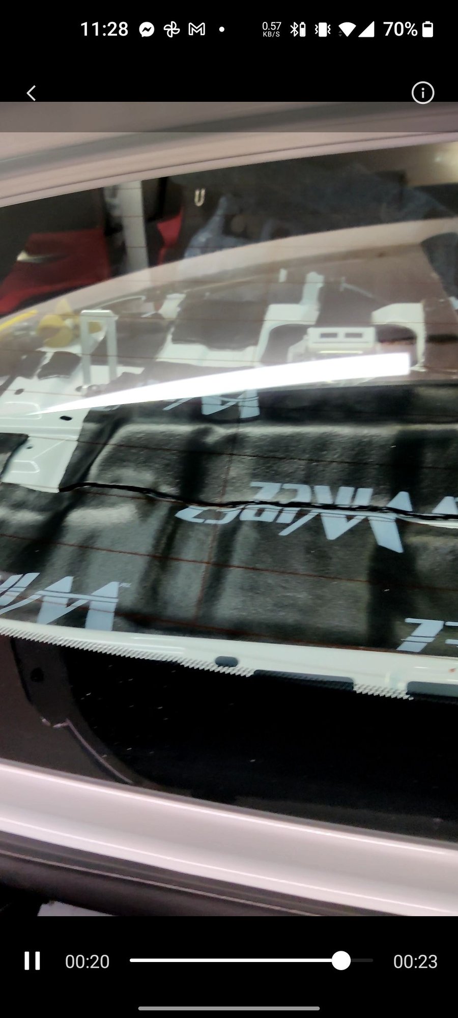

Here's some more photos of the sound deadening upgrade. I have some video that I will add to a full tutorial on how to upgrade the entire system from scratch and everything I've learned about this specific vehicle from day one. 🙏
