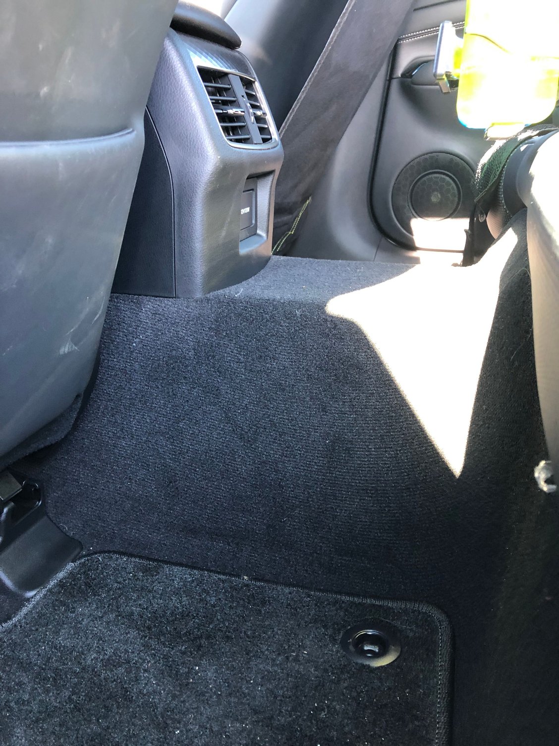

The unibody that Lexus is using right now on the 2019 ES 350 will be the same for the AWD version. This according to my Lexus sales person. Notice the middle hump in the rear compartment of my 2019... Not needed for FWD only vehicles.

My mom's old 2009 or 2012 (I can't remember) Avalon has a hump there too. I'm not sure if the hump means AWD is coming or we're just looking too far into it.

That is such a less intrusive tunnel than what I have in my GS. Pardon the dirty seat back.

Probably because the GS is RWD based, as opposed to the ES's FWD,

I believe that is correct.
On the AWD versions of FWD-based vehicles, like the NX or RAV4, Toyota/Lexus is using an electric motor to provide power to the rear wheels, instead of the mechanical linkage that is used on the AWD versions of RWD-based cars, like the GS, to provide power to the front wheels. And using the electric motor to send power to the rear wheels requires less space.

Without a doubt.
That's true, but only for the hybrid versions. The NX and RAV4 non-hybrid versions do have a shaft running back from the engine to power the rear wheels.

Thanks for the clarification.
That said, AWD versions of FWD cars do have smaller humps than AWD versions of RWD cars. As I think about it, though, I'm guessing that the taller humps required in AWD versions of RWD cars is, in large part, the result of the need for more space for transmission components.

I agree. The entire engine/transmission layout affects it, not just the drive shaft.
