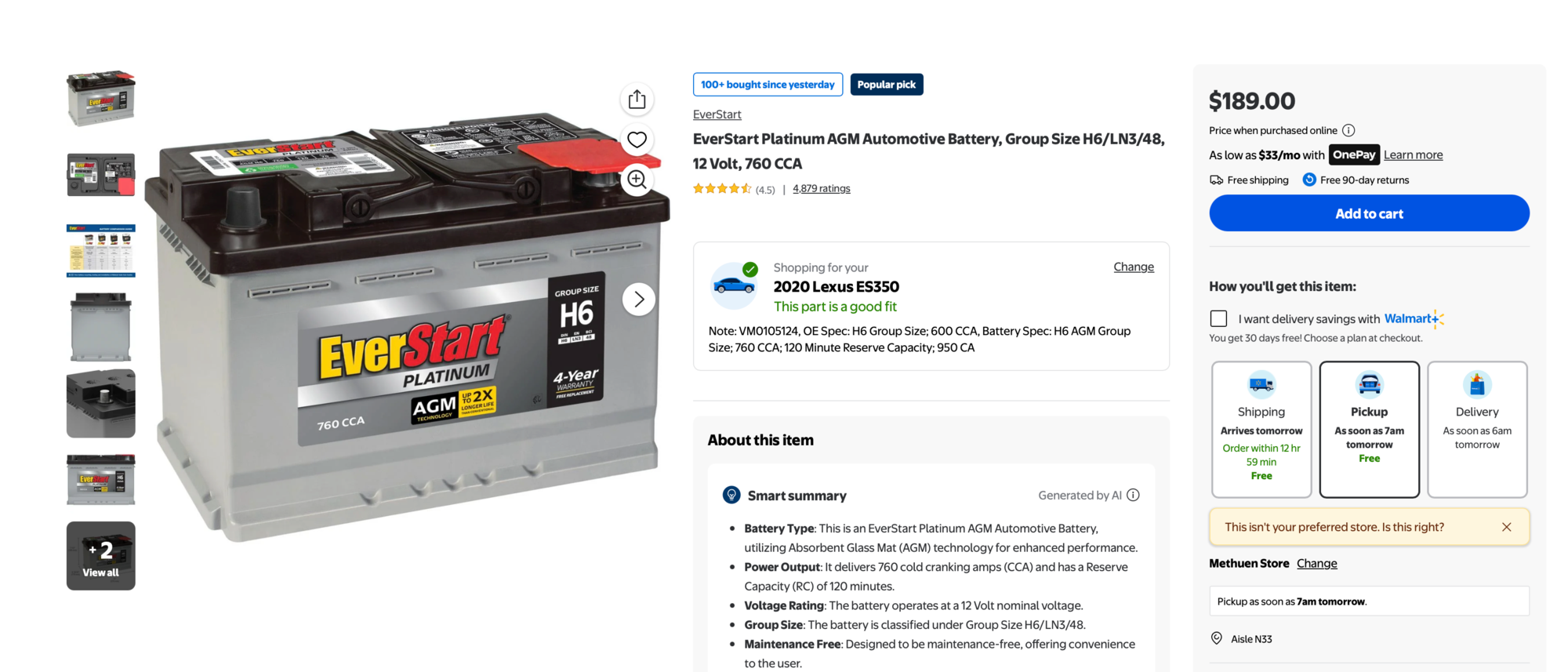

Just following up in case anyone else is looking for a non "Lexus" alternative. I did not find any flooded cell H6 available. Walmart sells the Ever Start H6 AGM and Costco sells the Interstate H6 AGM for well under $200.
