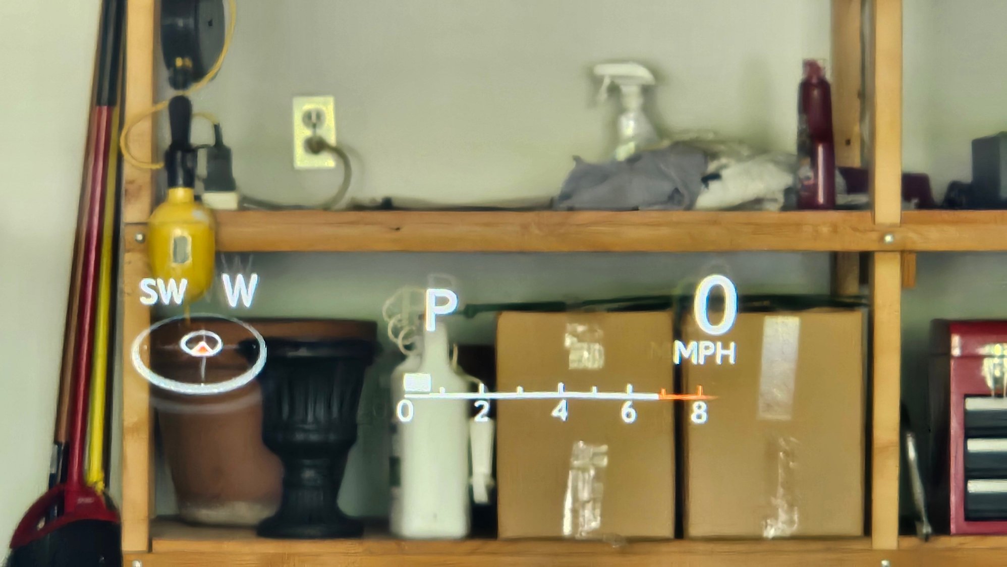

I went through all of my HUD settings and they have been enabled for HUD display for my Android Auto using Google Maps,
but it is not showing on my HUD. I have a 2025 ES350-UL --- What am I missing?
As you can see. 1st Pic are my settings
2nd Pic is the Route I just Entered showing turns in Android auto and Google Maps
3rd Pic is the HUD showing only the Compass and Speed. (Sorry for the background junk)
From the HUD illustration and the 🄰 callout description on page 82 of the 2025 LEXUS ES250, ES350 OWNER'S MANUAL USA AND CANADA ONLY:
🄰 Driving support system display area (→P.84)
Navigation system-linked display area (if equipped)
Displays the following items which are linked to the navigation system:
• Route guidance to destination
• Street name
• Compass (heading-up display)
Notice that "Navigation system-linked" qualifier?
Best as I've ever been able to determine, that's solely and strictly Lexus native navigation system supplied information. Neither Apple CarPlay nor Android Auto map and navigation apps operate under or display their information through the native navigation system. So, whatever a map and navigation app operating on and display screen composing on a smartphone that gets sent to Lexus's CarPlay or Android Auto software for displaying isn't navigation system-linked display information that will display in that HUD display area nor the Multi Information Display's (MID) driving support system information display tab screen.
P.S. I did see VeroCarGuy's post in the "Google Maps no longer giving Voice Directions .............." thread. That's the first time anyone has posted on getting any Apple CarPlay or Android Auto map and navigation app route guidance data displayed on this ES generation's HUD.

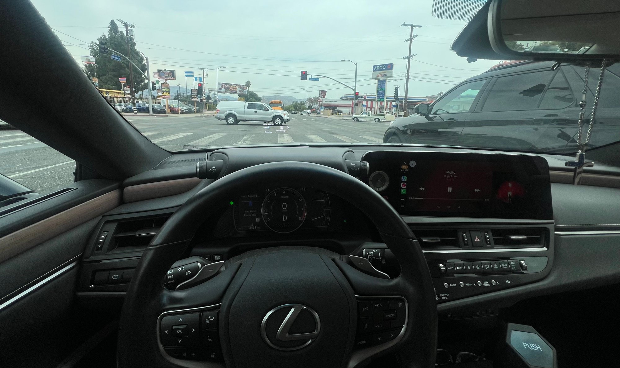

Ok I finally was able to get the gps directions on the HUD. This is using my iPhone with Apple maps. You may have to zoom in a little to see the HUD display since the reflection isn't clear to see with a phone camera.
Like I mentioned before, the controls of the ES head unit and hud is very inconsistent. When I left home, the gps map shows on the HUD and also on the screen. I switched the screen to Youtube music and the HUD remained showing the gps.
Later when I switched the main screen to the Lexus menu to adjust the radio sound and went back to Apple carplay, gps the map changed. It no longer displayed the map on the mainscreen with a highlighted path to follow. The HUD then only displayed a red pin and a distance left to my destination. It was very frustrating trying to get the HUD directions back I was never able to do it again.
I canceled my current trip and started a new one and the gps HUD is no longer showing directions. I set the gps to another location and the screen displayed it but the HUD would not show it anymore. I toggled thru all the menu to see what can be done and no luck. HUD refused to show gps directions again.
As you can see from the photo above, it is possible to get gps directions on the HUD. But as for a consistent reliable control to toggle things you want, it's just not happening. Lexus did a poor job of writing the software in these cars. It's very frustrating.
I was driving the whole time and I didn't want to fiddle with the controls and get in an accident.
I'll poke around some more next time I'm driving it in a small population area.
OK, thanks for the effort. If it's flaky, it not worth using. And I use Android Auto and Google Maps exclusively. -- So that does not seem to be available.
