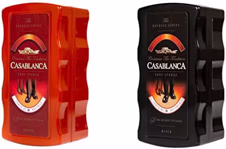

I know people won't like this. But, I have a black interior. I have actually found that a little black shoe polish paste seems to cover up or for sure, dull any blemishes in the door handles and the plastics in my car. And they have not come back.
Hey, if it works, it works
I used this before I found the real solution, and it worked, sort of, it was a bit shiny.
what did you used maybe I’ll try that .
also does it come in a matte finish!!
many thanks
i know I could paint it but a little polish is much better since I can just tape it up and polish it with it’s still on the dash without removing that part!!
