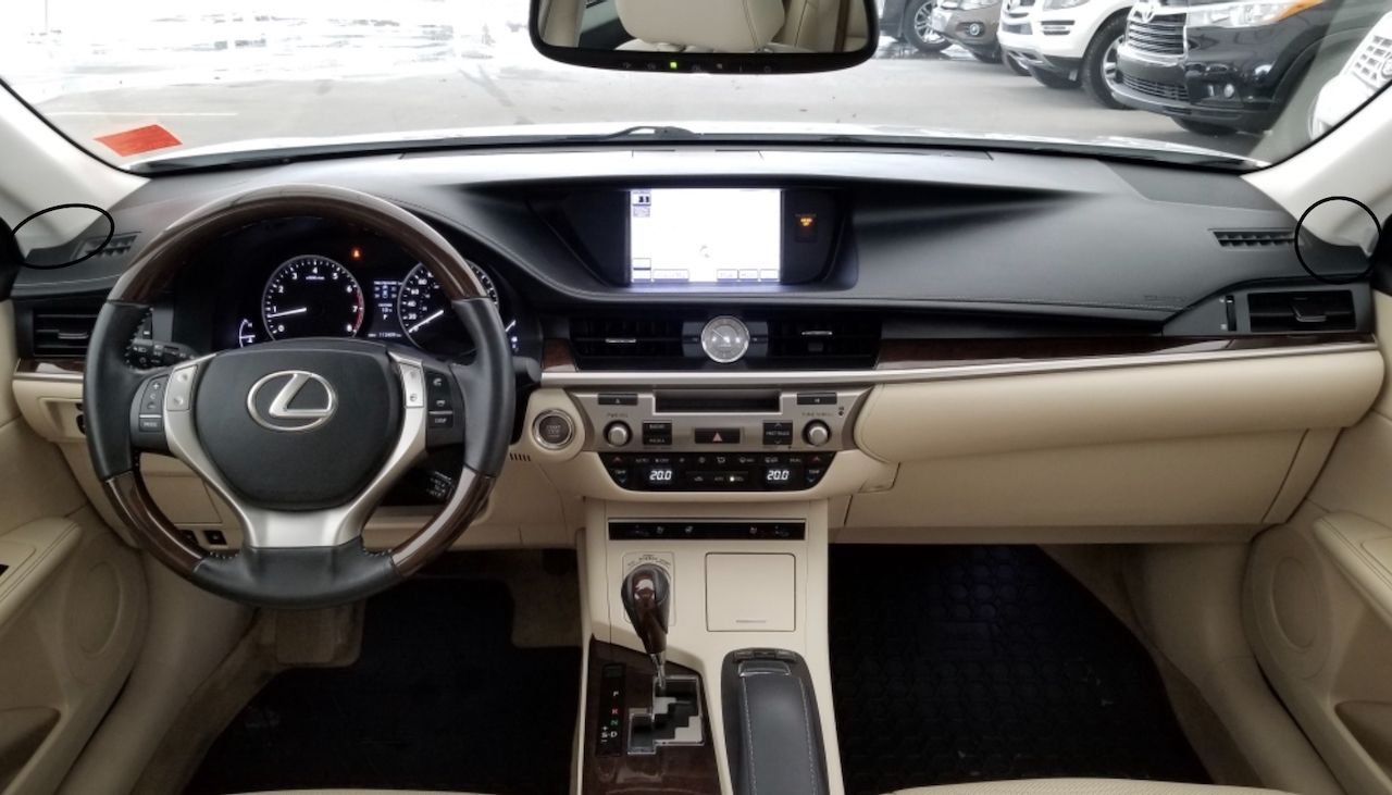

Just a thought but... on my Gen 6 there were plastic shims wedged in between the bottom of both "A" pilars and the dash as shown. The only reason I can think of for this is that there was a plastic "creak" originating in these areas. Maybe?

If you were referring to my 07 GS350 Dash Rattles, it was creaking all over the dash in many places..... A lot of the problem was where the windshield met the dash. The dealerships would fill these areas with many different sound deadening materials and literally start rebuilding the entire dash. It would quiet the area down for a month or so, and the creaking would stop in warm weather. Once it cold however, the creaking would return. Some of the people that lived in South Florida and other warm areas of the country did not have any problems.

Gen 6 ES 350
