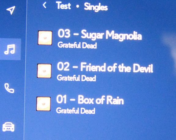

Originally Posted by Myshkyn
How did you determine the order in which the files were written to the drive?
I watched as Windows Media player wrote them, one by one, for many albums that I added singly over a period of time.
And they invariably play in alphabetical order, in the car.
Well, that would debunk the "order of writing" hypothesis. Just to be sure though, I am talking about the writing that takes place when I copy a folder (album) from my hard drive to the USB drive. During that process I can't see which order the files are copied to the USB. That is different from the writing that takes place when the album is being ripped from the CD.

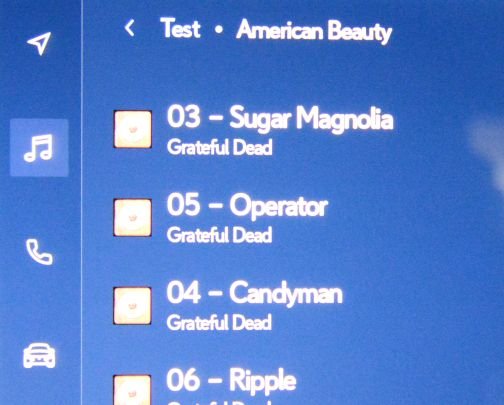

Good point. I hadn't done this for a while, so I added an album to my USB drive today. It was the ripping that I remembered, where Windows Media player showed me the sequence in which the files were processed. It did not show me the sequence in which they were written to the USB drive. So I added one more album by a different method. Once I had ripped it, I used Windows File Explorer to copy the audio tracks in track order, one file at a time, to the appropriate folder on the USB drive. Even with this album, my car ignored the track numbering and insisted on listing the songs in alphabetical order.
That's a good experiment, but not the result I expected. Maybe I'll give it a try and see what I get.
Vinyl made a comeback, but unfortunately not in cars.
I haven't played with this for over 3 years, so I'm going from memory. The order that the ES plays the tracks on a USB stick has nothing to do with the order they were copied or the track numbers. The play order is alphabetical based on file name. In other words, if you plug the USB stick into your computer and look at it in Windows File Explorer with an alphabetic sort, that's the play order. If you want to change the order, change the track file names.
As a test I just copied a folder to USB. On the Lexus it shows them in numeric/alpha order, like 01, 02, 03. Then I went into that folder on the USB and changed the numbers, switching 04 and 05. It didn't change the order and list them in the new order. So, it doesn't look like Lexus is doing the ordering based on the new file names.
As a test I just copied a file to USB. On the Lexus it shows them in numeric/alpha order, like 01, 02, 03. Then I went into that file on the USB and changed the numbers,switching 04 and 05. It didn't change the order and list them in the new order. So, it doesn't look like Lexus is doing the ordering based on the new file names.
Still have that album, bought it 50+ years ago. My subconscious knows which song is supposed to be next after any given song.
I tried the "Wrangler" experiment, but couldn't replicate the results. I copied three files one at a time in reverse order to a USB. When I put it in the ML audio system they were displayed in reverse order, the order in which I copied them. In Wrangler's system they displayed in alpha/numeric order. Strange. Different systems? I have a '23 ML.
I still don't understand it, but they can't revoke your soul for trying.
