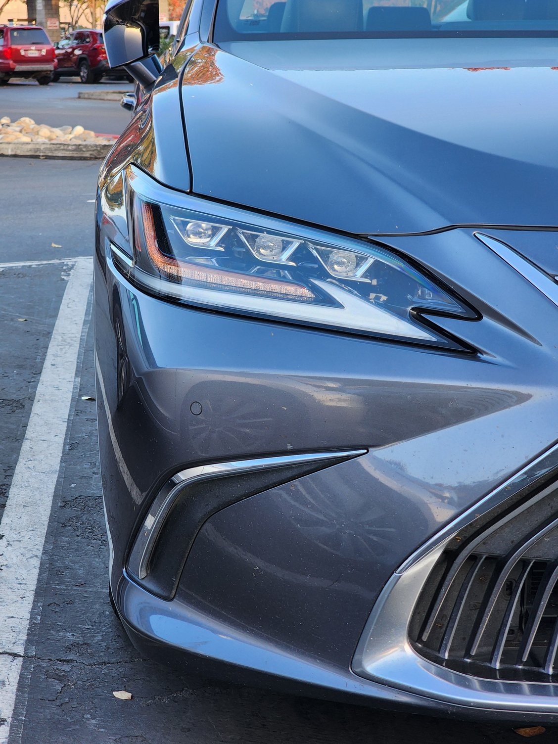

Hi everyone. New to the club and first time posting!
I was to some research on complaints of the ES when I stumbled on this thread. So since it was on my mind, I noticed in the parking lot of my local Costco and exact (a year or two older) car like mine. They parked in the spot directly in front of me. I immediately noticed that the triple beam LEDs were different shapes. So maybe the entire housing got updated? Hopefully they address any possible issues with condensation. Those within the control of Lexus obviously.
Just some food for thought hope you guys have a good day.
19 - 22 triple beam
19 - 22 triple beam
23 - triple beam
23 - triple beam

The design was changed in 2022. The housing and the LEDs are the same. I don’t know if they improved the sealer and the o-rings.
