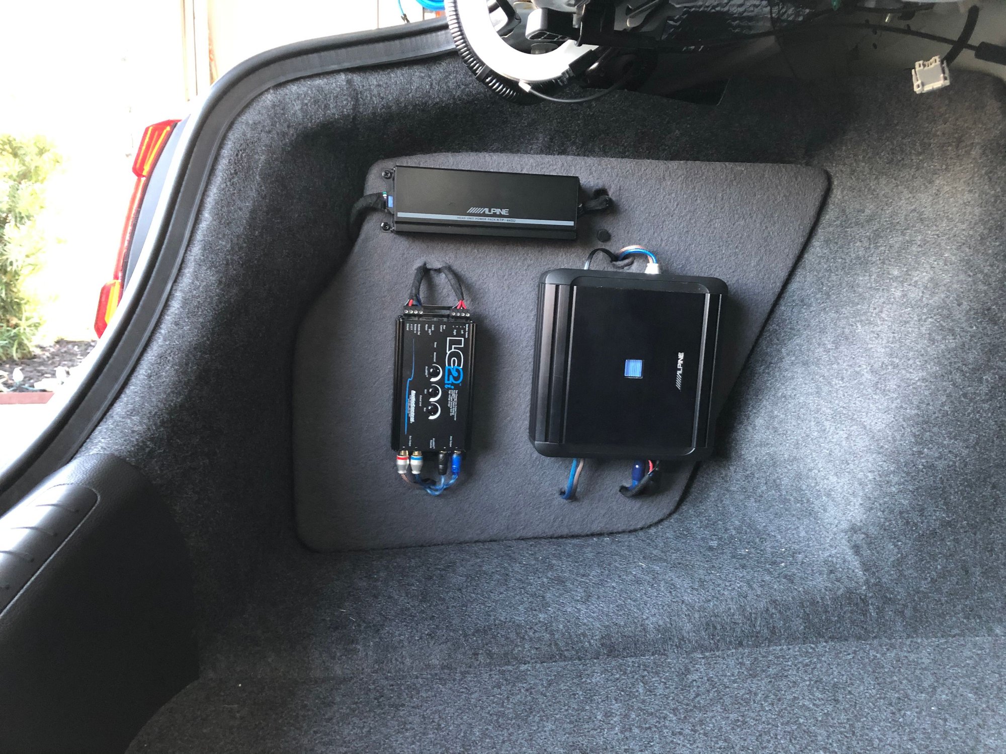

I’m actually considering this route however then I have to figure out how and where to mount the amplifiers. I just think it would be cool to have a W6 in the rear deck. If I go the separate box in the trunk idea, then I’m putting a 12W7 in it because why not. I already have a LC7i sitting around with 2 Slash 500/1 and a Slash 300/4.

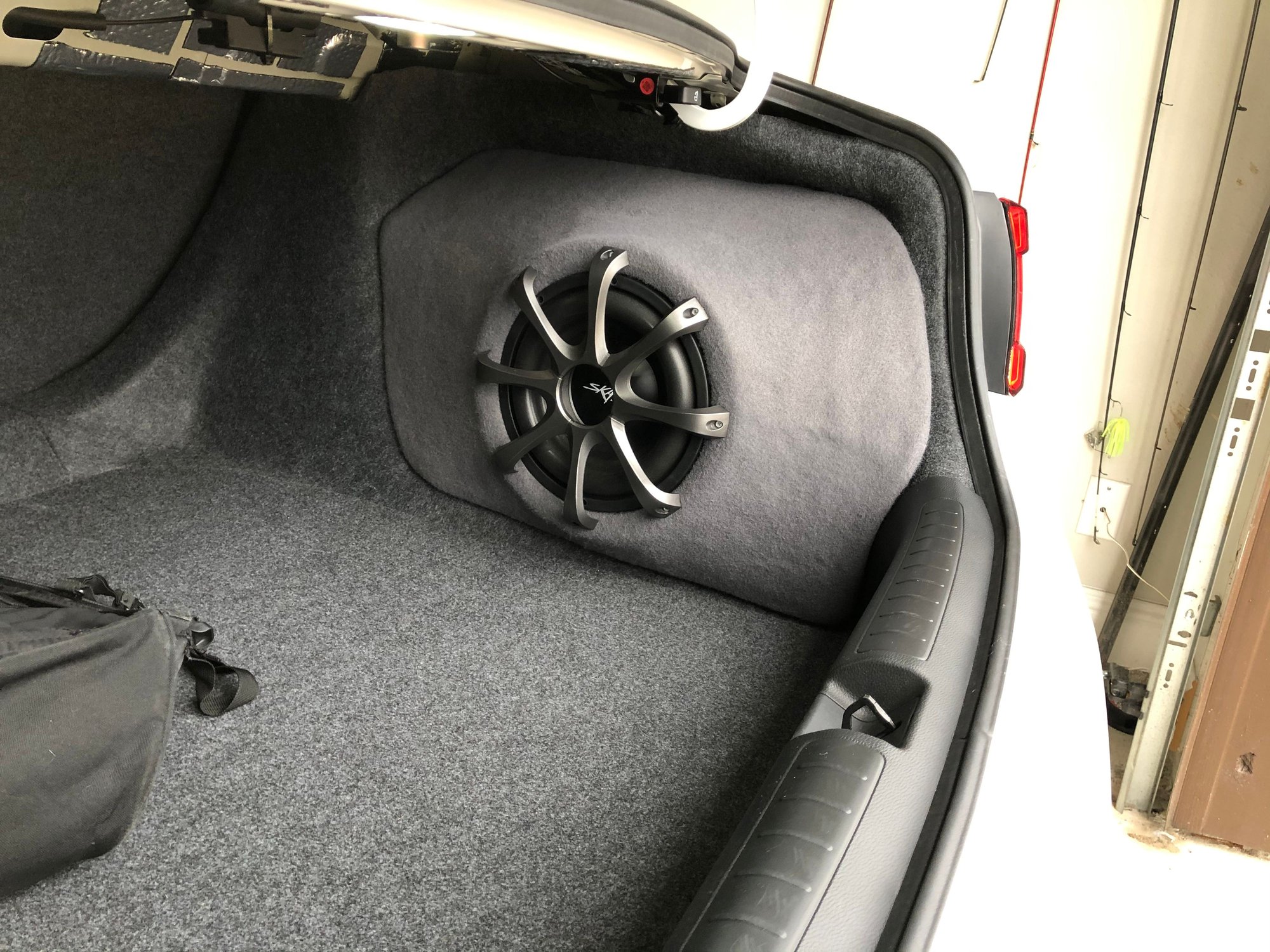

In my opinion, the cleanest install still provides the most use of your truck would be to do a custom fiberglass box on the side. I did this in my previous car, and while it was a lot of work, the results were phenomenal.

I had the installer do it in black flex tubing with just the gray plugs and closed, worked really well easy and safe to hook up and unplug when I needed the full trunk.
Unfortunately looks like the factory system pretty severely limits and processes the speaker level output to the factory sub and other locations though. I’d gladly have paid extra for a set of RCAs or other sort of clean line level out or even a USB digital stream out because they know damn well millions of Toyota customers are adding aftermarket stereos. Hell even a headphone level clean output of the sound would be a huge help.
That said a clean and pretty trunk install isn’t a priority for me, there’s usually a lot of junk in there anyways.
and a benefit to a box vs a built in install like custom fiberglass is a box can be moved and experimented with. My last car consistently sounded best with the box close to the corner and port facing inwards.
