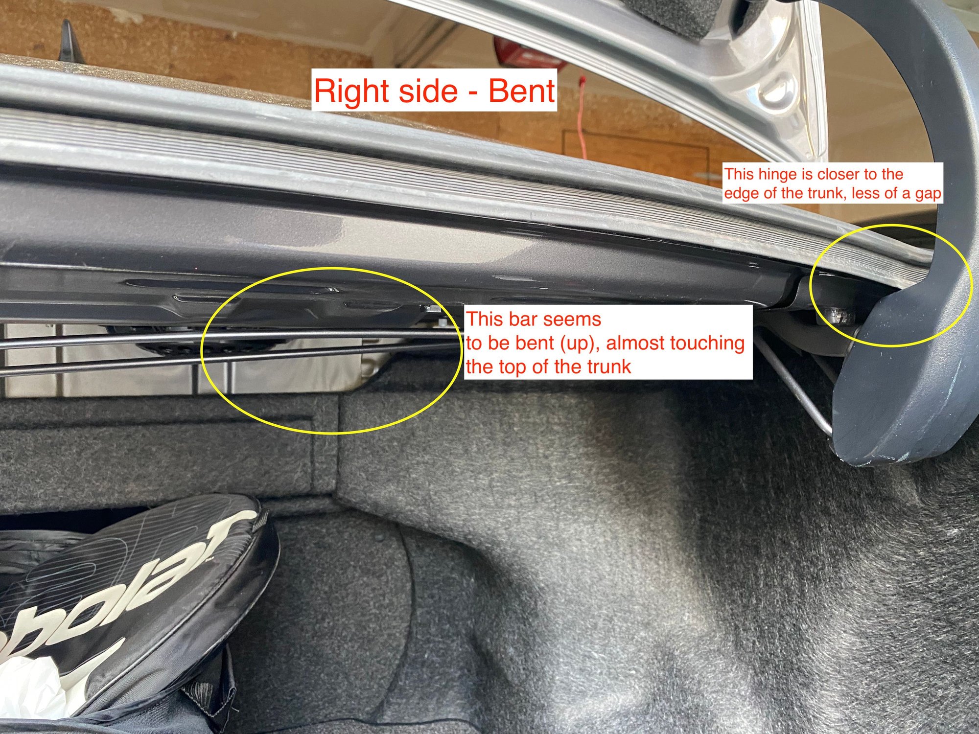

Show a photo of the misalignment?

So the left side is fine. The right side is bent. Seems like one of the bars is bent up towards the top of the trunk, and the hinge on the right is also bent up and almost touching the edge of the trunk. I think I can just try to bend it back in to place?

Do you have equipment to straighten them out? If not, its better to take it to a body shop for them to straighten it out. Don't bother with the Lexus dealer, they are not equipped to fix things like this, all they will do is order replacement parts to replace the bent/damaged items - a last resort but very costly.
