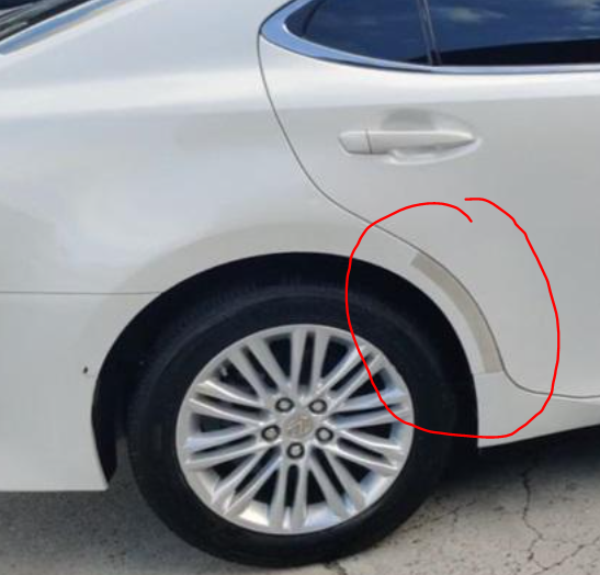

Hi everyone,
I have a 2013 Lexus ES350. I cannot seem to find this part anywhere. If anyone could help it would be greatly appreciated. Thanks.

The protector sheets are Part number(s):
Left - 58748-33071 and Right - 58747-33071
They are $29.95 apiece...installation not included LOL
Meant to limit stone chips to the fender flare out.
Are yours damaged or missing or just discolored at the edge?
A bit of Bug and Tar remover on a cotton bud will clean up the edges

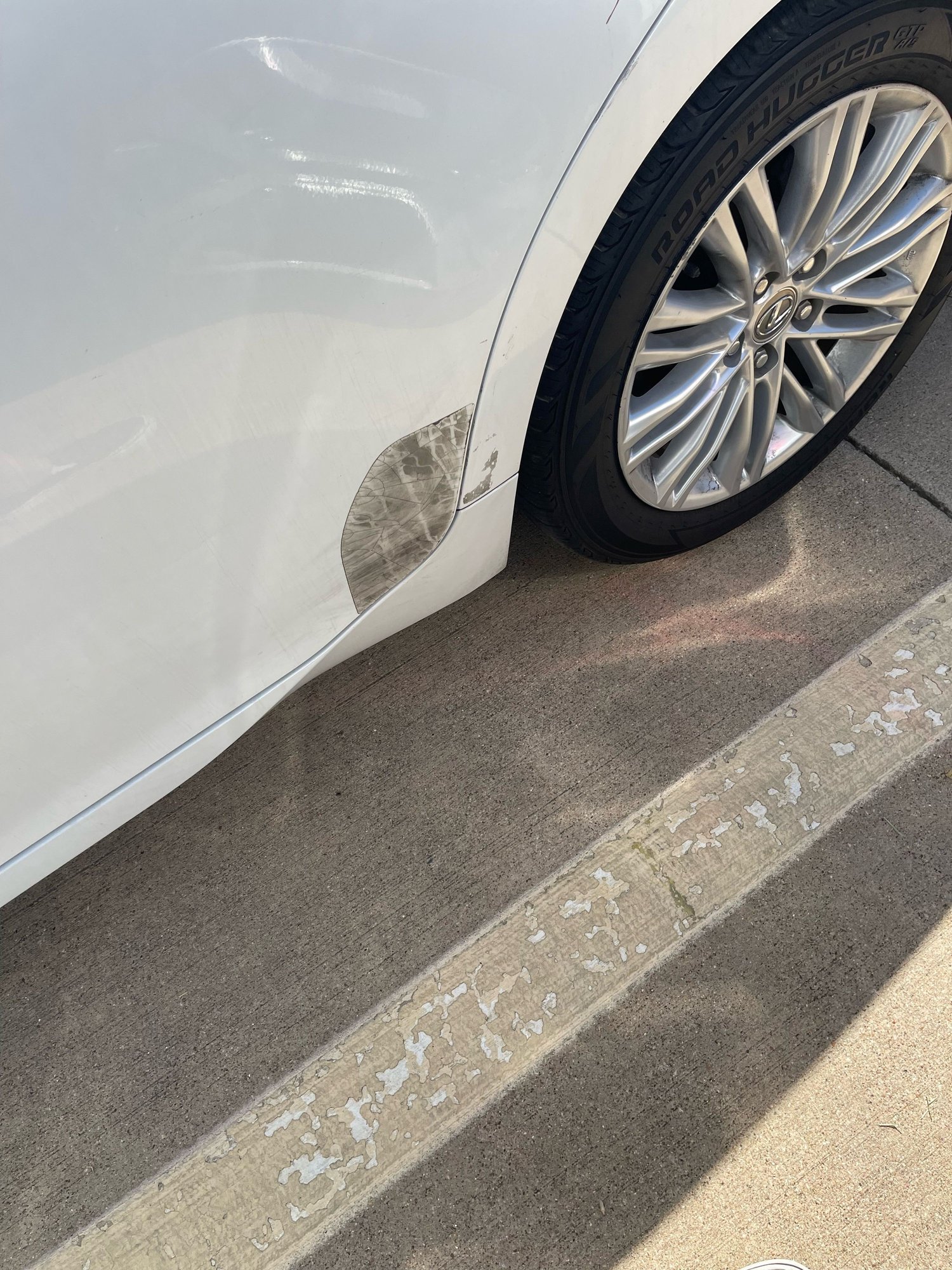

Well I found that pic online - but the next two are actually photos of my car now.
They are very damaged I think. What would the part number for that other section be? Do you know?
Driver Side
Passenger Side

Can you not just get them replaced with protection film from a local detailer or film specialist? Perhaps even "do it yourself" if you're handy?
Amazon Amazon
Or is there some special "Lexus quality" to them that's not apparent?

The pieces and the "Bumper Applique" (w/ Lexus spelled out!) are quite a bit
thicker than regular 3M film. Didn't know until I looked them up that they were
$30 (and $100 for the rear bumper piece). Previous CL threads have asked
how to remove them. Heat gun and some Goo-Gone will do that.

If that is $30 each then I think I'd be just using the 3M and be prepared to replace it more frequently. Probably be tempted to try it myself, they're not in a terribly complex location. Strange to see them as dirty as those shown though....wonder what was driven through...or is that maybe the dirty residue not cleaned off after having removed them?

That looks like it's dirty on the inside. Won't that damage the paint if you try and remove it?
