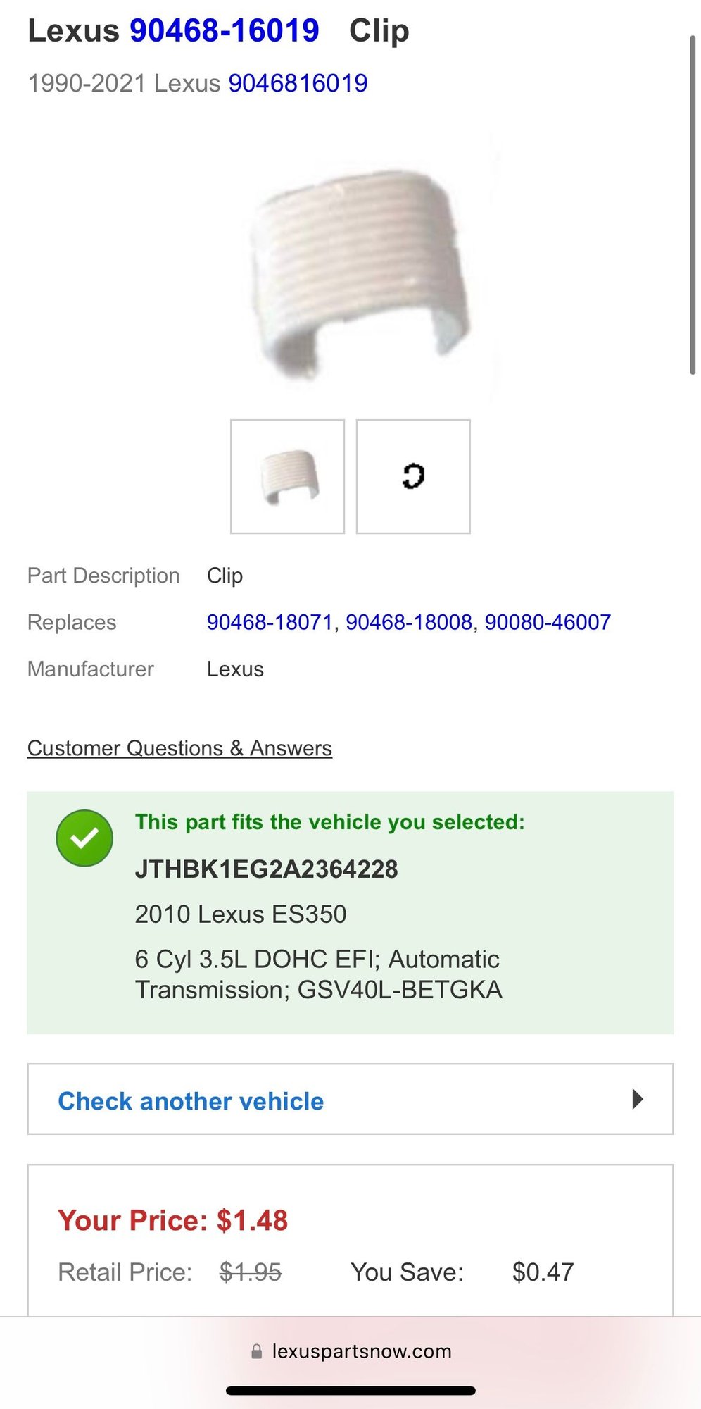

Lexus OE hog rings

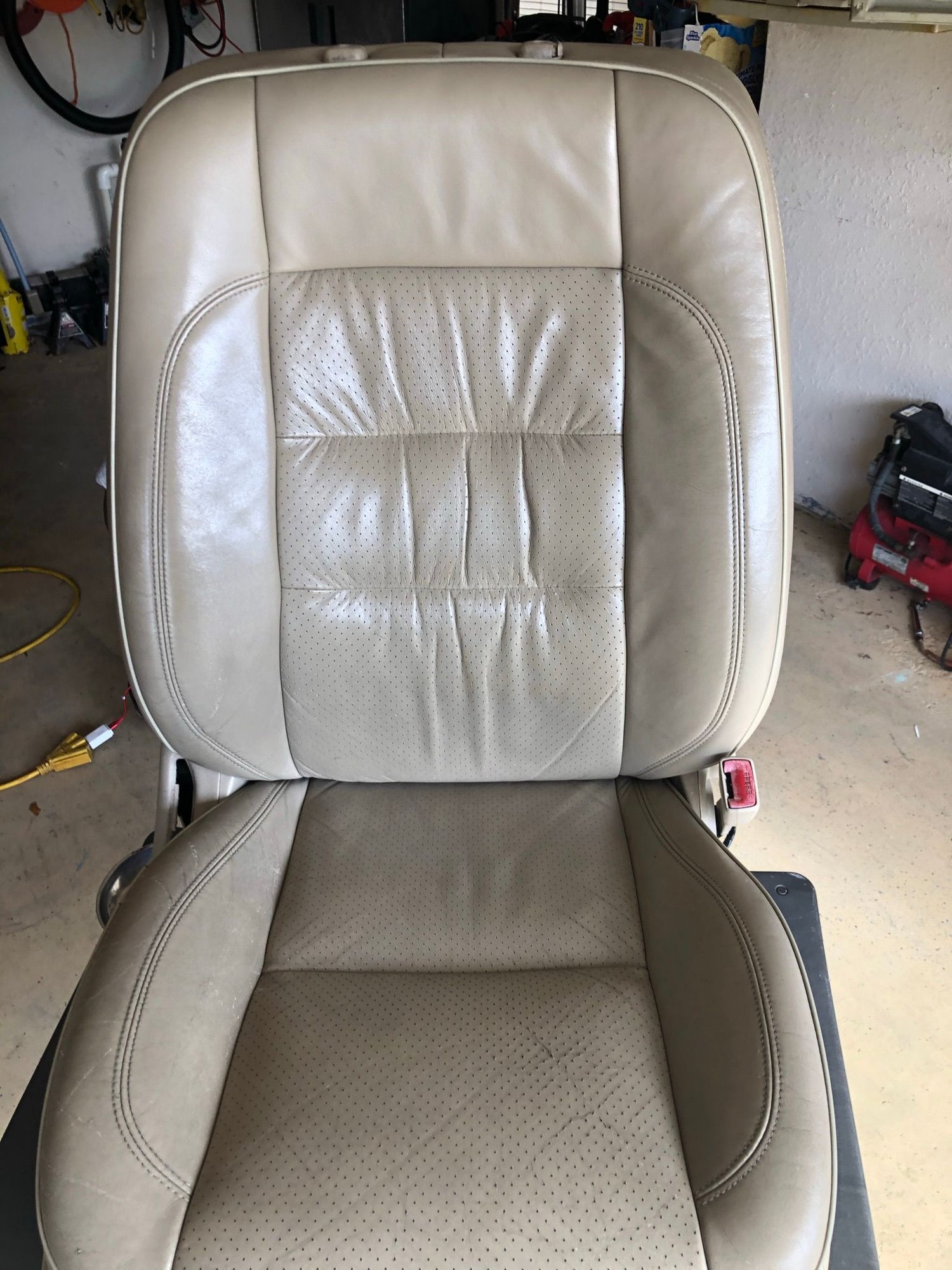

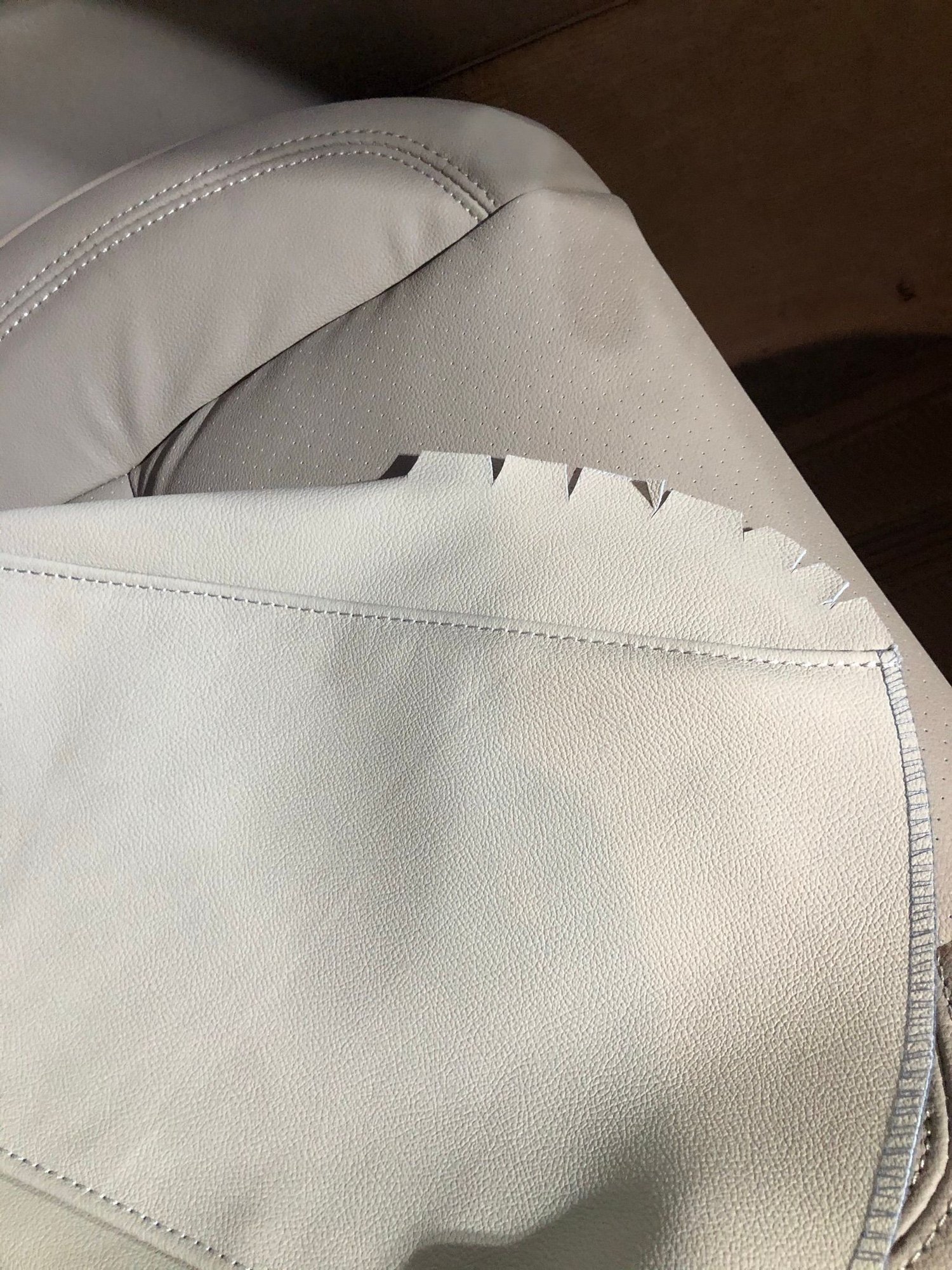

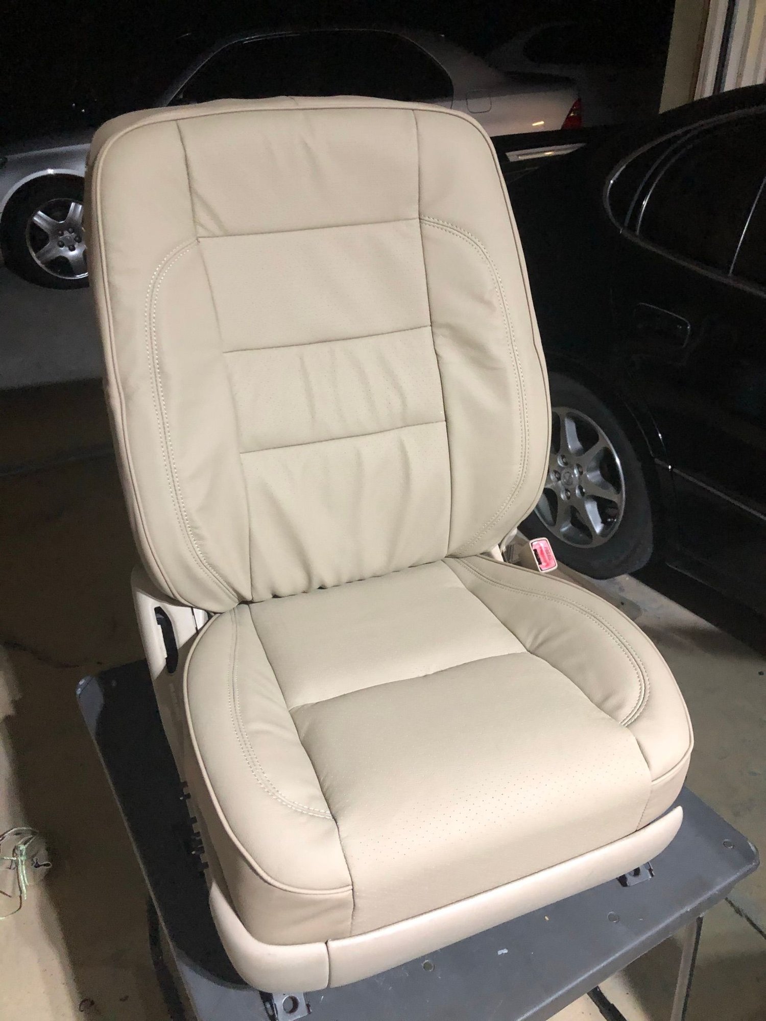

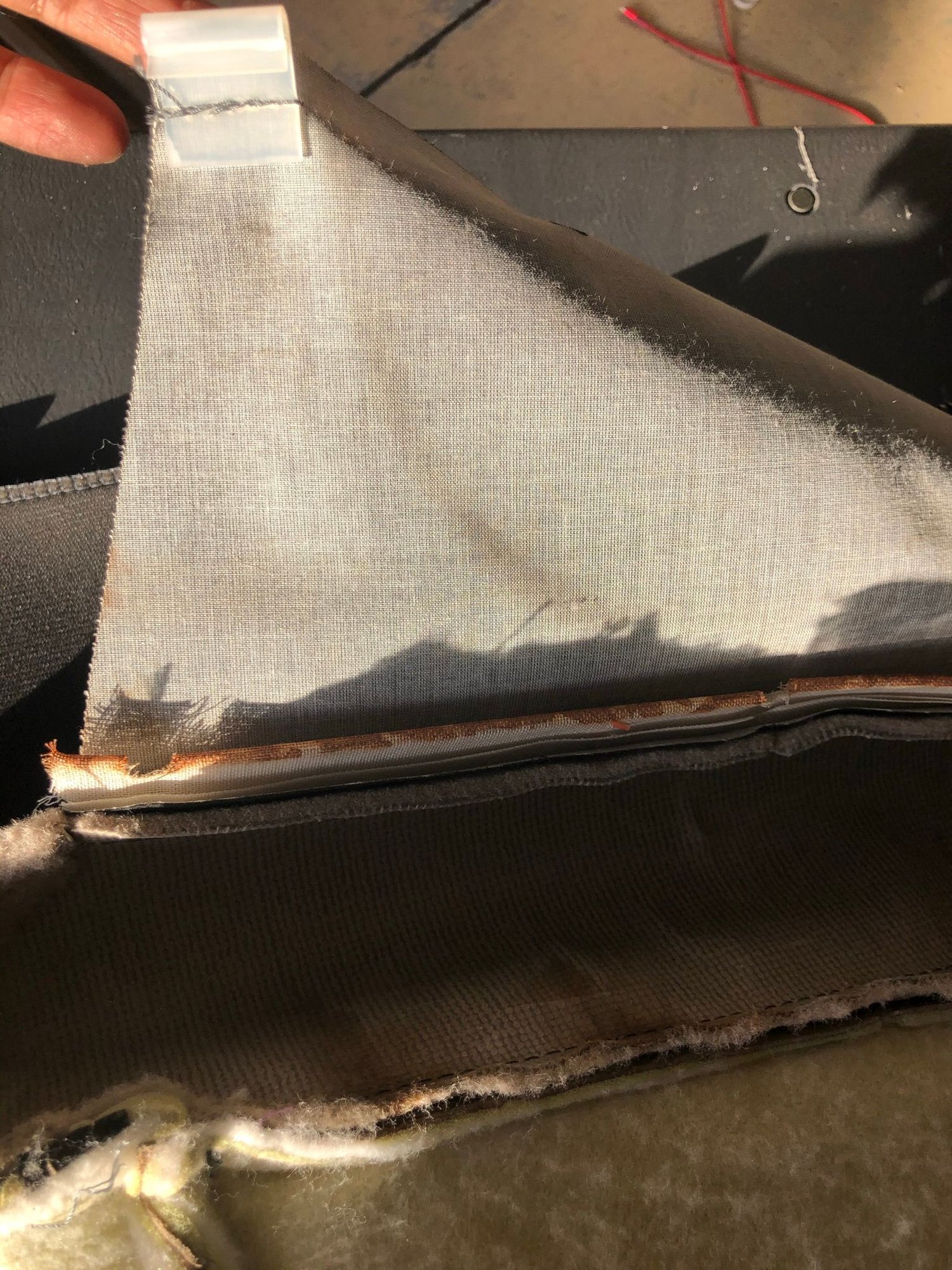

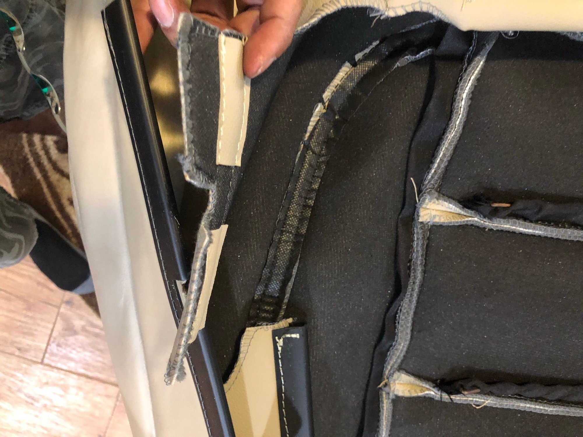

Some shots I took while doing my RX350

Well I ended up using the following products and the results came out very good. If I had to do it again I would splurge for original leather from Lexus, but this eBay kit is not bad if you’re in a budget. Here is everything I used:
