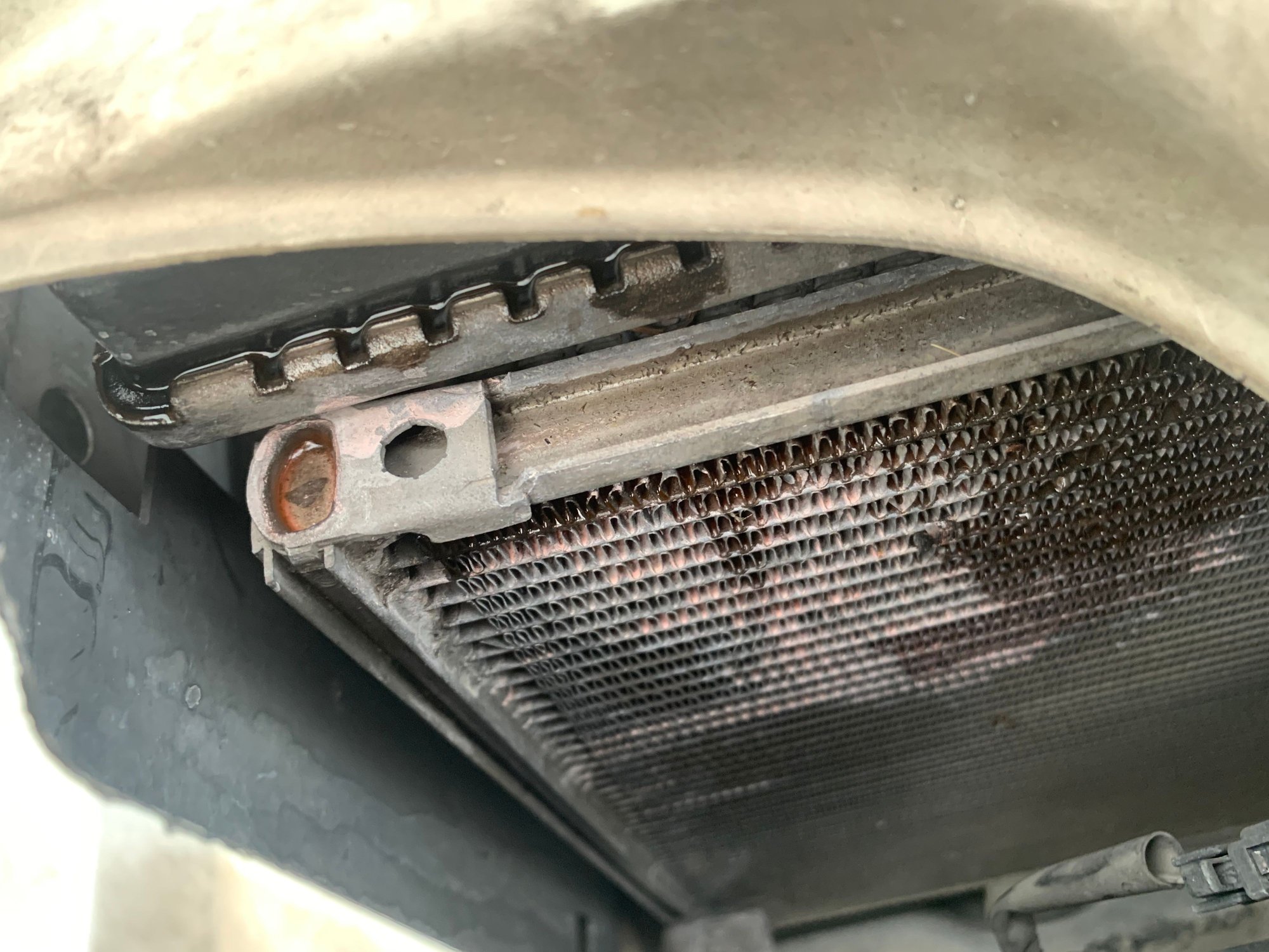

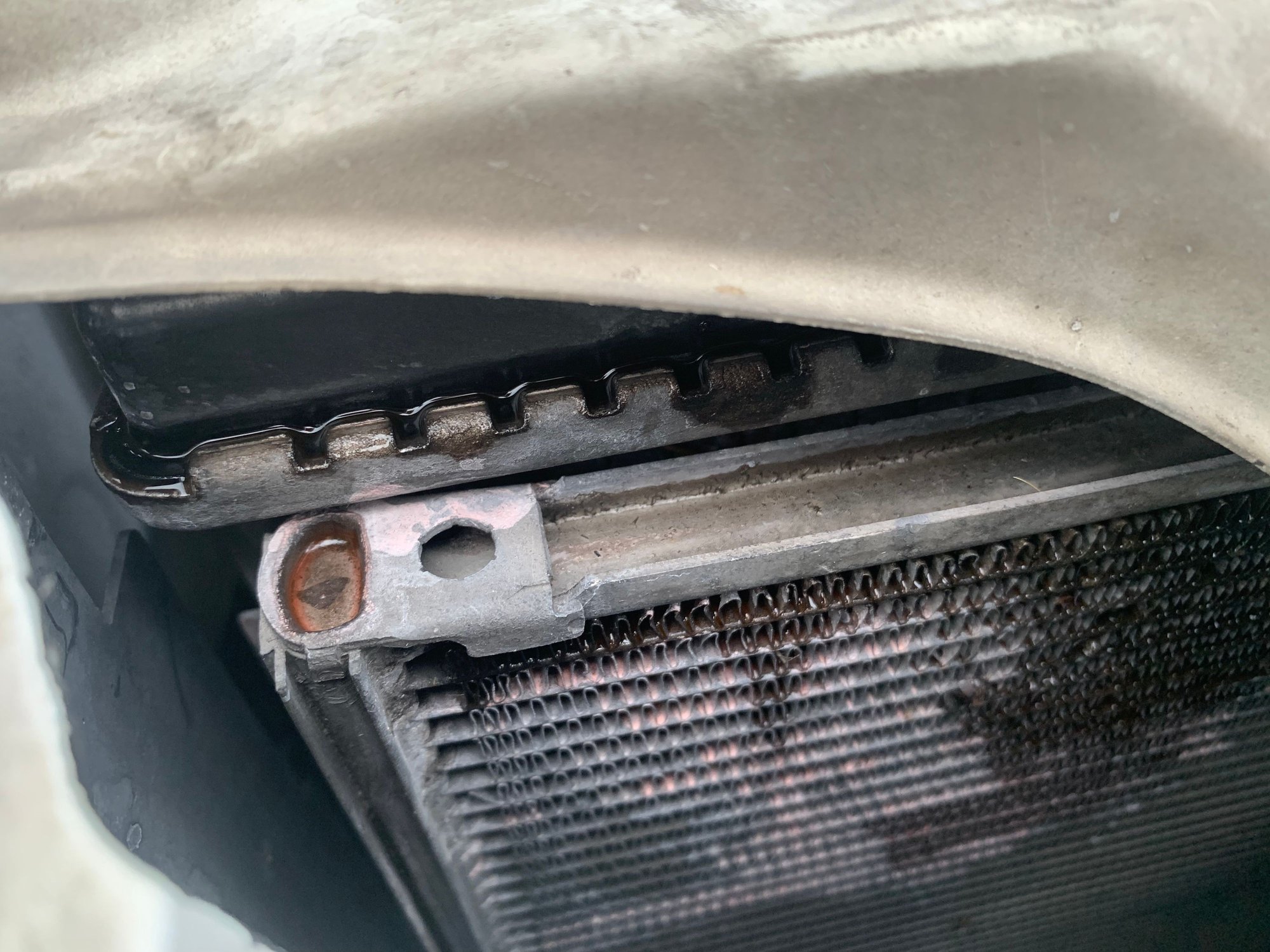

I sent a photo here to my other mechsnic and he said this is likely the issue. Photo attached. I actually just put some k seal in because it worked on my old vw cc. How long should I run the engine with the radiator cap off?

That rad is a ticking time bomb replace it ASAP.

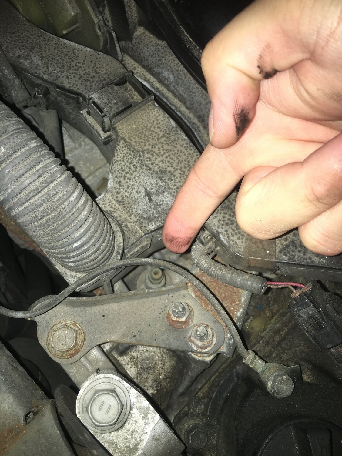

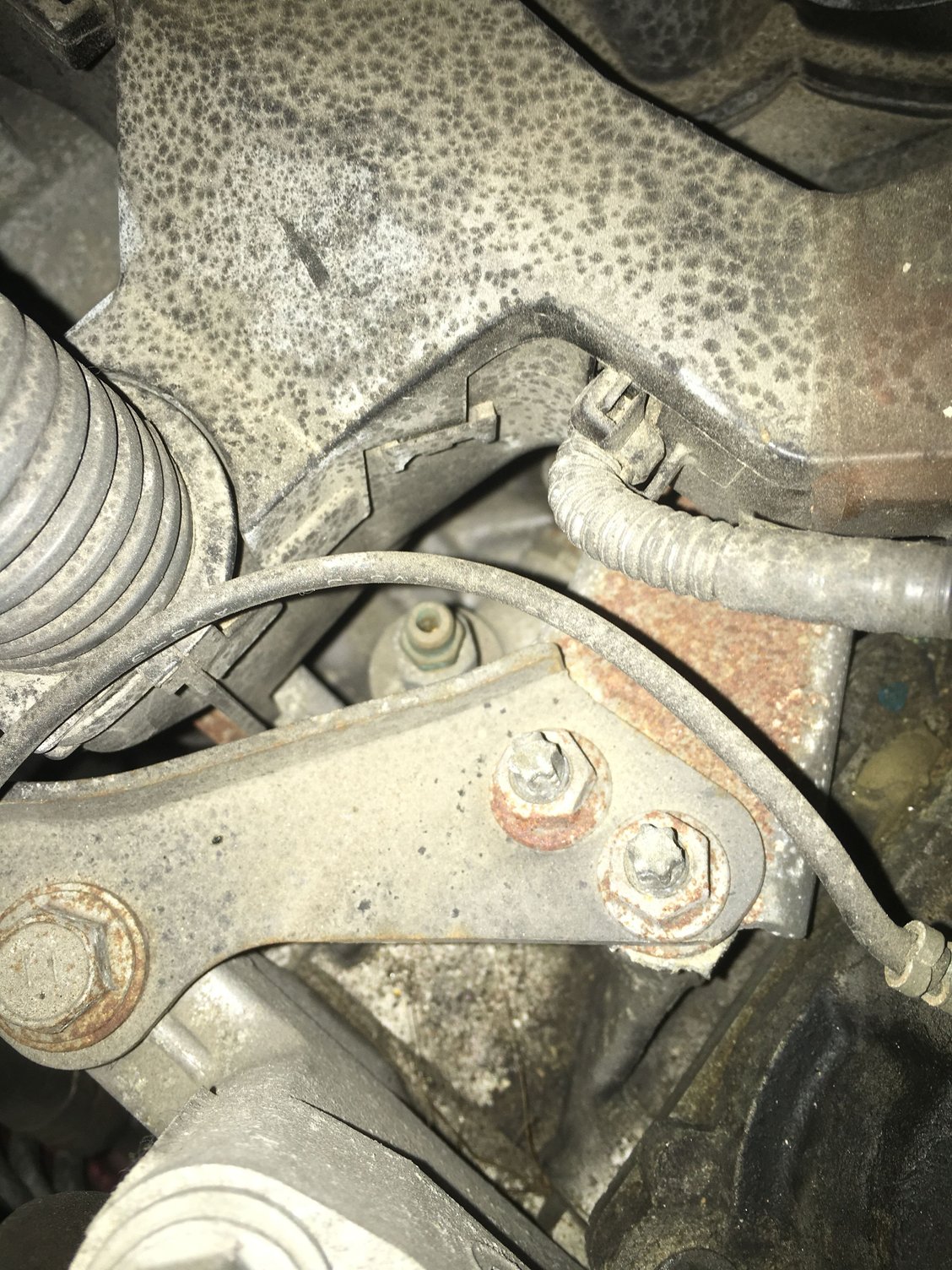

That rad is done, replace it as soon as you can before the seam blows completely. The way to properly bleed air out of one of these cars is STUPID easy and doesn't require any special tools at all. There is a air vent port under the engine cover near the front of the engine in the valley, open it and run the engine and all air will be removed.
Takes less than 5 min to do, heck I'll go out and take a picture for you right now....
10mm deep well, use a 6-8 inch extension to make it as easy as possible

It will explode on you. 100% since it can't reseal the crimp seam.
Yes, you will still have air in it since the cap is BELOW the top 1/4 of the engine coolant loop, not purging the air may have contributed to higher than usual operating pressures and hotspots.

I hope your radiator is not leaked. Maybe the coolant residue seen outside of the radiator on the pictures was the result of coolant spilling when running the car with radiator cap off.
