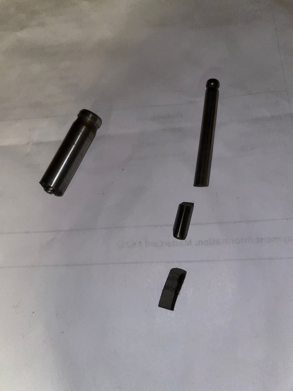

Default The broken bits
Lexus has retained the bottom of the valve for further study but returned bits of the stem and guide today. I do not know what to make of it. The stem is in order top to bottom and clearly bent in that it no longer moves through the guide. There was no obvious impact with the piston and Lexus nor the machinist suggested otherwise. The lowest bit of the stem is covered in carbon soot and the fracture line between it and the next piece up seems to be on that line. It is also sheared along the stem there not just across. FWIW
I guess these things do a freaking ton of work, but what a PIA when they go wrong......
Valve guide and stem. Stem is lined up in order
