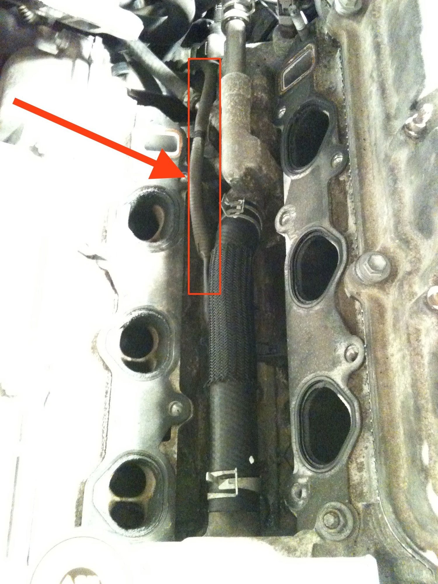

The more likely cause is not the sensor itself but the wiring harness that connects both sensors to main engine harness. The harness is a $20 part. Each sensor is about $100.

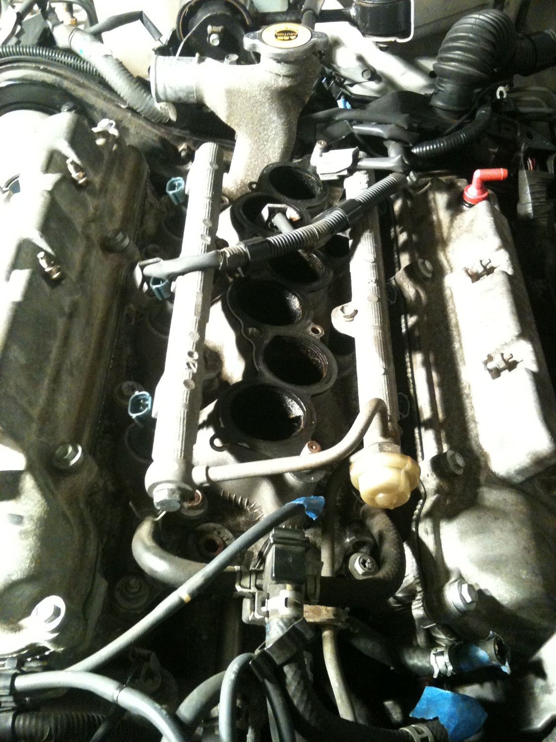

The biggest issue is where these parts are. You need to dismantle the intake system and drain the coolant to get to the harness and knock sensors.

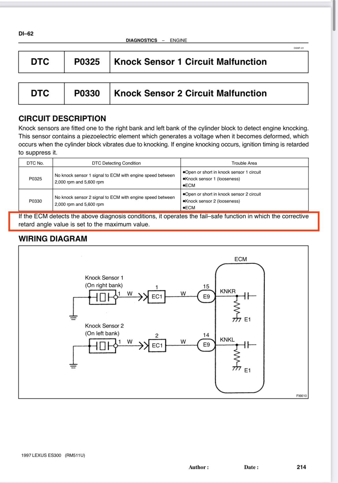

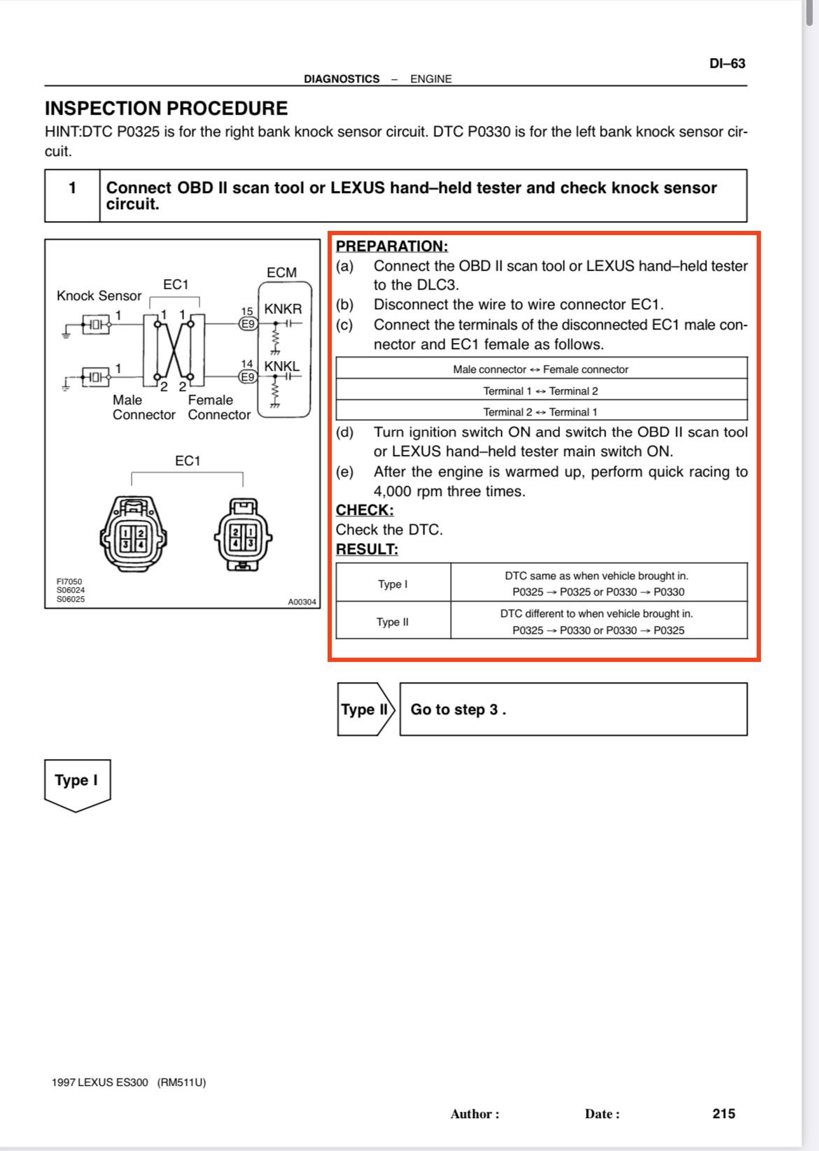

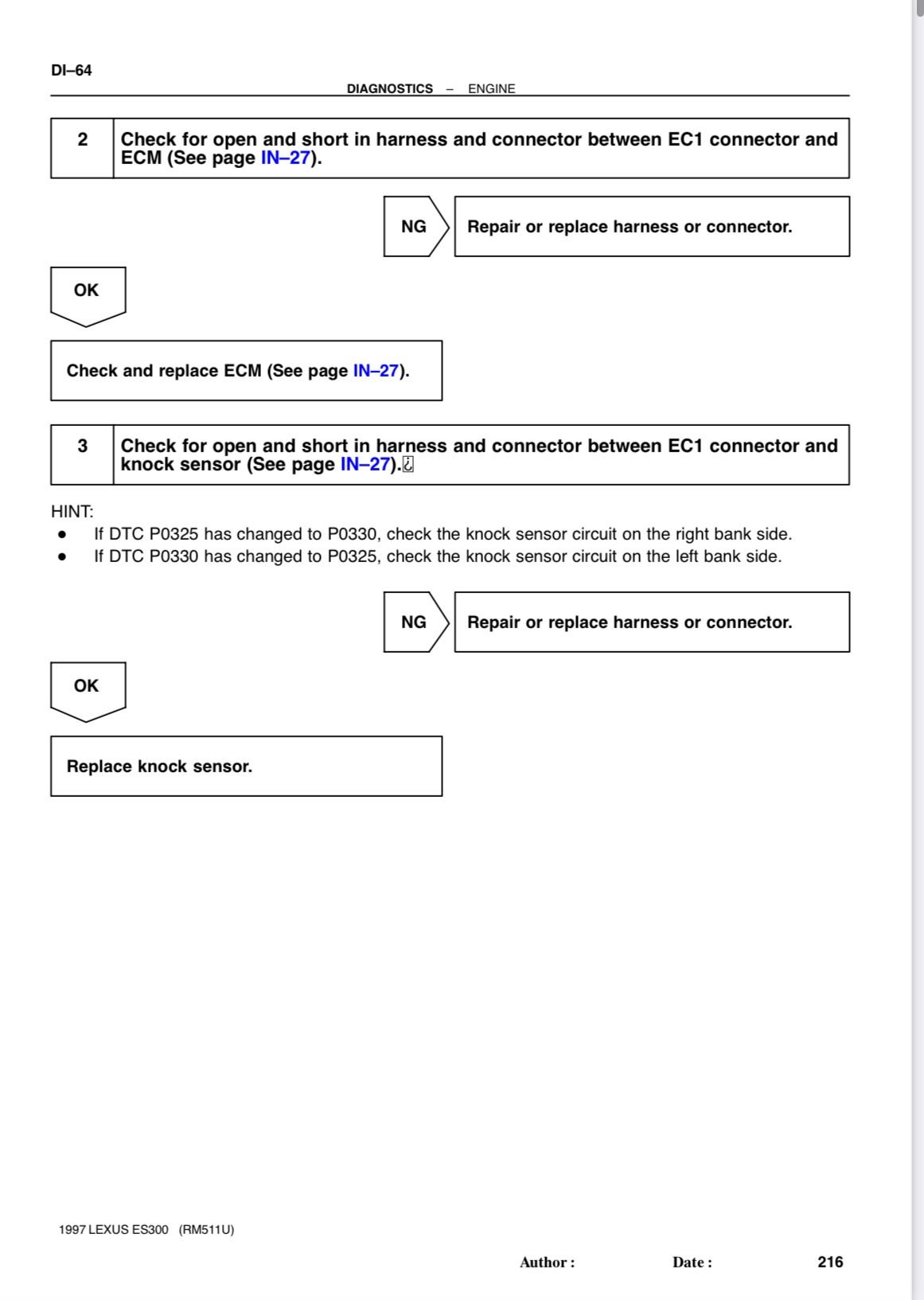

This is the official service manual for fixing this code.
Here is some photos of how far you need to get to fix this code.
