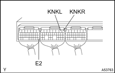

Did you check the wiring to the ECU? It is pretty simple, there is only one wire leaving each sensor, below is the diagram of ECU pins you need to check. Two other contacts in a wiring are for shielding.
Where did you buy your sensors and wiring? Denso does not sell them under their brand, the only place to get Denso OEM sensors is at Toyota dealership, any other one sold under Denso name is probably a counterfeit. If you got your sensors from a refutable place and the everything else checked good, return them and ask for a replacement, there are times when even Toyota OEM parts are defective from the factory. Bypass trick shown above should only be used as a method of last resort, since it drastically limits the ability of the ECU to adjust for knock. You can actually try using that trick to see if it is the ECU at fault, but again, only after all the other options were exhausted.
Hope this helps and best of luck!
