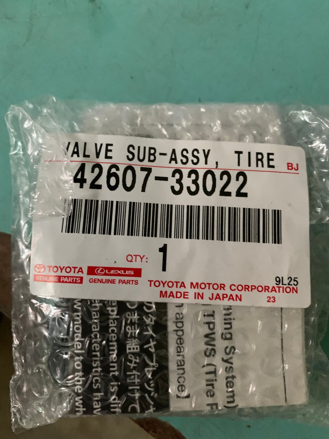

Is Denso made in Japan? OEM are japan made.
Your OE Toyota does not look like mine. Are you sure its original sensor that came with Es350?
I think there are slight variations for Toyota and Lexus.
Yeah Denso sensor says ‘Country of Origin: Japan’ on its box. From what I read on Pacific’s website, they appear to be the original equipment manufacturer for Lexus. I’m not 100% certain if my OE Toyota sensor is original for my car but from what I know, it should be. The previous owner only replaced two sensors and this was the 3rd one. I believe the replacements were all Autel.

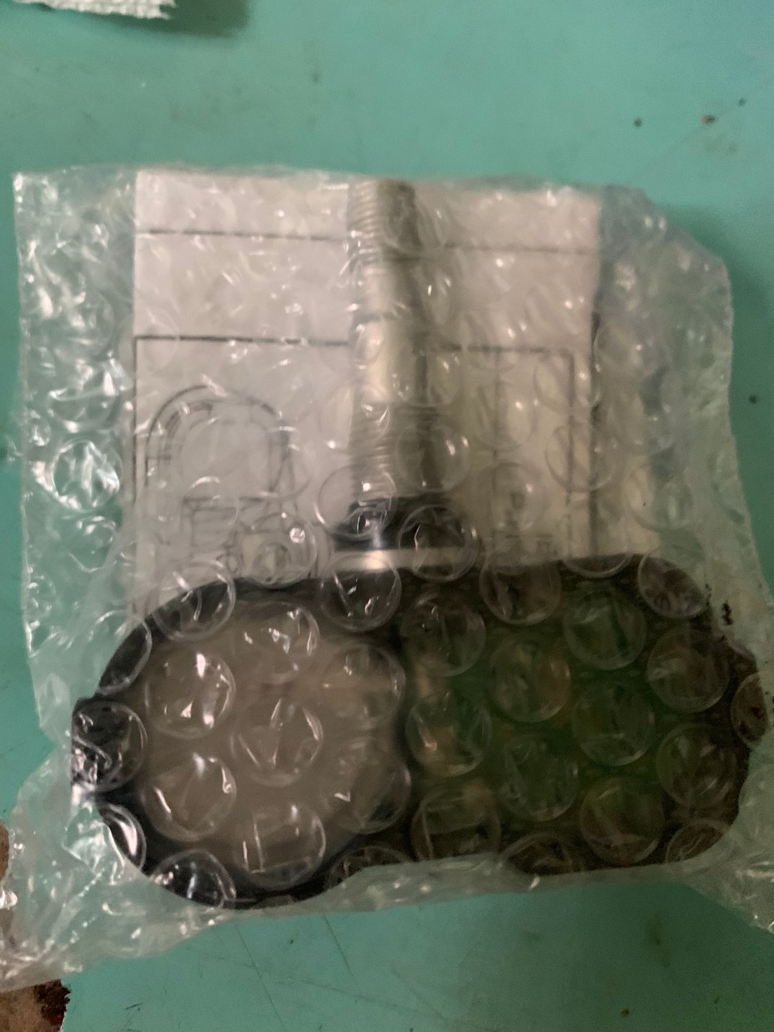

this is an official Lexus part for 2007-12 ES350.
as you can see, the battery part is see through.
Old Jul 16, 2020 | 05:43 AM
tolian21's Avatar
tolian21
Joined: Dec 2011
Posts: 996
Likes: 292
I should add that Lexus had revisions on this part, and part numbers changed in the past. This is the latest part per dealer and also online lexus dealer parts websites.
