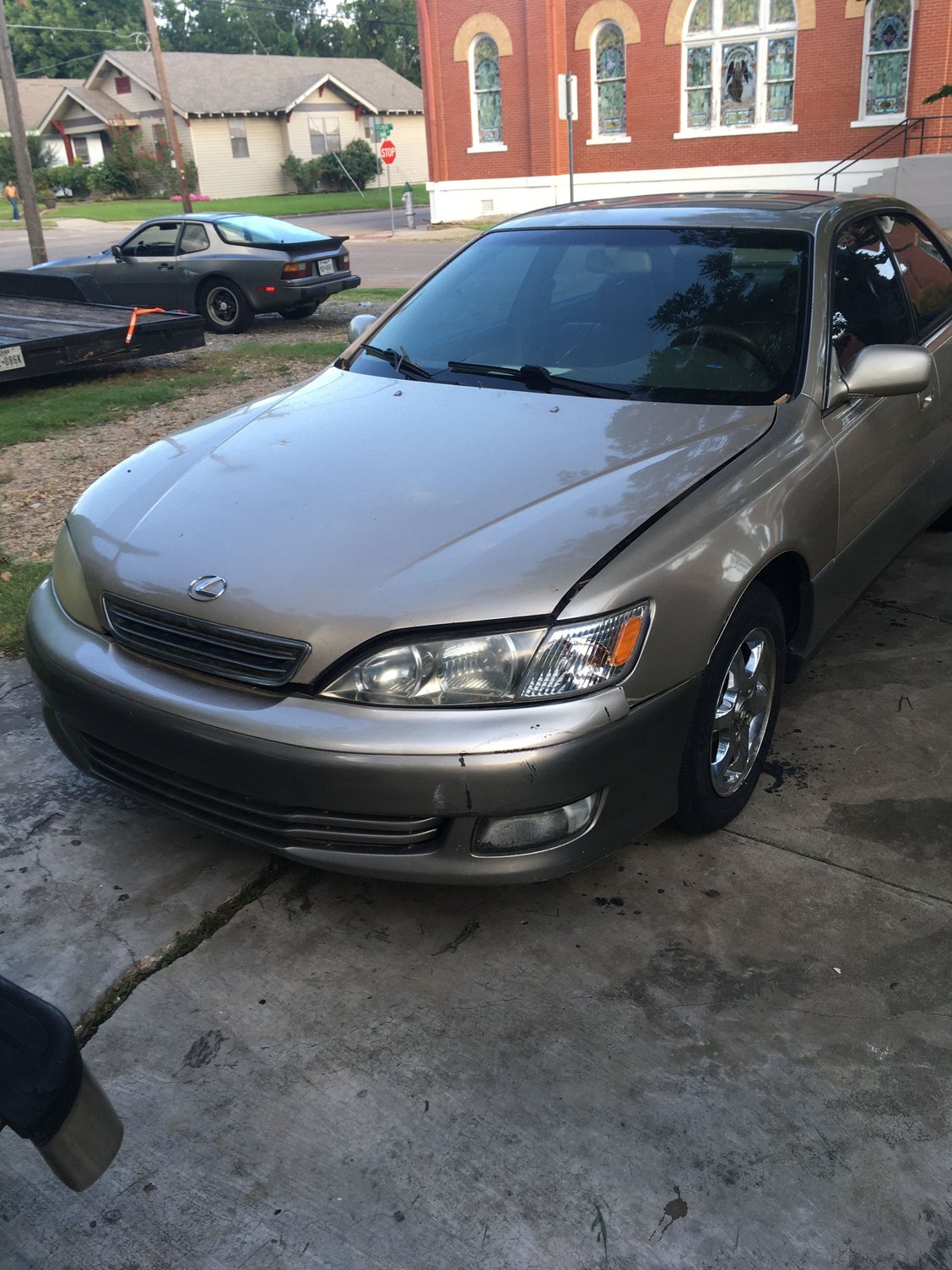

Picked up this 2000 es300 today. Mileage and problem unknown. Starter was off and alternator loose. Starter tested bad so got a working used one installed and tightened down alternator. Attempted to engine turned half a rotation then stopped. Motor is locked on something. Assuming the worst most likely will get a junkyard engine as i already found 2 near me. Is this 3.0 v6 in any other cars (Toyota’s)? What other cars can I pull from? Is there something common with these motors locking up? Has 172k

Pull the timing belt cover and make sure the belt is not bound up. It is unusual for the 1MZ to lock up even when totally neglected and filled with sludge. For a potential donor you need a 1MZ VVTi version wikipedia has a decent list
