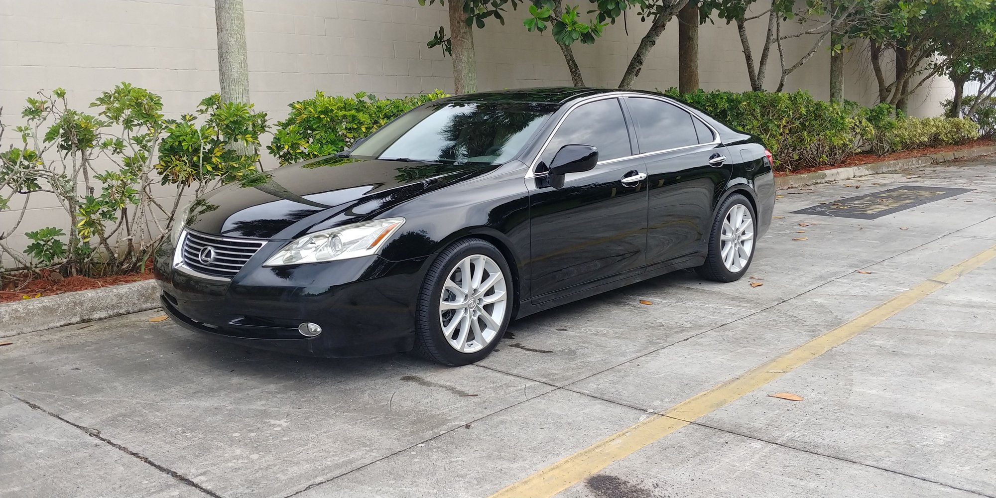

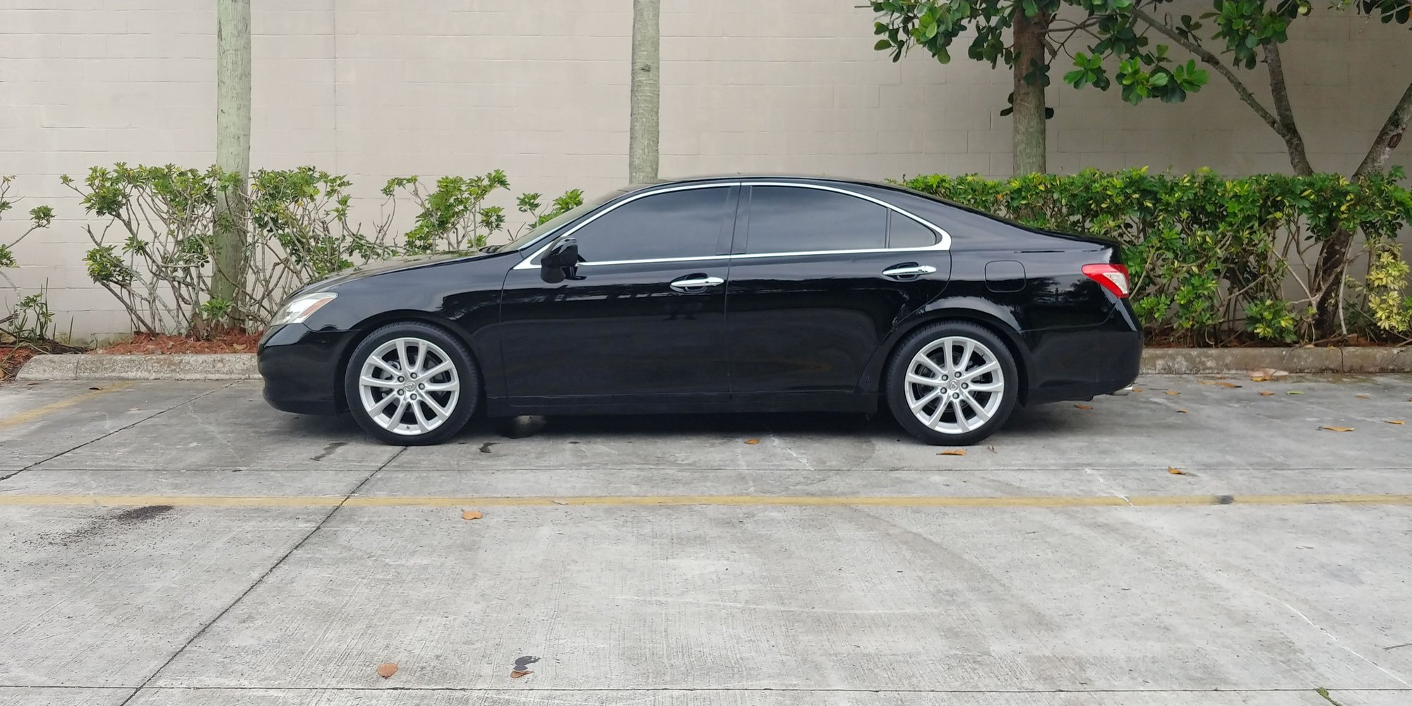

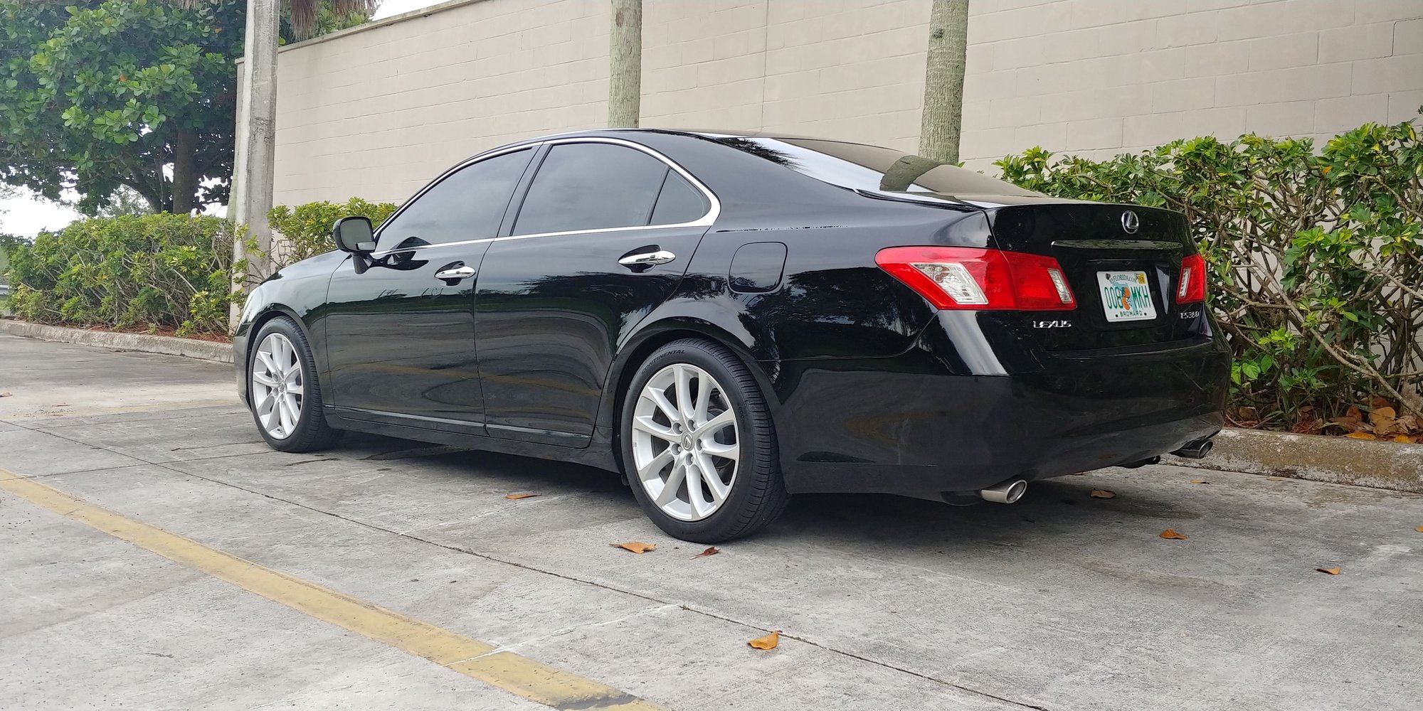

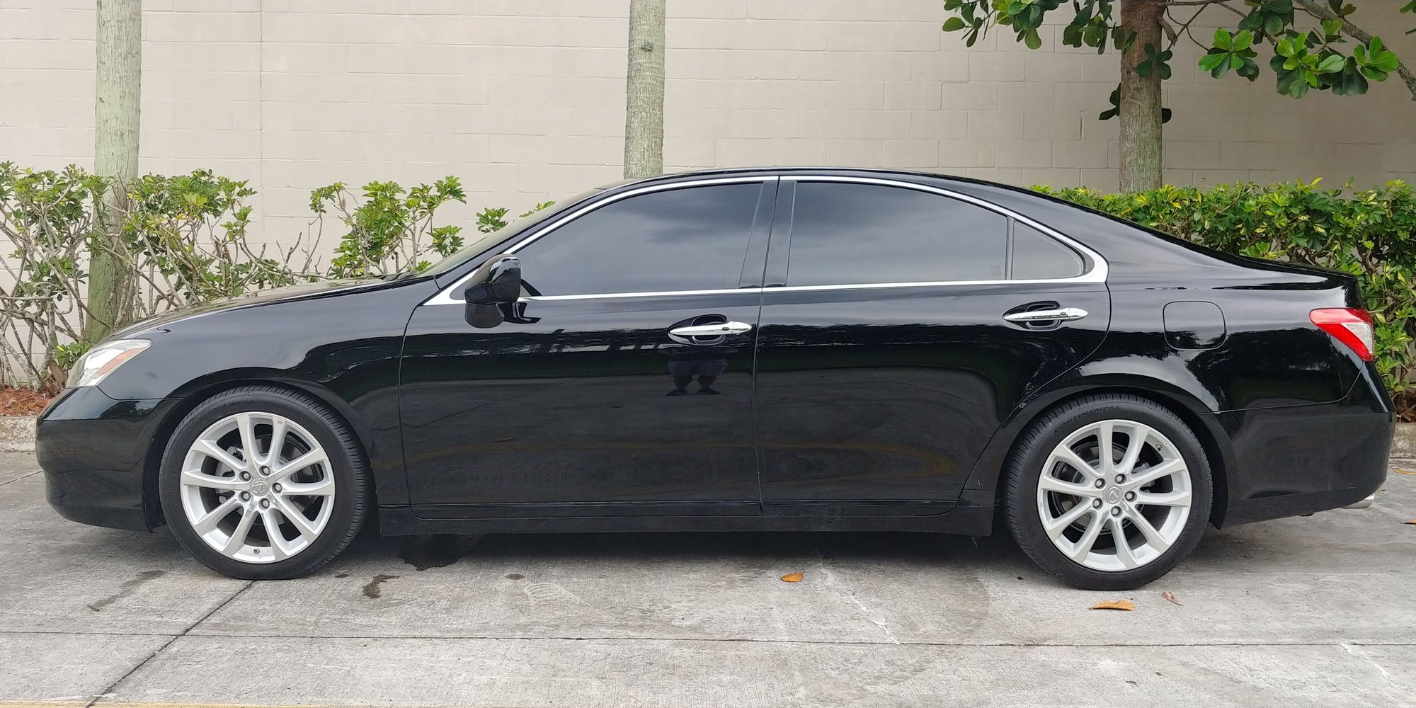

Did some mods to my daily 'beater'. Overall, I'm happy with the results.
With the Eibach springs, gone are the nose diving when braking, and that 'boaty' feel when taking hard turns. Braking is very much improved and the car almost turns a good as my IS350. I purchased new tires (Continental PureContact ls 225/45r18) which also add a level of 'sportiness' handling that I've been wanting out of a larger automobile. Now granted, the car no longer rides like a traditional ES and I will miss it for obvious reasons.
However, I do welcome the more exact handling and updated feel that my car now has. Virtually zero body roll and I can now yield onto highway ramps with ease. The added looks are also a bonus to me. I think the Eibach springs add just the right amount of drop. I also added wheel spacers that really do enhance cornering and of course the stance.
The wheels do not rub unless there is a lot of weight in the back and I corner hard. Other than that, it's good enough for me, for now. I plan on driving this car for as long as I can, so I can save some money in the bank!

Thanks man! The goal of the mods was to update the car without giving up the stock look. The 2007 model was starting to look a little dated with the stock wheels.
I previously installed KYB struts (highly recommend). The KYB and Eibach combination is great! Now that the springs have settled in, the ride quality is almost perfect. It kinda feels like an ES and a GS put together.
