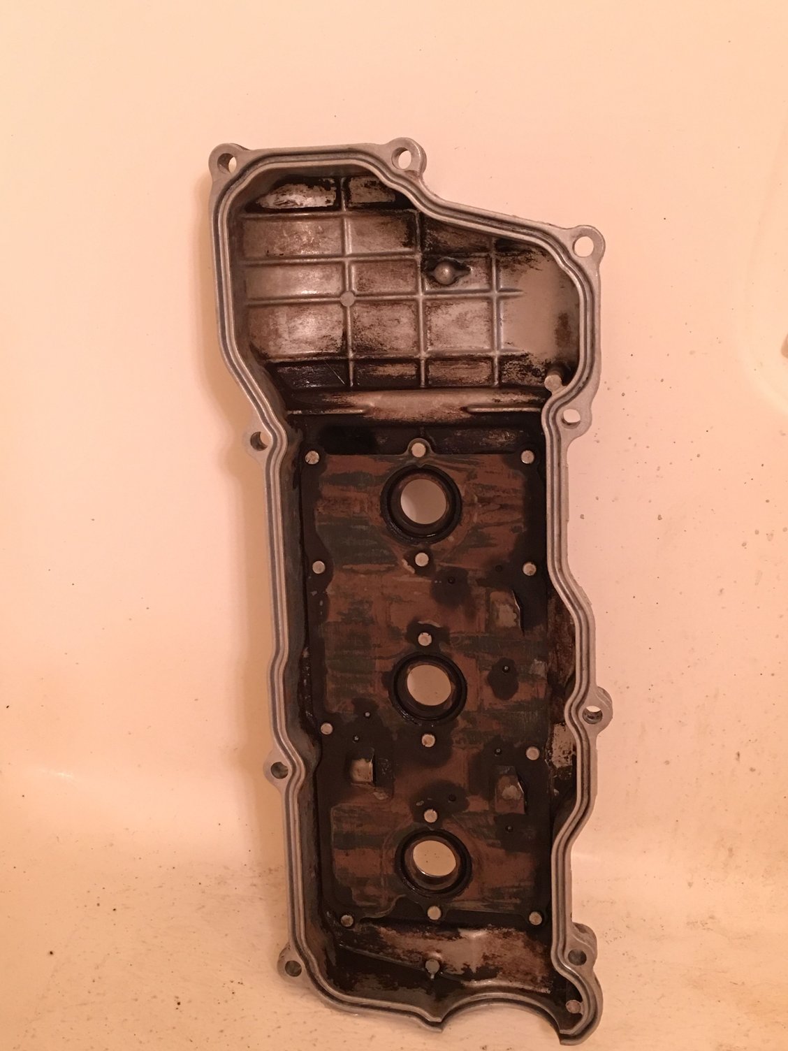

This is an AFTER cleaning pic, wish I took a pic before, you couldn't see silver. It was black inside out.
