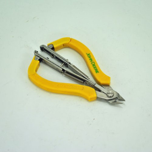

I highly recommend this wire stripper for the job. It makes it a breeze.
http://www.greenfunstore.com/John-De...25_a_7cTY26534
