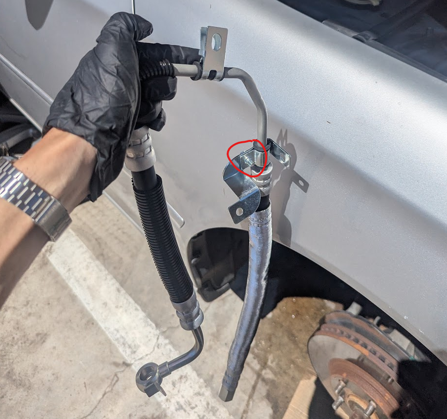

This is a picture of the hose; The upper bracket my finger is pointing towards might be possible to get off without removing the upper intake plenum. My hands are pretty small but I couldn't get to the nut with a flex head ratcheting wrench. I didn't even try to get to the second bracket without taking off the intake plenum. Looking at it again, you may or may not be able to access the bracket from under the car but I didn't try this. If you do pull the intake, there is way more room for the rest of the job. The lower bracket is two pieces; I ended up leaving the original bracket in, and only removing the small bit that actually clamps on the hose (circled in red).

If the flare nut is stuck and you round it off like an idiot (me) you will need to replace the hardline from the hose to the rack as well. This piece is pretty cheap on rock auto. Here is how the FSM wants you to do it.
If you needed to read through this then good luck, be patient and it should be a simple job. The factory service manual can be found on charm.li, I don't even remember how I found the Hayne's manual but it didn't really help much for this.
