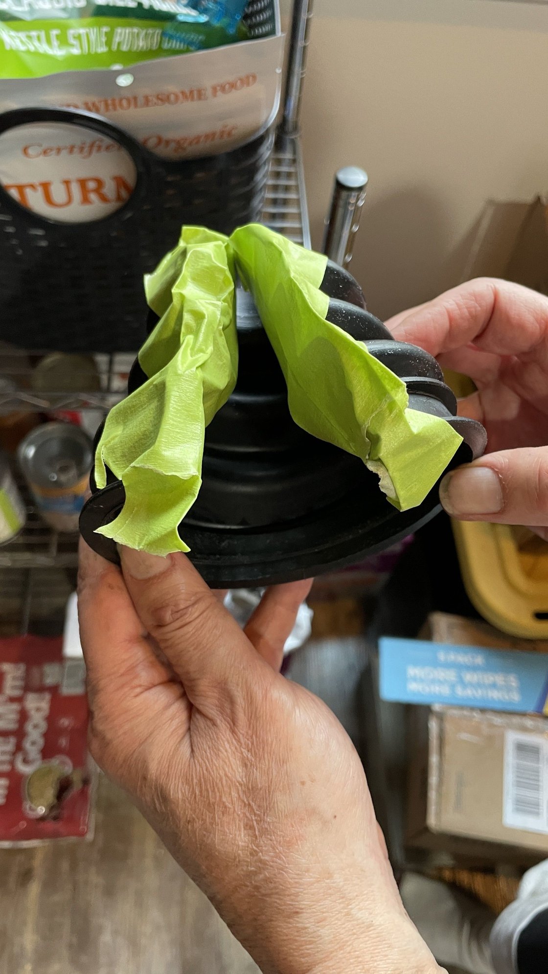

The Good: Boot is made of nice thick rubber and appears to be durable. The tongue-and-groove design of the split boot joint is much more robust than the usual $20 universal boot and when joint is pushed together, it will hold together on its own so it is not necessary to hold the joint together with fingers until the glue dries (assuming the clamp groove on the axle is 25mm in diameter or less). However, I used a zip-tie in the middle of the boot to loosely hold the boot together until it dried (see photo). The amount of the included glue (Loctite Super Attak Power Flex Gel, 3 grams) is more than enough to do the job. It is a rubberized formula equivalent to the Loctite Super Glue Ultra Gel Control sold in the USA and is made for joining flexible materials like rubber. The glue takes a long time to dry; still tacky 2 hours after application even though the label says it will dry to touch in 30 seconds.

(1) Wipe axle surface very thoroughly with cloth and alcohol prior to pushing boot over axle. Apply masking tape to cover split joint on boot (see photo) to protect boot joint from contamination. Remove tape just prior to using glue.
