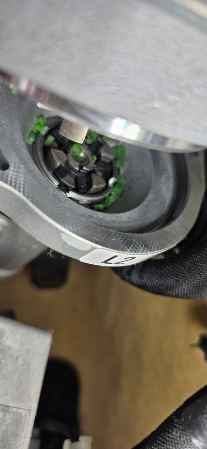

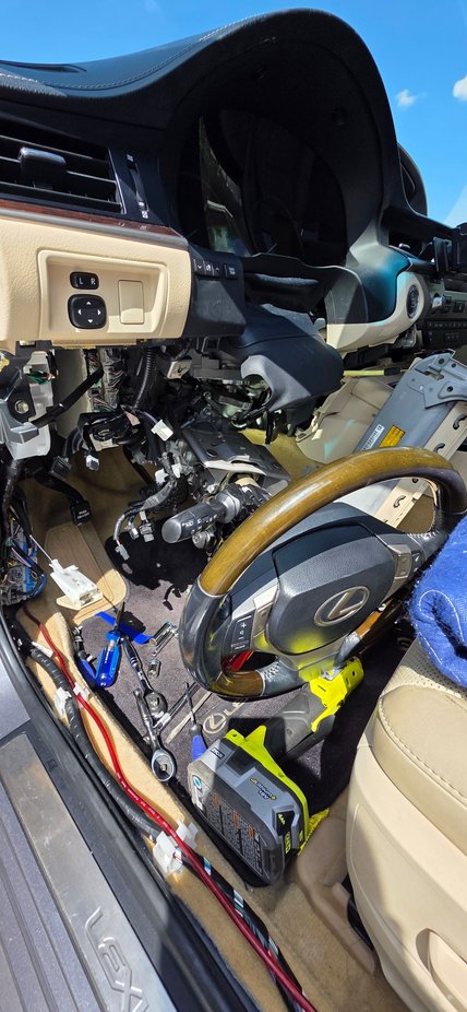

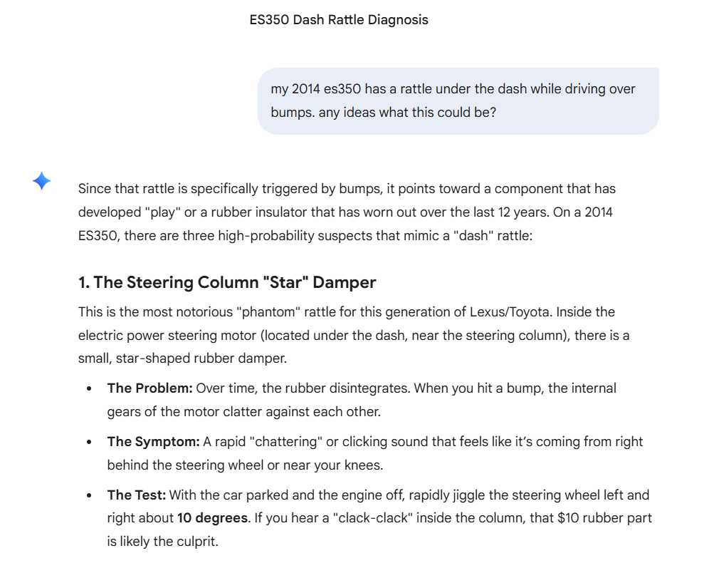

Thanks to Google Gemini, it pointed me to the culprit. It was the steering wheel column damper. It even gave me the part number needed. Since the damper is used in many Lexus and Toyota vehicles, I called both my local Lexus dealer and Toyota dealer for pricing. Lexus quoted me $19 while Toyota quoted me $7. Picked up the part and found several videos on YouTube with detailed instructions. Is an ugly job but pretty straightforward. To be honest, the hardest part was taking off the A/C foot vent. Here are some photos.
