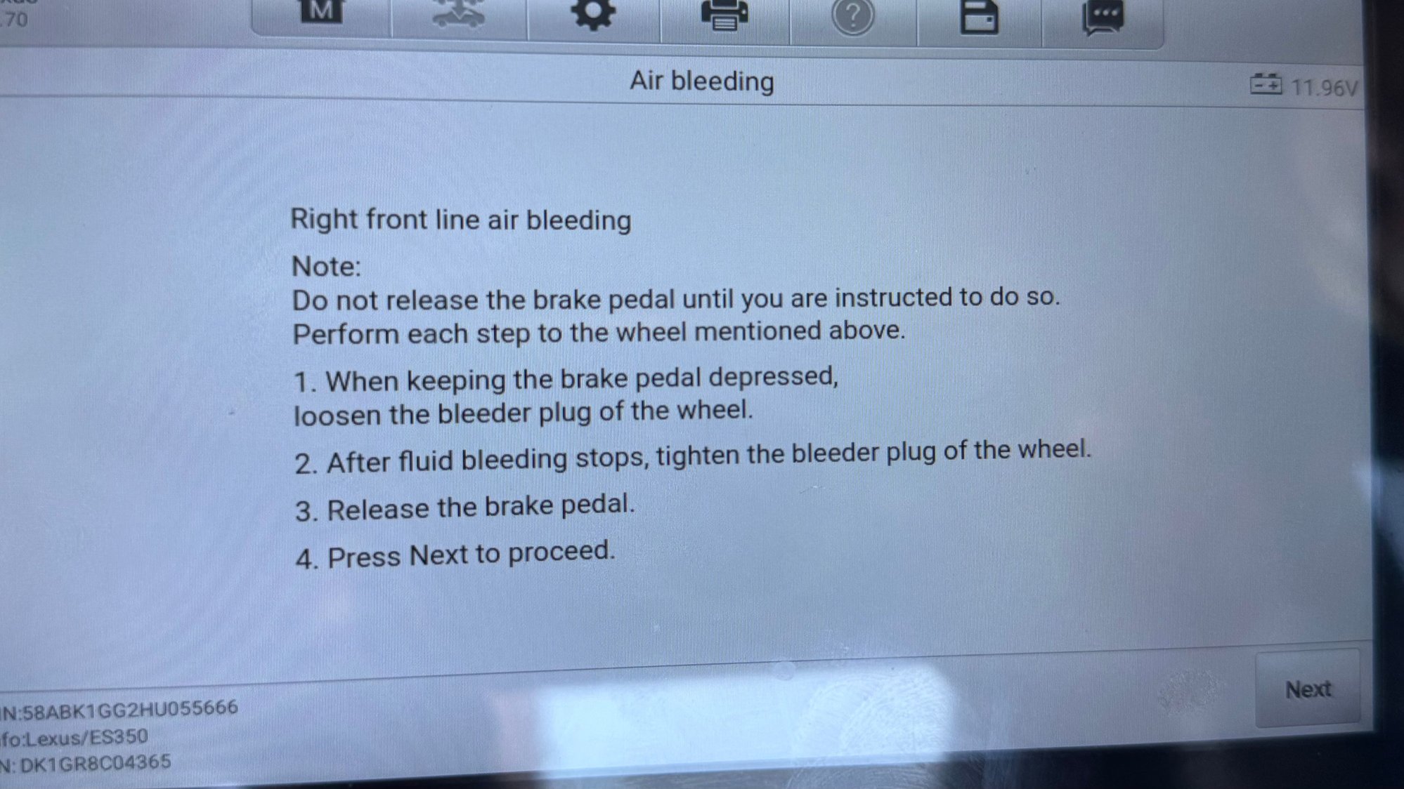

Borrowed Autel scanner from neighbor, scanned for codes nothing come up . Decided to bleed using scanner and after test it’s saying front right line air bleeding , proceed bleed and still same so repeat two more time with no luck . Don’t want to take to steallership but maybe have no choice

Did you try to break hard several times, just to activate the ABS pump?
