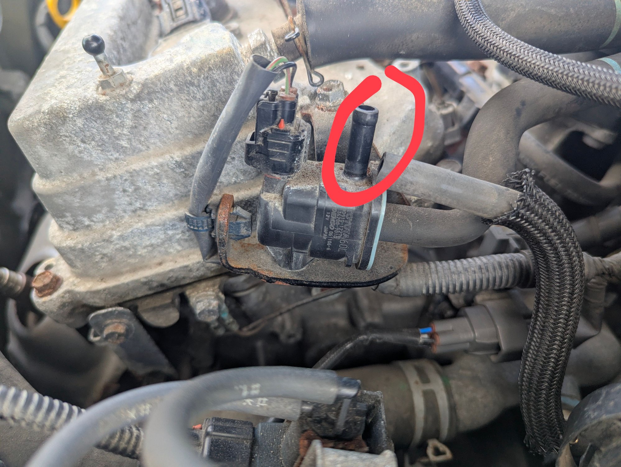

Hello everyone! Here's the story. Around 2 months ago replaced the fuel tank from a local shop. Immediately after replacing the tank I couldn't refuel the car properly, it was clicking every 5-6 seconds. Later, after 1 week the car started stalling at red light and idle. Went to another local shop, they replaced the charcoal canister as they said the canister was full with fuel. Now I'm getting P0441 code. Yesterday I was checking the engine bay and found one of the hose from vent purge solenoid was disconnected. So I reconnected and car was stalling again. Today I checked if the purge valve is okay or not, tried blowing air and it was closed. I saw liquid fuel inside the hose and valve. I'm totally frustrated now. Spent a lot of money already. Anyone with similar issue or could share some insight?
Liquid inside the hose
This hose from the purge valve solenoid was disconnected

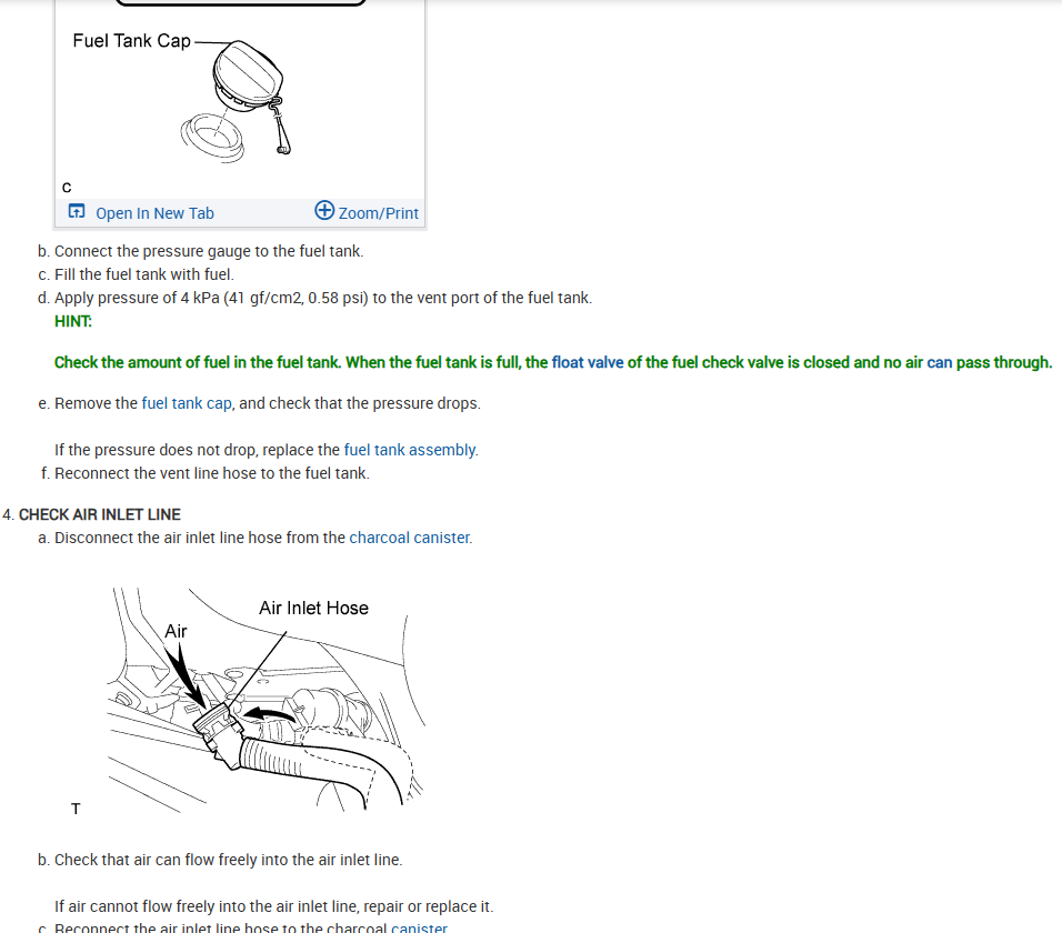

Your symptoms indicate there may be issues with the roll-over valve/cut-off valve and fuel tank. I have attached these testing procedures for the problem areas.
The roll-over valve/cut-off valve may have already been defective or they may have been damaged during the new fuel tank installation, and it's allowing free flow out of the tank and not into it!
Best of luck!

I checked the vent valve solenoid today. I unplugged the hose and kept car running about 10 mins. After 10 mins I put my hand on the vent from the picture. It felt like sucking air non stop. The marked vent goes to the canister tube. Is this normal?
Old Apr 26, 2025 | 11:28 AM
ESh's Avatar
ESh
Joined: Jun 2014
Posts: 5,025
Likes: 1,630
From: MI
Yes, it should be connected like that.

The diagram is very general and it's not exactly to scale. The location of the roll-over/cut-off A.K.A. vent valve might be outside near the fuel tank.
I have attached testing procedures for the VSV. Again, your issues are in the areas that I have mentioned in the earlier post.
Best of luck!
