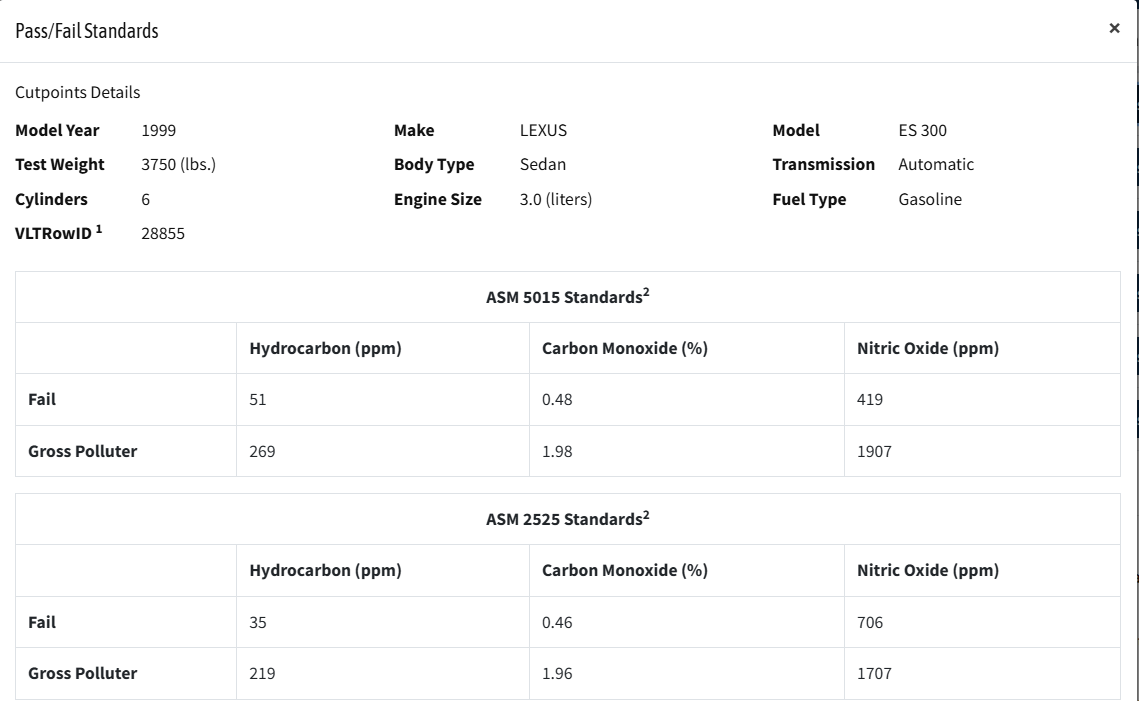

Old Apr 10, 2025 | 02:04 PM
tammap's Avatar
tammap
Joined: May 2007
Posts: 811
Likes: 361
This is your vehicle Pass/Fail standards, so your HC reading at 15mph = 71ppm and 25mph = 55ppm. I still need CO, NOx, O2 and CO2 reading.
