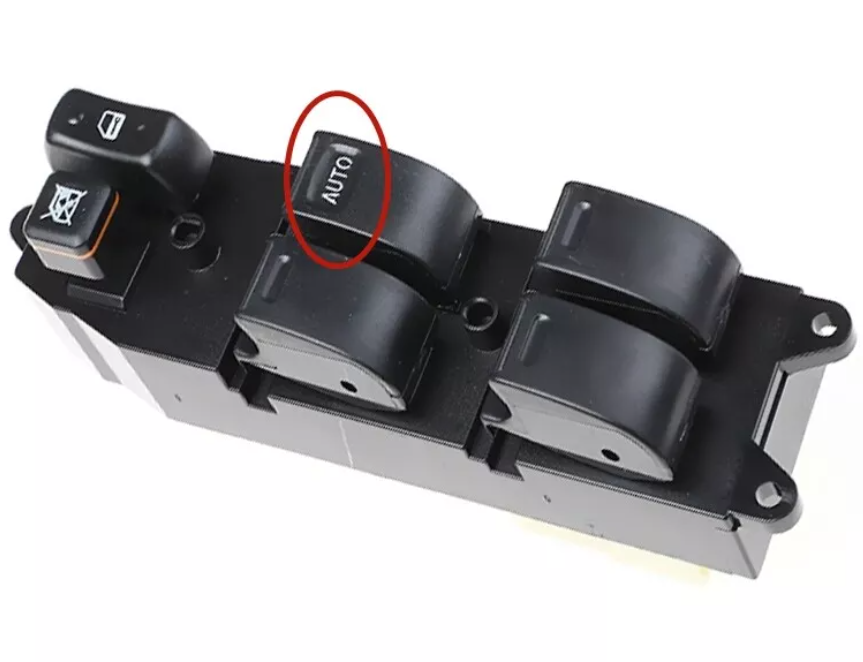

China are selling these for the other toyota models, they look identical as far as I can tell https://www.ebay.com/itm/153912871488
I've tried one from a MCV camry but it didnt fit
Do you think the part from the eBay link will work on my ES?

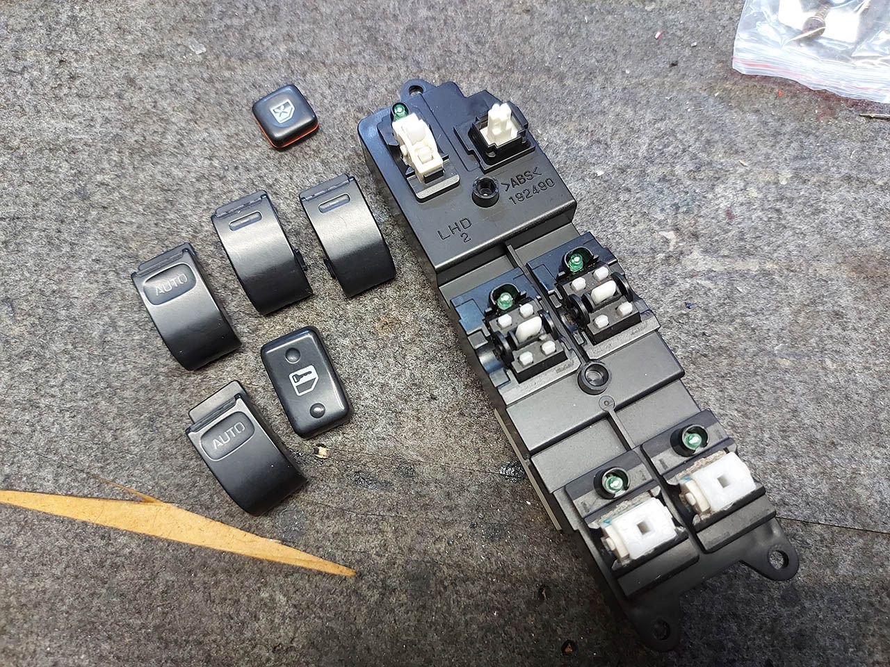

My broken one dissembled :
One off eBay from China^

That Ebay part looks correct. Parts cross reference only shows Windom and RHD ES300. What happened to yours doesn't seem like there is much to go wrong. Here's a LHD switch partially dissembled maybe the LHD version can be used for parts to fix yours.
