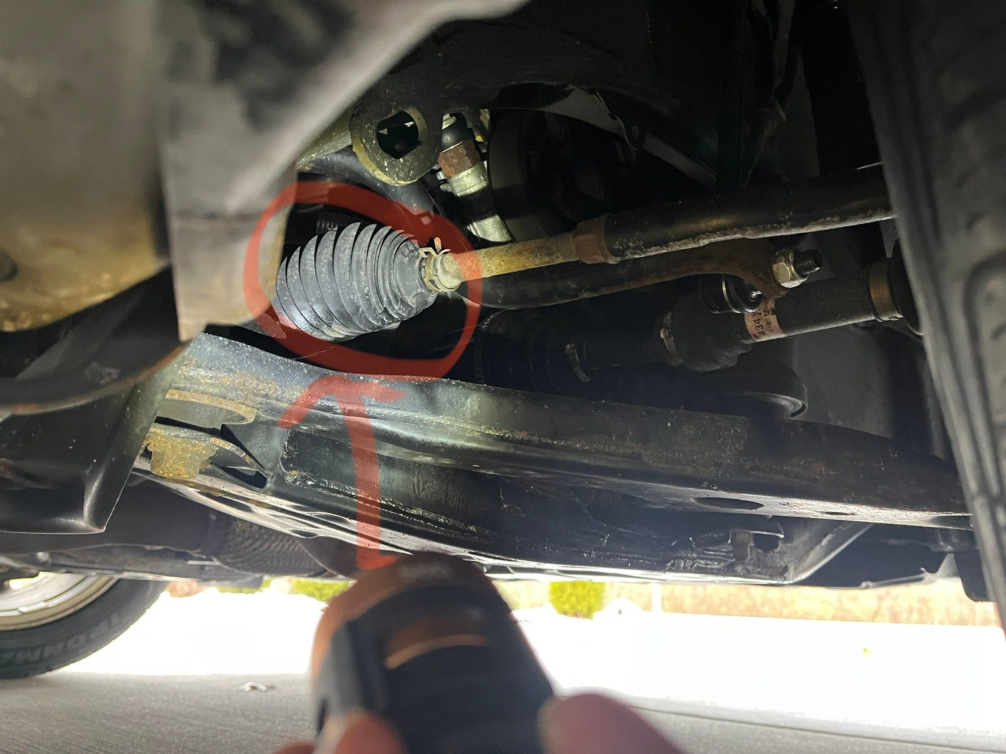

so I should be good also it seems like my cv joint is leaking

That looks like a steering rack boot. I can see the drive axle behind it in the photo. Check and monitor your power steering fluid level. The rack may be leaking. Inspect the boot clamps to see if any are loose.
Find a great local independent Toyota or Japanese vehicles repair shop. Do not go to the dealer with a 15 year old Lexus. You are asking to have your wallet emptied with recommended repairs that are not needed and overcharged for what is needed but they will not differentiate between them as the service writers work on commission. Use Google and Yelp and ask friends to start your search if you do not already have a shop you like. You need to get this vehicle inspected if it has not already had a pre-purchase inspection, which it appears it has not received. How many miles are on it? Has the transmission fluid ever been changed? That is a weak spot as these get older.
