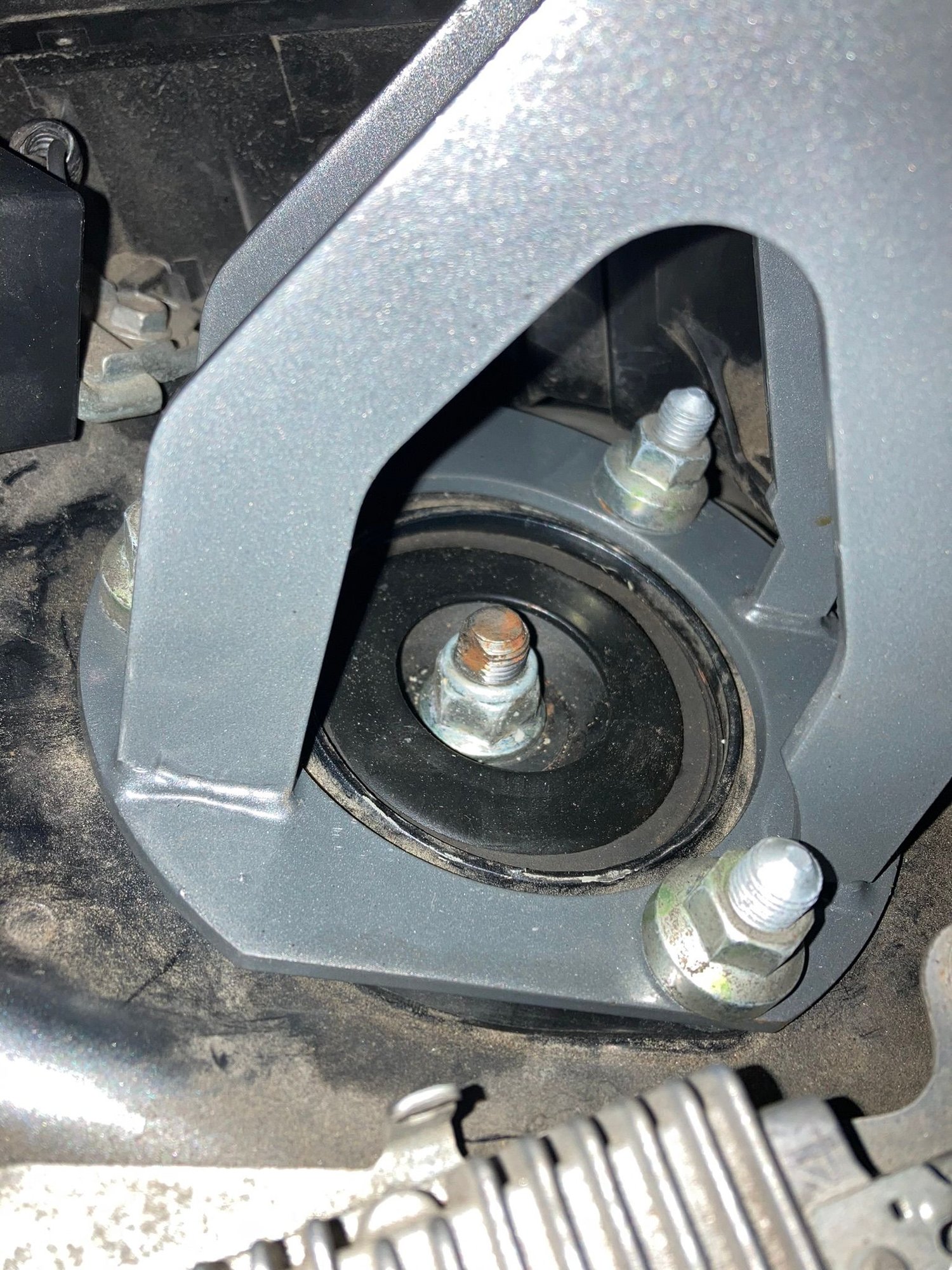

It is not tightened. There is a flat milled into the end of the shock thread typically. You grasp that and hold it while torqueing. Does your shock have that milled flat in the end?
ETA: Below is a pic of a front strut in a GS. If you blow it up/look carefully, you can see the flat area milled into the end (there’s a blob of rust on it) of the threaded end. Sometimes the weight of the car will allow you to get the nut tight without holding it, but not always. You grasp that with another wrench while tightening the nut.
