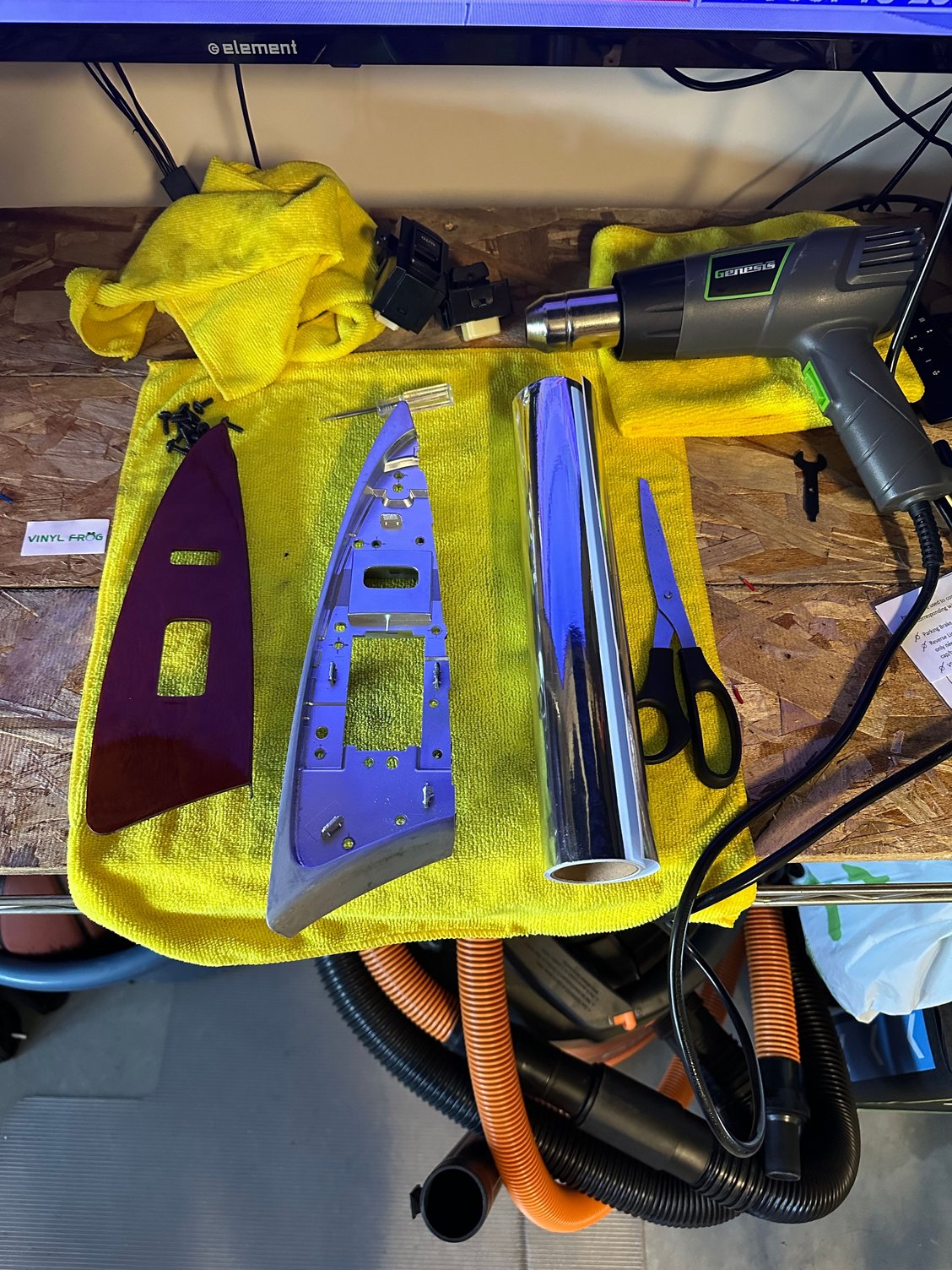

I just purchased a second ES 350, a 2011. The other is a 2008. The 2011 should have had a chrome strip lining the window switch, but it was painted with silver spray paint. I think the original chrome finish was worn, so the owner tried to paint it. I looked around for some ideas… chrome pen, spray chrome, Ebay for replacement part. Decided to try a vinyl wrap, and I am very happy with the final look. Only time will tell how well the wrap will stay in position, but even if I have to reapply every year or two, both doors took about 30 minutes total. The chrome on the rear doors are perfect, so I left them alone.
Several brands are on Amazon, and the brand I used is called Vinyl Frog. I chose it because it had the fastest shipping to me.

You know, you can still buy the trim pieces new. I did for mine. You can sometimes find them on eBay. Easy swap out.
Here are the part #s from another post.
74236-33020 - Front driver side (mine)
74235-33020 - Front passenger side
74276-33030 - Rear driver side
74275-33030 - Rear passenger side
Associated thread link
https://www.clublexus.com/forums/es-...photo-diy.html

Appreciate the part numbers. I must be terrible with search terms because I spent about a half hour on the forums looking for this info.
I will search the part numbers tonight to see if I can find something relatively in case the wrap fails.
