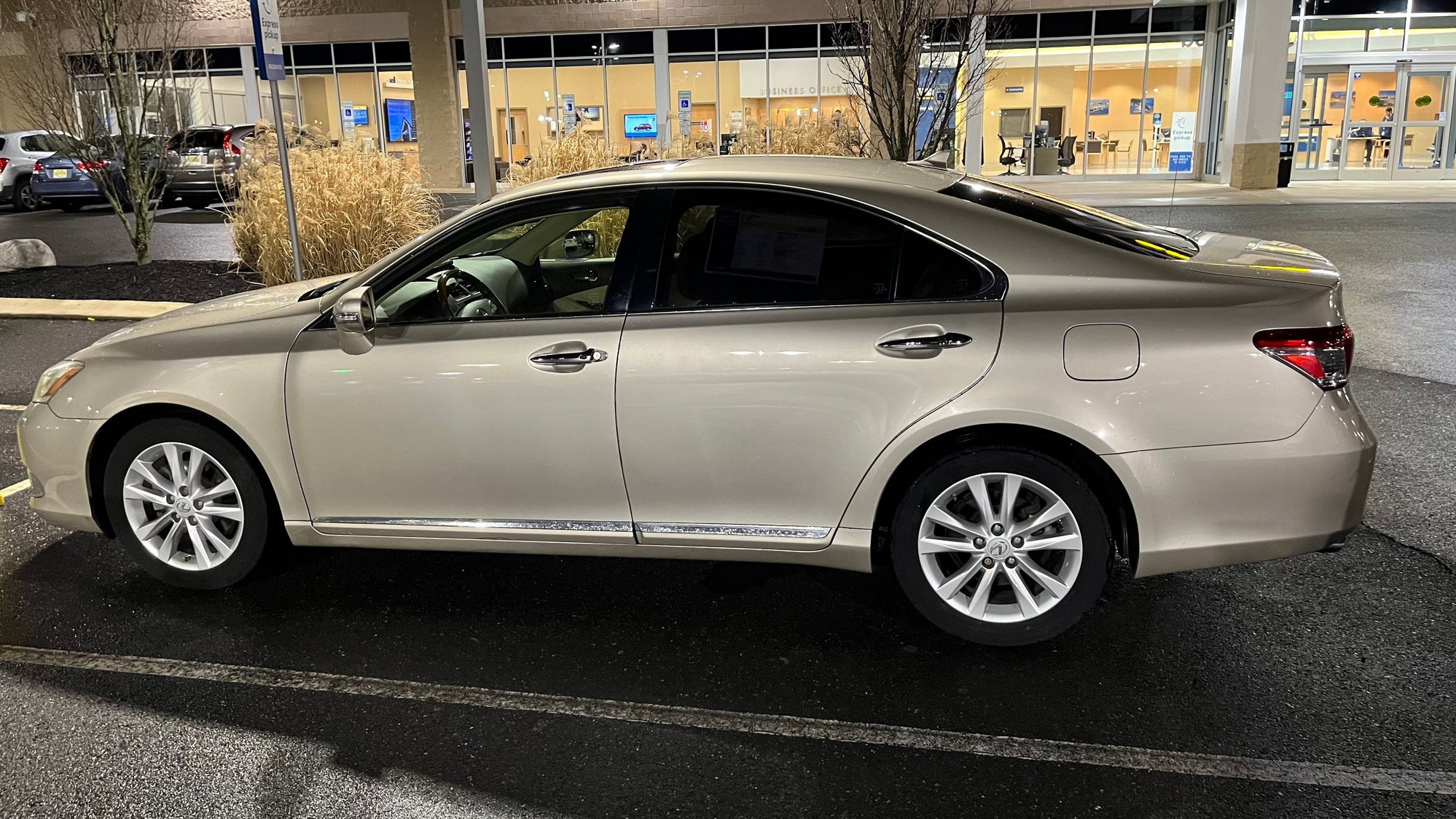

I’m probably going to buy this beautiful 2012 ES 350 107k miles for $14,500.
I love it but am a little concerned about the milage. For a Lexus is 100k miles a deal breaker?
