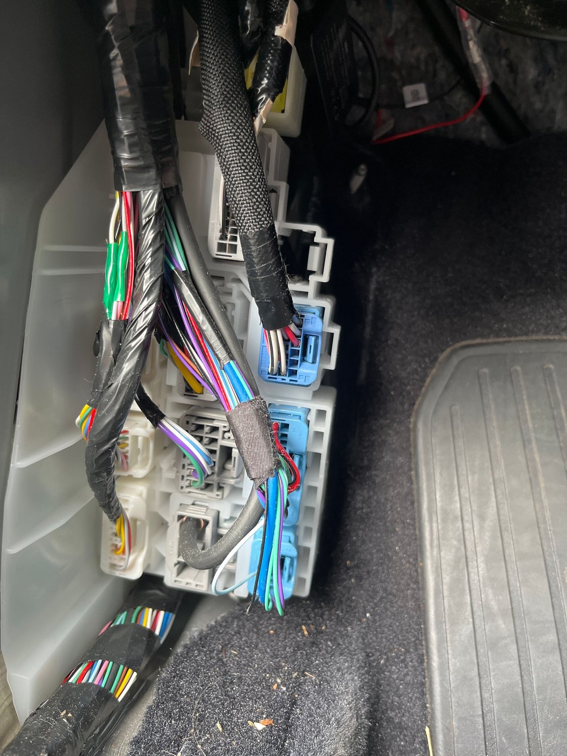

I’m trying to find a drivers side wire that goes 12v with the headlights on and 0v with the headlights off. Passenger side I was able to tap the window control but the driver side illuminates under different circumstances. Here’s a picture of the kick panel connectors, I’m curious if there’s schematics or if anyone knows.
I’m installing Lexusacc.com advanced mirror turn signals that have a DRL and it needs to tap into something that’s in sync with the headlights. On passenger side the window switch works but it’s different on the driver side.

the signal I’m looking for is essentially the headlight/DRL signal. I suppose I can tap any interior button that backlights when the lights go on. My wire comes from the side mirror, into the door, as these are upgraded mirror cap turn signals. The passenger side window-switch/unlock is illuminated with the headlights, but the driver side is illuminated if the car is on, period. So I think I need to bring that wire thru that door grommet and find a tap in the cabin.
