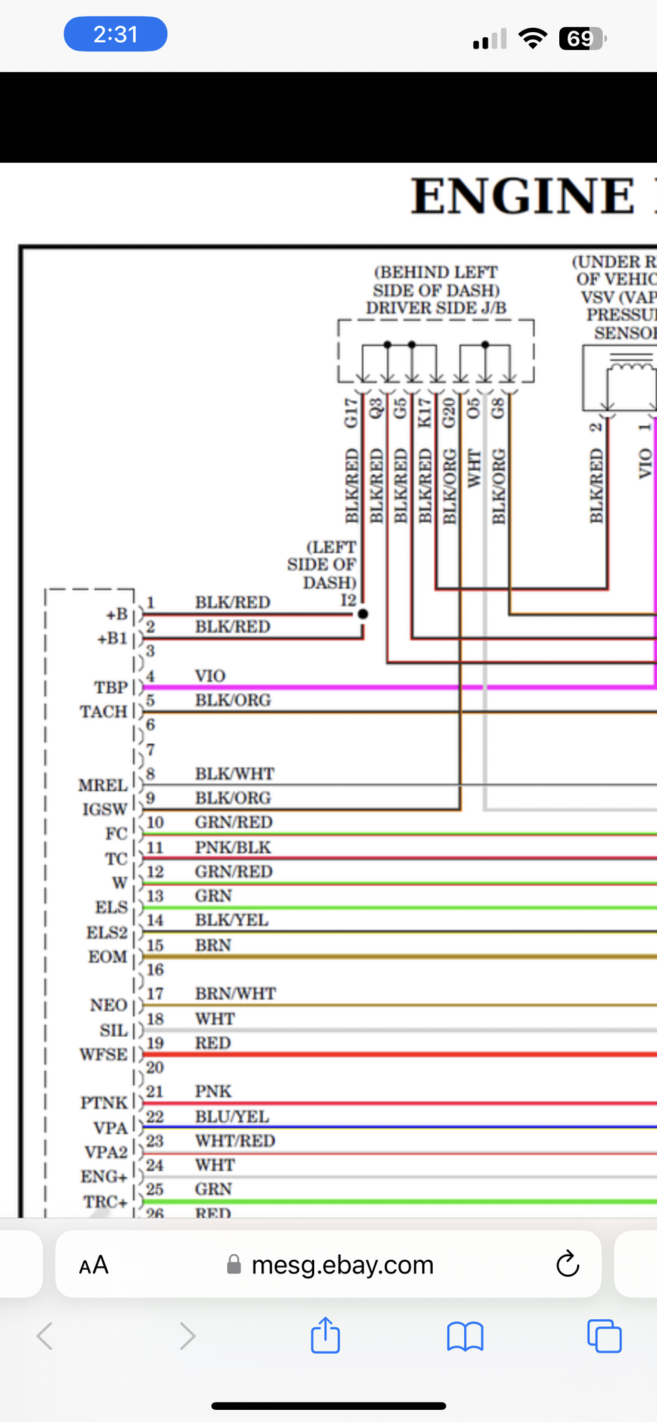

I pulled all the sensors one at a time. Still the same. No check light on dash. Next check ecm getting power or not. Which pin and the color of wire should I check? Thx for any info.

Thx I bought a page show the wire diagram to the ecm from eBay for couple bucks.
Old Jan 11, 2024 | 01:38 PM
Bolo123's Avatar
Bolo123
Joined: Jul 2023
Posts: 51
From: Az
+B and +B1 got 0 volt. So what’s next?
