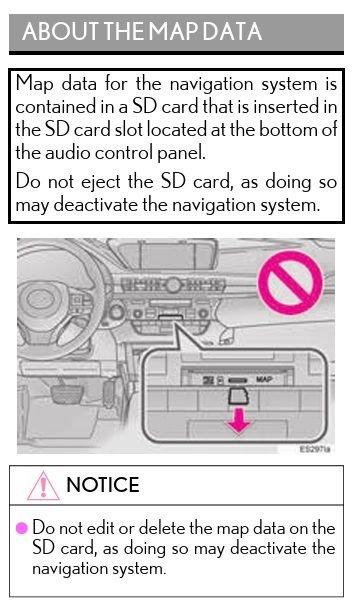

Have you read the owners manual for the Nav system on the proper way to install the SD card. You can't just take it out and put it in. "doing so may deactivate the system."
The owners manual sets out the procedure for installing the map data.
