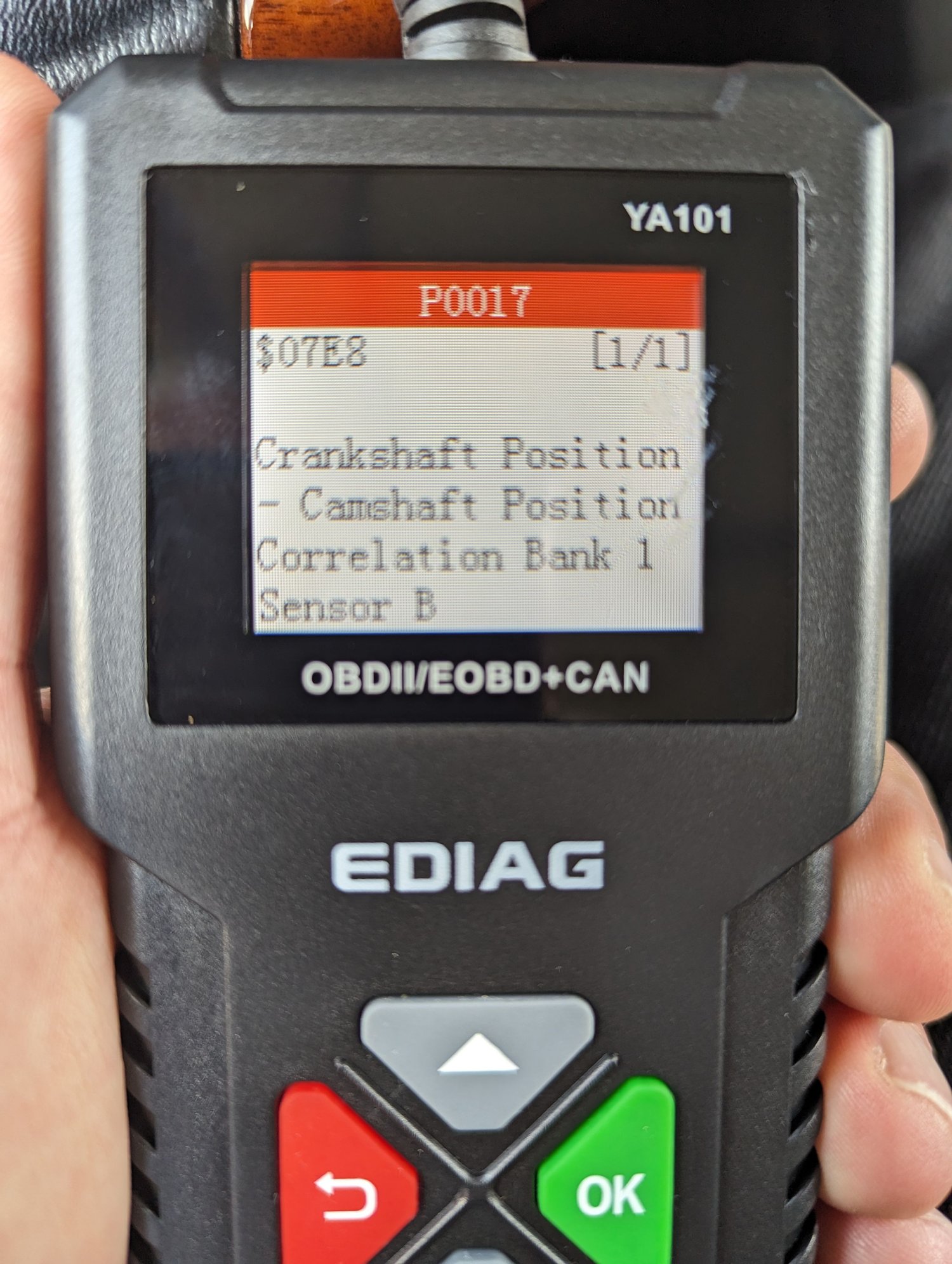

I have a question about error code P0017- Crankshaft Position and Camshaft Position Correlation Bank 1 Sensor B on my 2008 ES350.
I believe that code does not necessarily mean those sensors are the issue. However, I did replace one sensor and have driven 30 miles and the check Engine did not come on.
My question is should I replace both sensors at the same time or is replacing one ok? I would think I should replace both. I bought two Denso's 196-1001 but I will return one if I really don't need it.
Thank you for any advice you can give to me.
Here is the code reader.

That code is crankshaft/camshaft correlation error that usually points to oil control valves not the cam sensor itself. If you are code free for say 1 tank of gas I'd consider that a fix.
