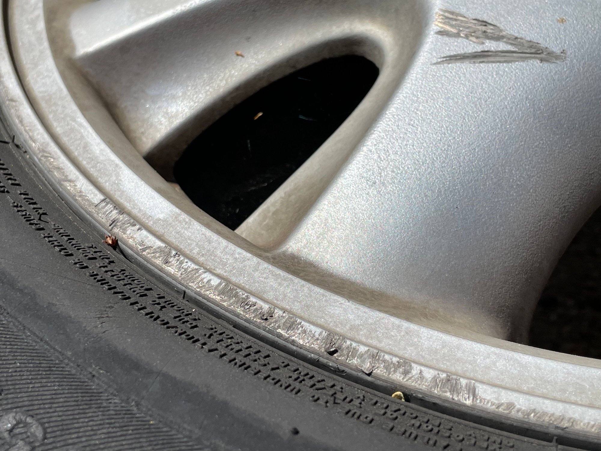

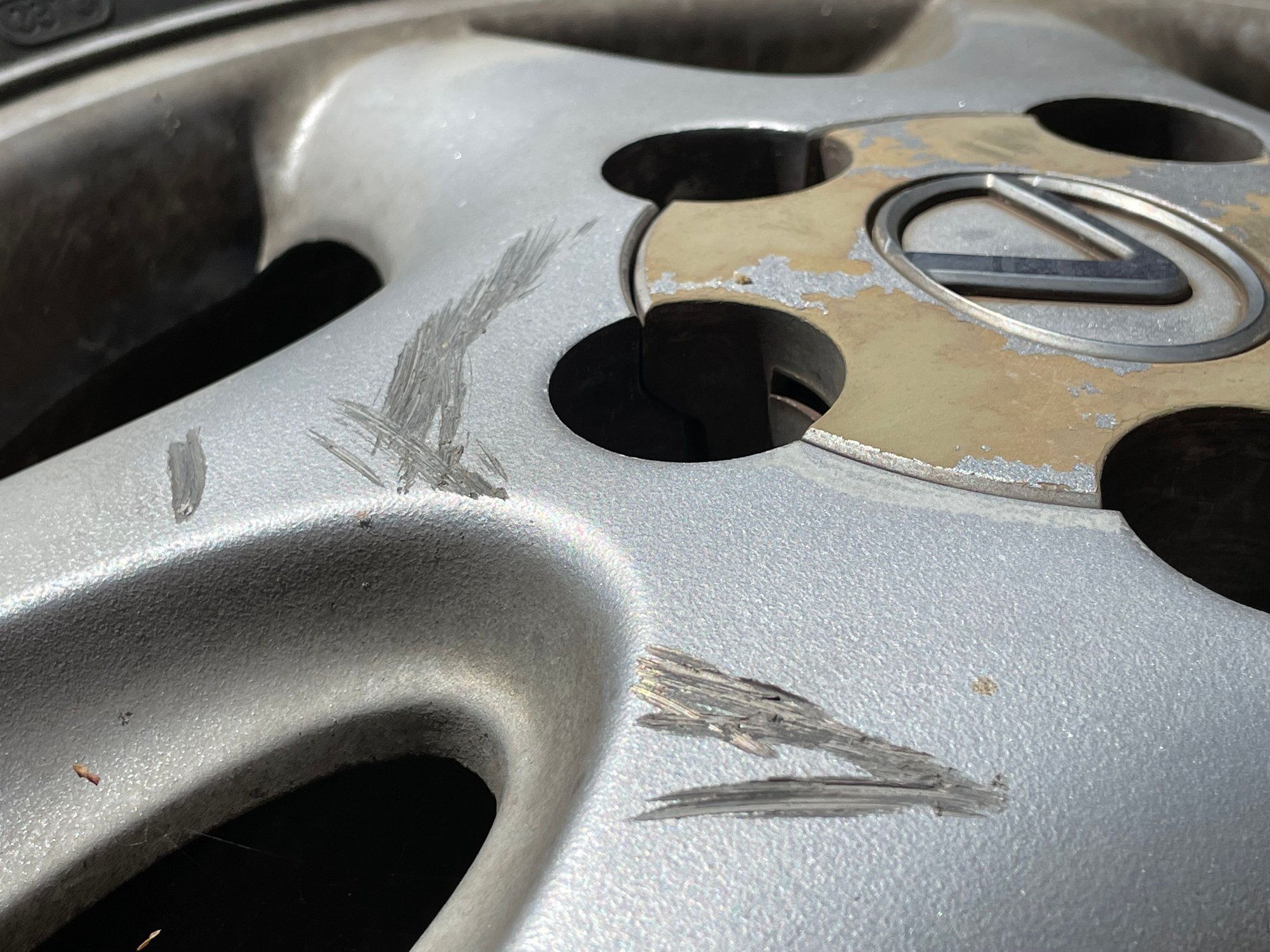

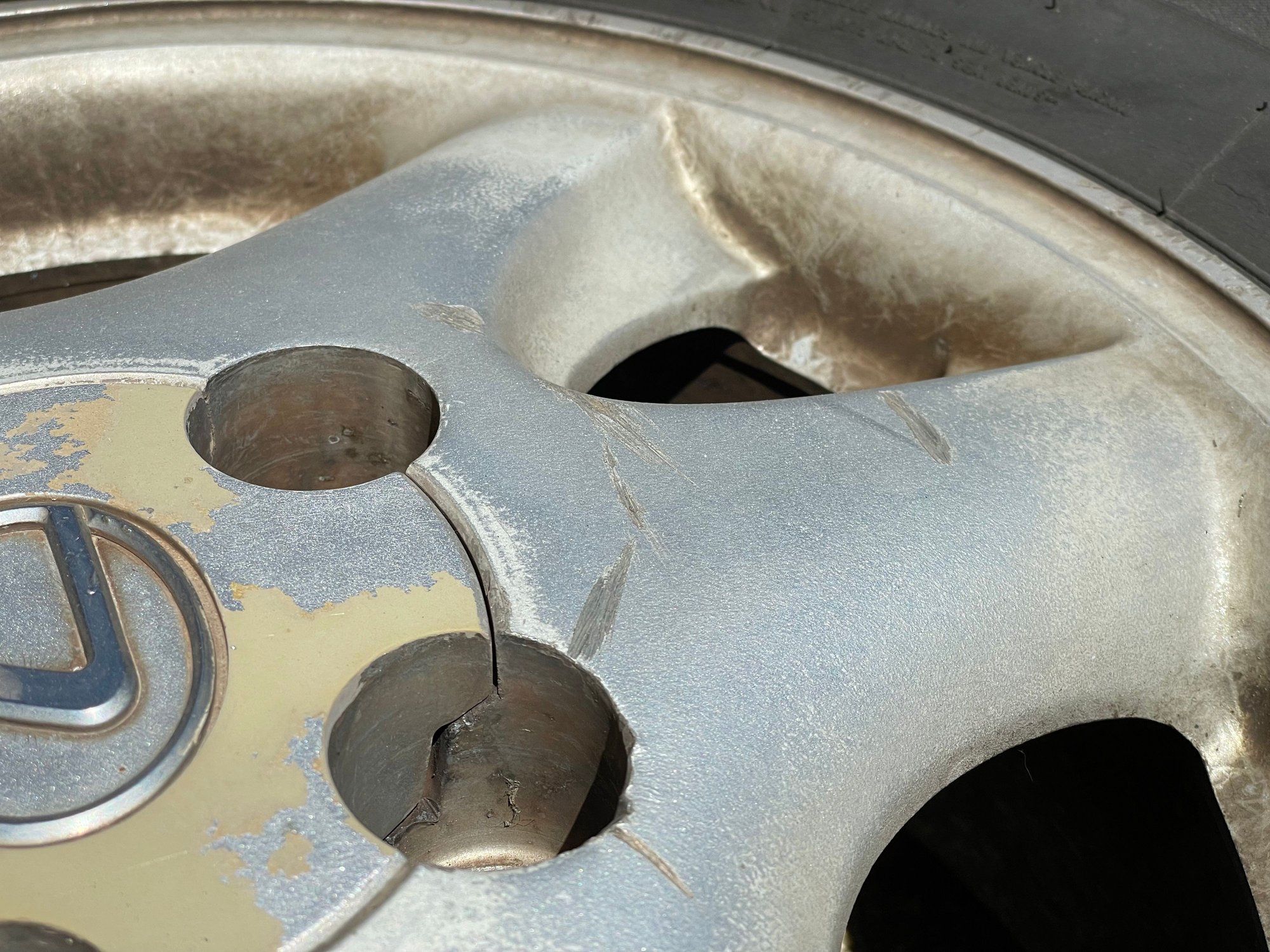

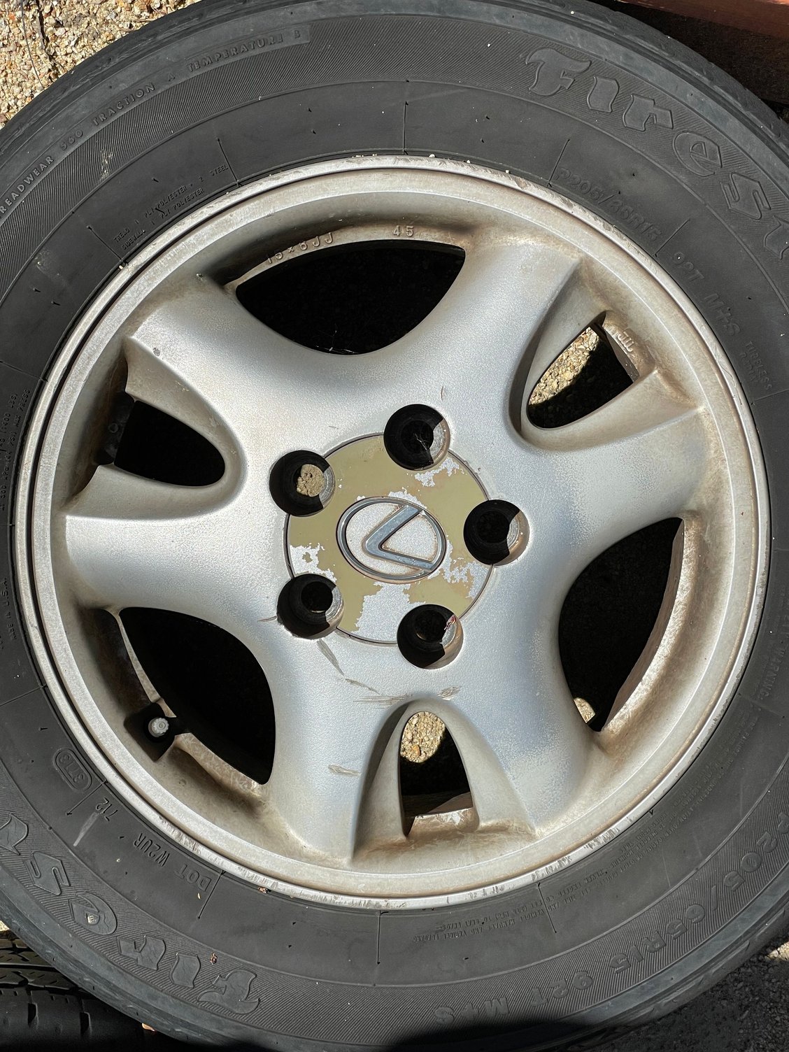

Thanks! Here's the set of wheels I just bought...
Here's the NOS center cap...
The plan so far is to have them power-coated and paint-matched to the center cap.
