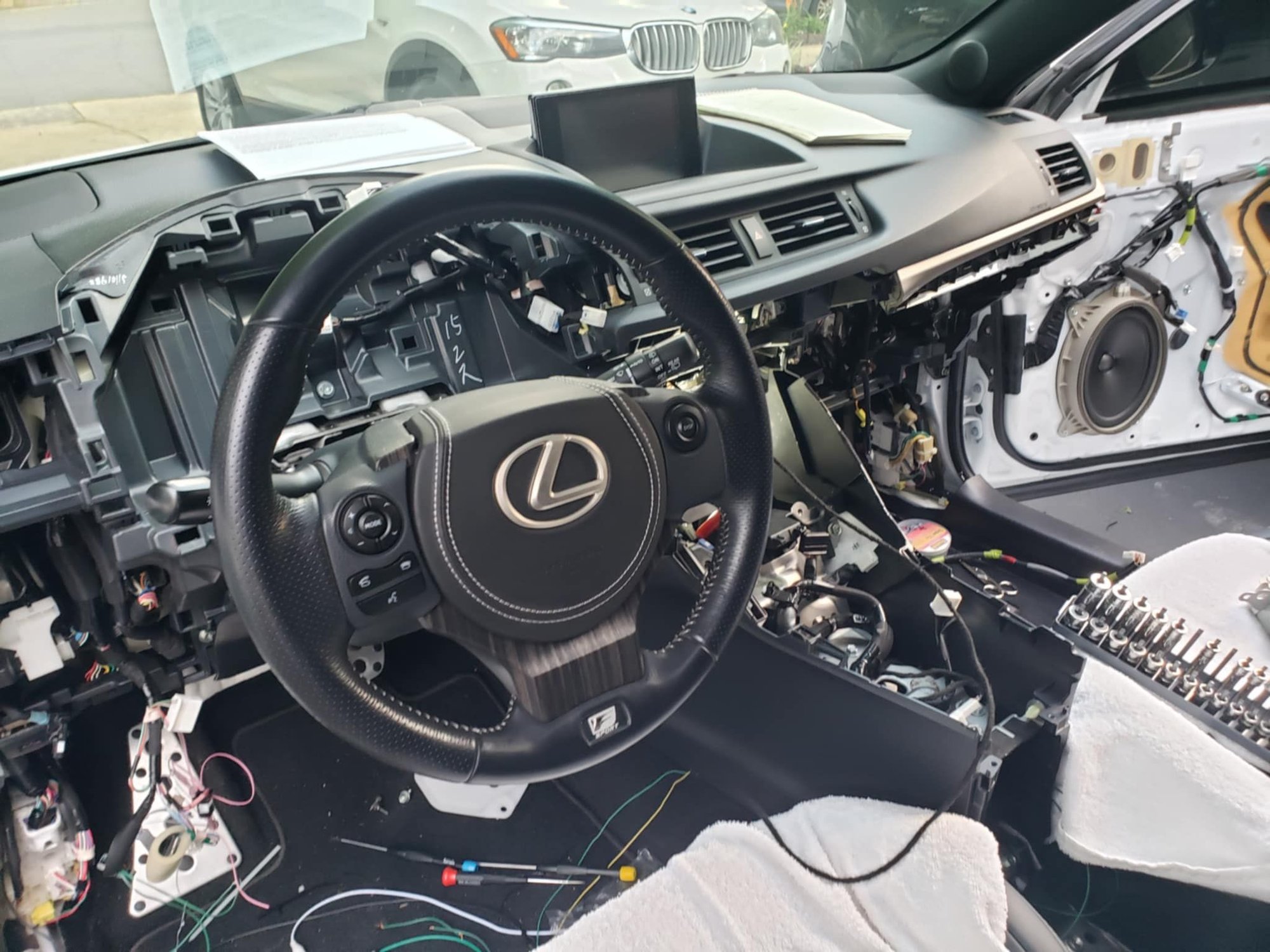

I have my car currently in this state. Note that you don't need to do all of this, but I am also installing a Apple CP/AA device so I needed to take the console out and other stuff. Plus it makes it easier for me to run the wires to the passenger side.
