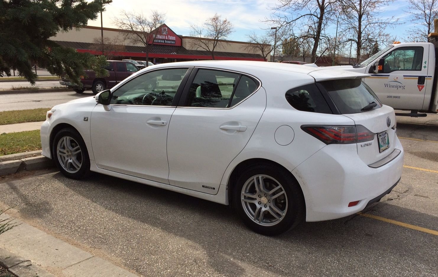

I have 205/55-16 Michelin X-ice 3 winter tires on aftermarket 16x6.5 wheels with a 40 offset. This combination has worked very well.
pic
thanks! looks great by the way
