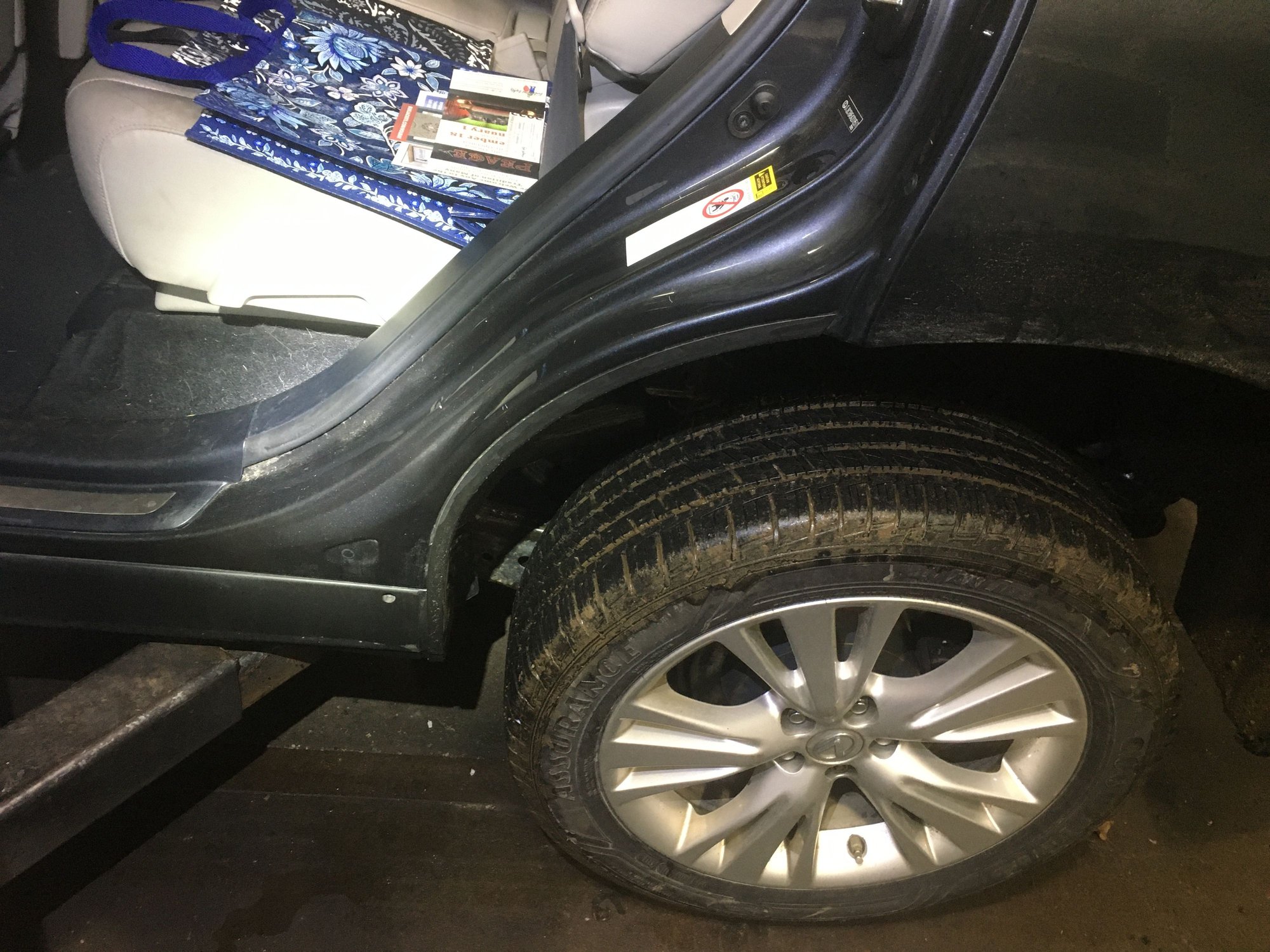

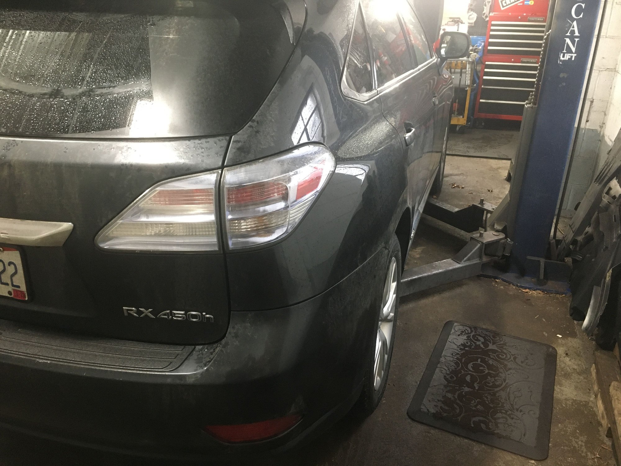

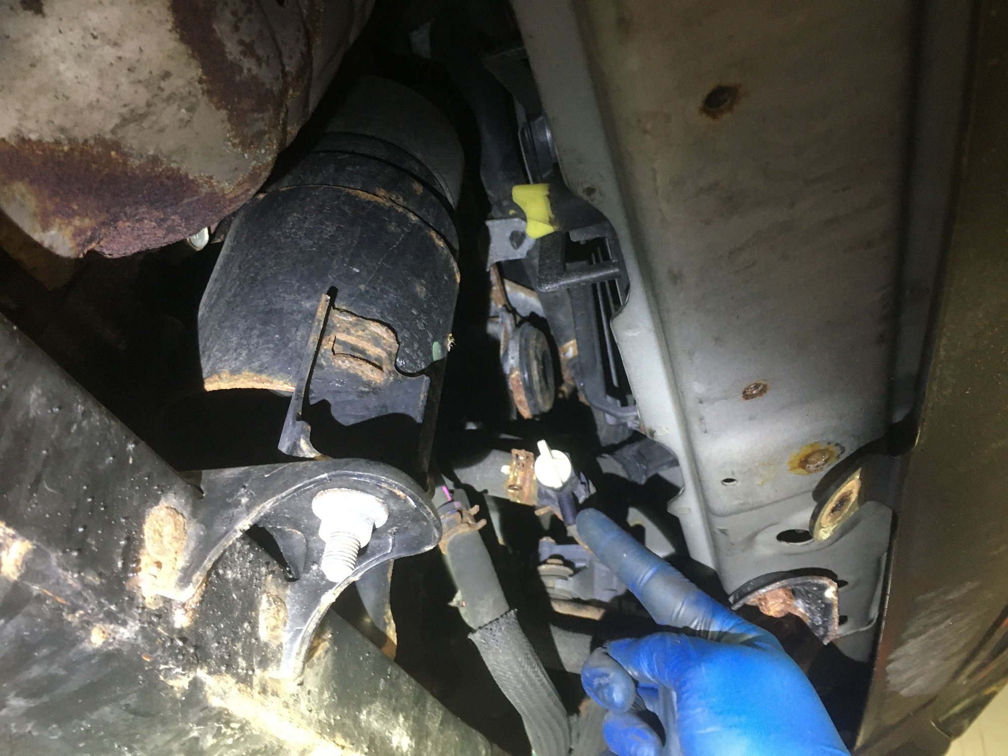

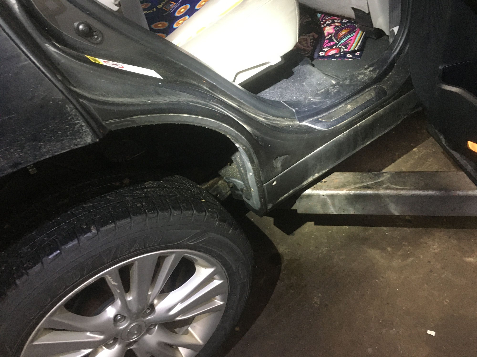

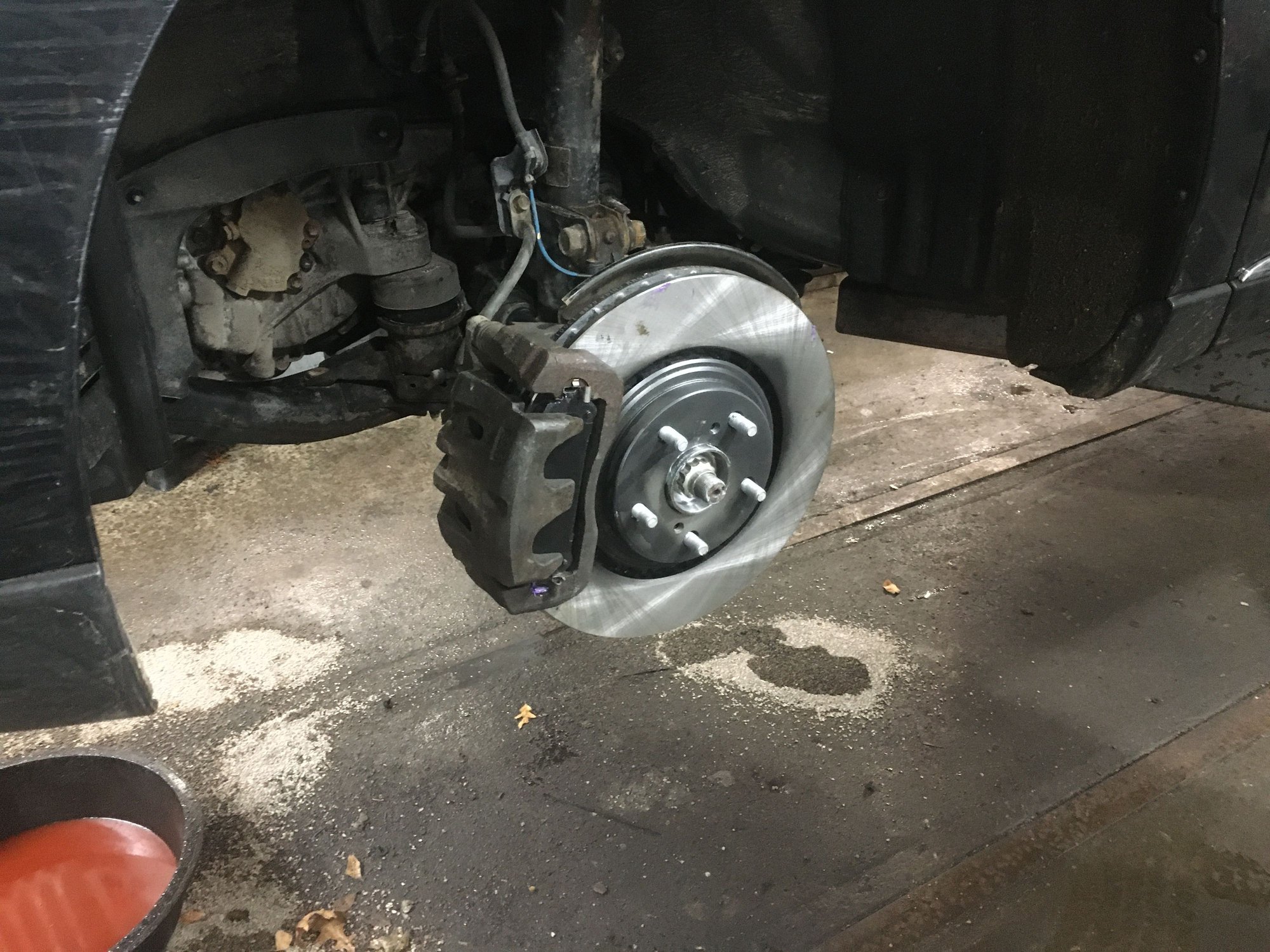

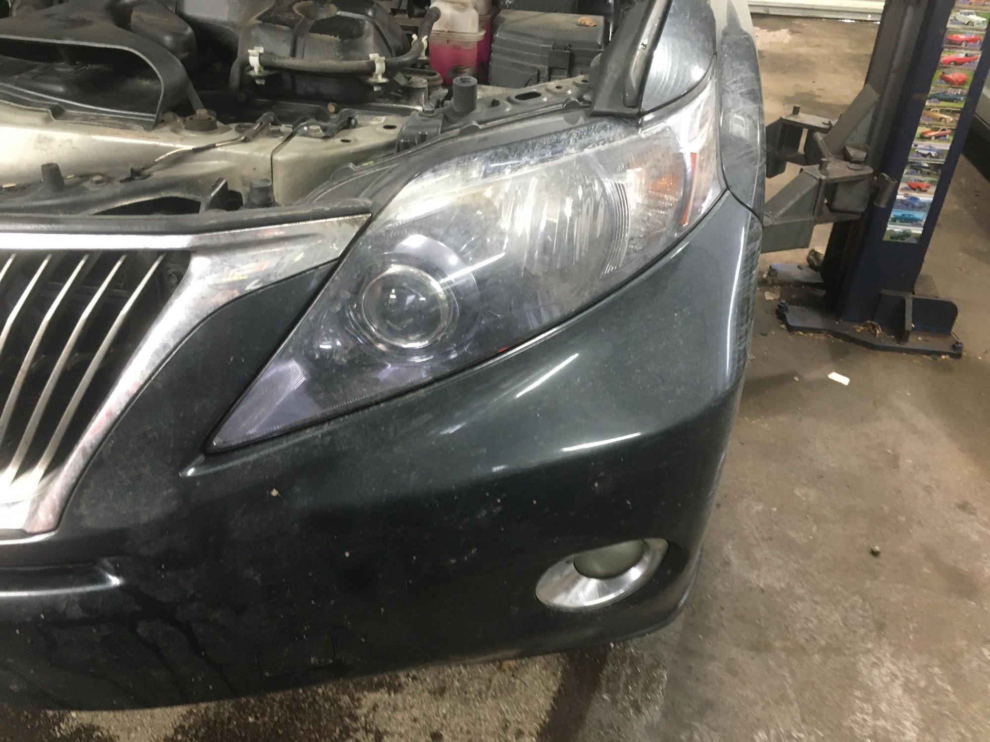

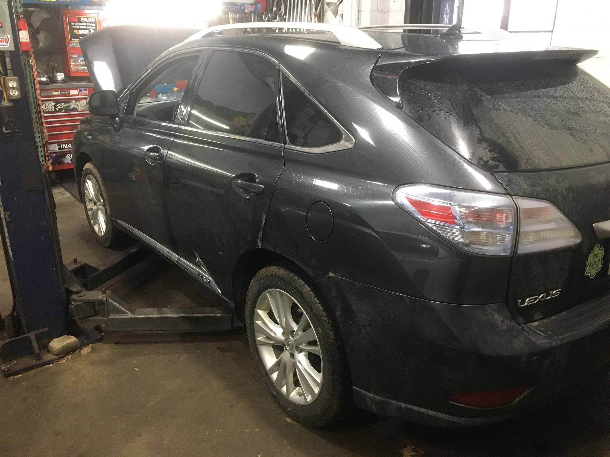

Sample size of one I know but I did some work on a car yesterday that had up to this point never had anything other than oil changes from CPO to 223k miles, It's very very impressive to see any car with zero maintenance do this well. This has been fairly consistent whenever a Lexus shows up to the shop unless it's something like the LS460 or similar advanced cars, those sometimes need a lot more depending on how they were cared for. Pics below will have corresponding info, this car was not so much as inspected for at least 6 years.

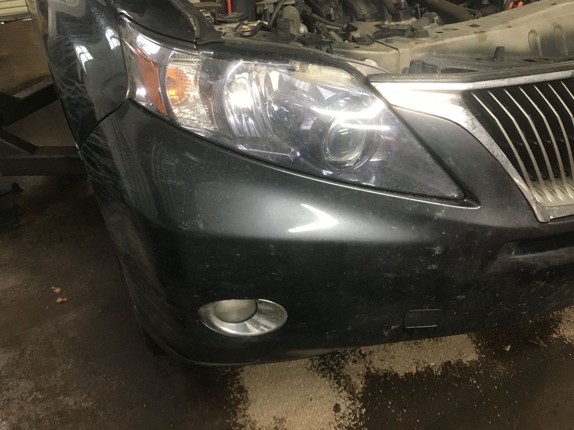

Looks good for 13 years old and 223k
No major dents/damage at all really
Headlight are even decent
Rims haven't been messed up too much, most of them are in good shape
No rust despite the car never really being washed/cared for
All the usual trouble areas are good to go

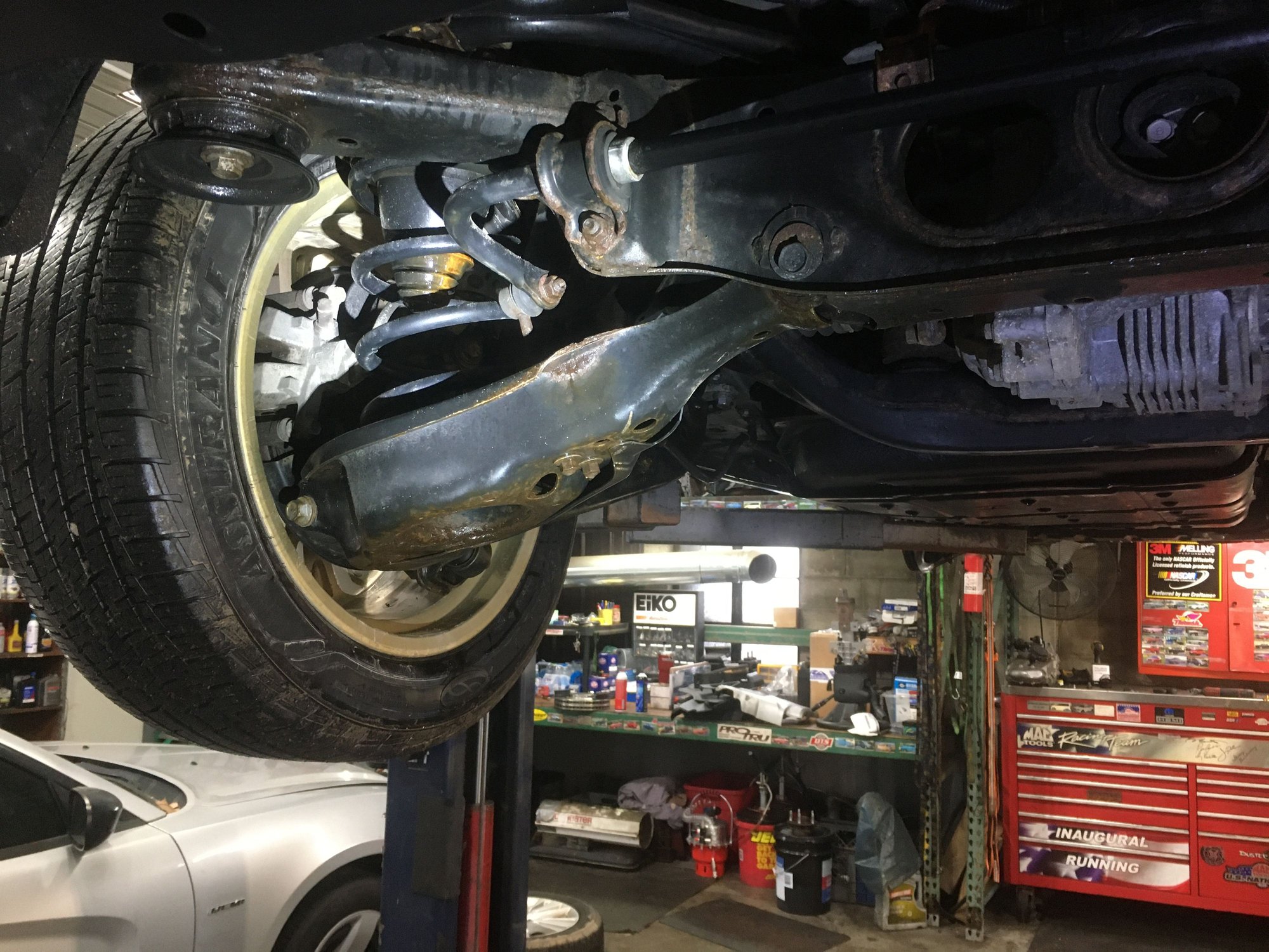

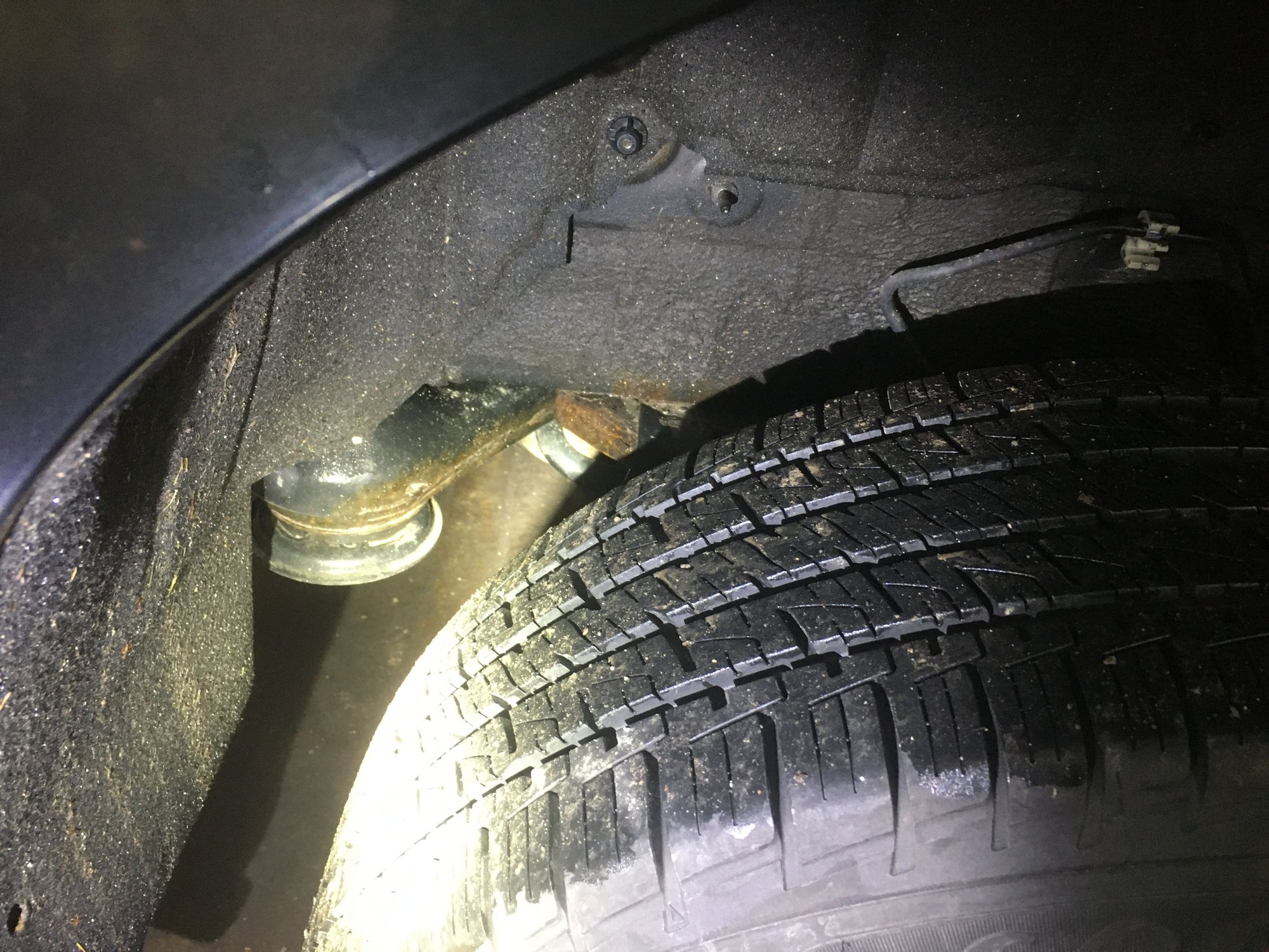

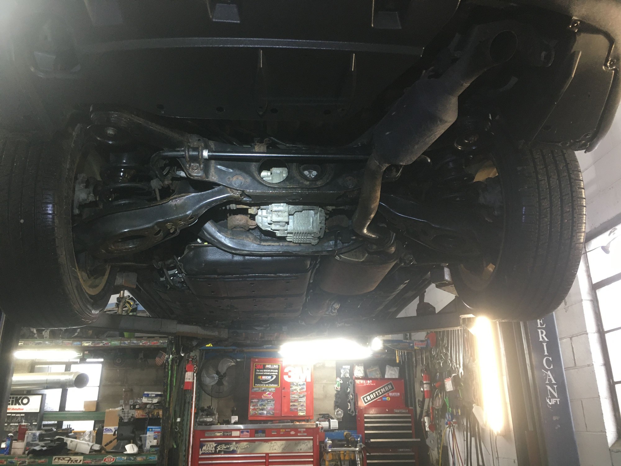

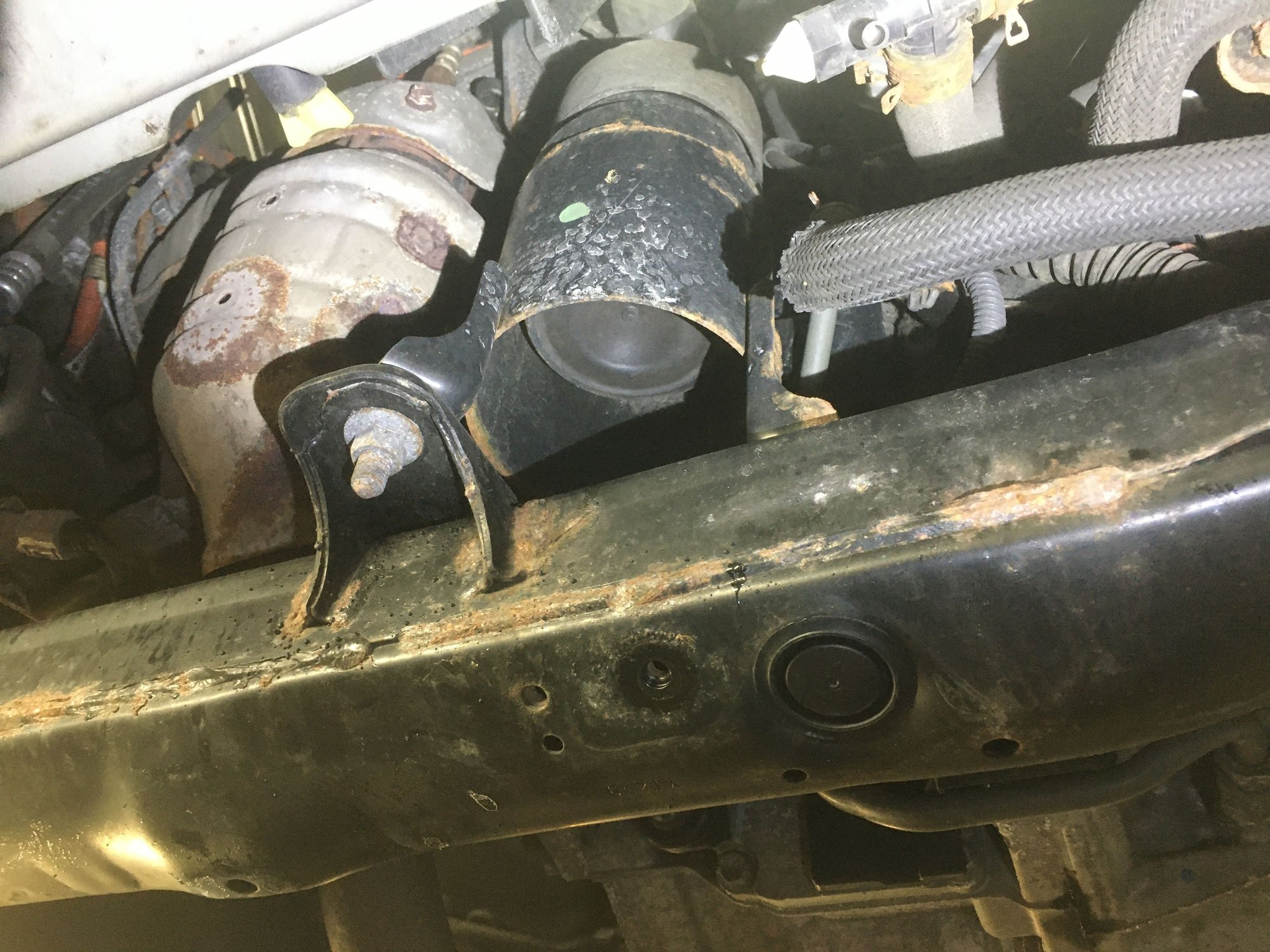

The only thing I could find is some very light rust on the trailing arms....
And a little on the rear subframe

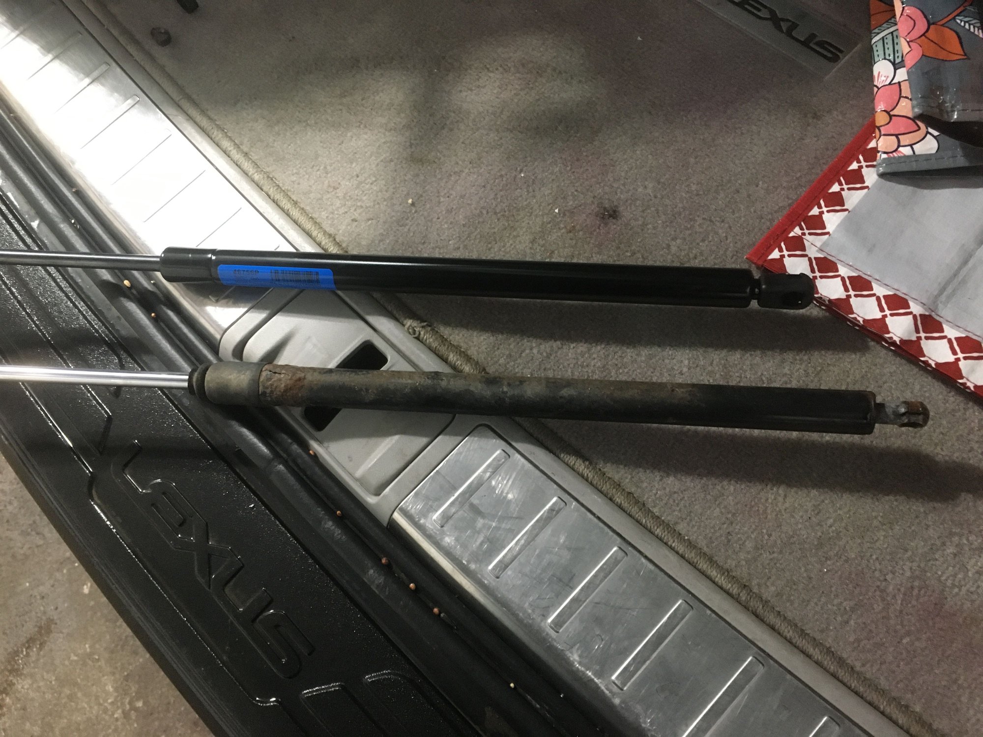

Rear hatch shocks, still working but in the cold they can be very marginal, easy swap. This was actually the reason the car came in, it's always stiff like this that makes Lexus cars show up since owners actually interact with this.

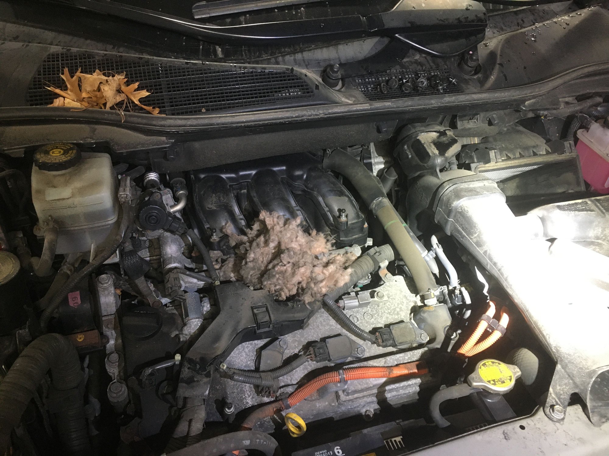

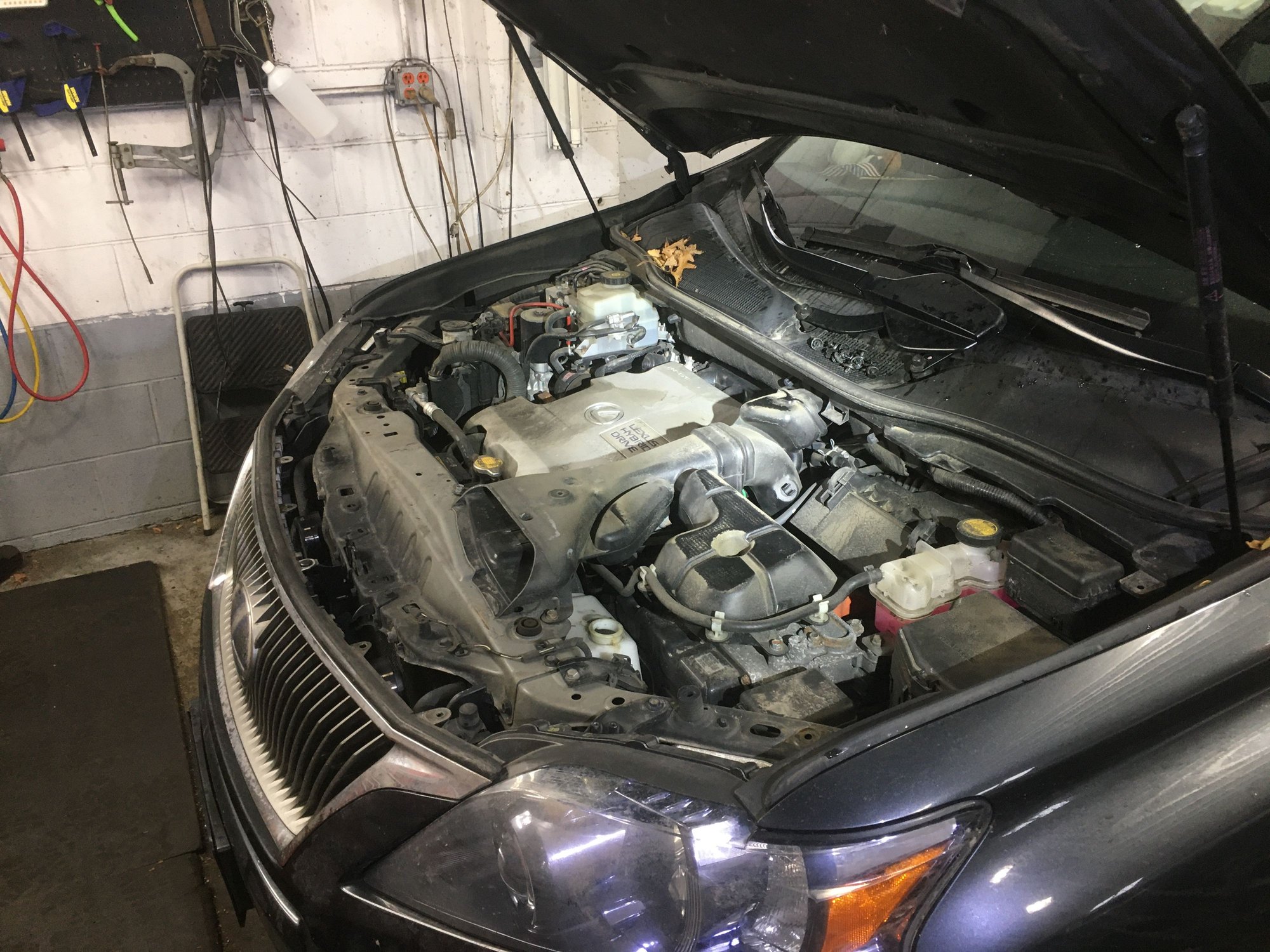

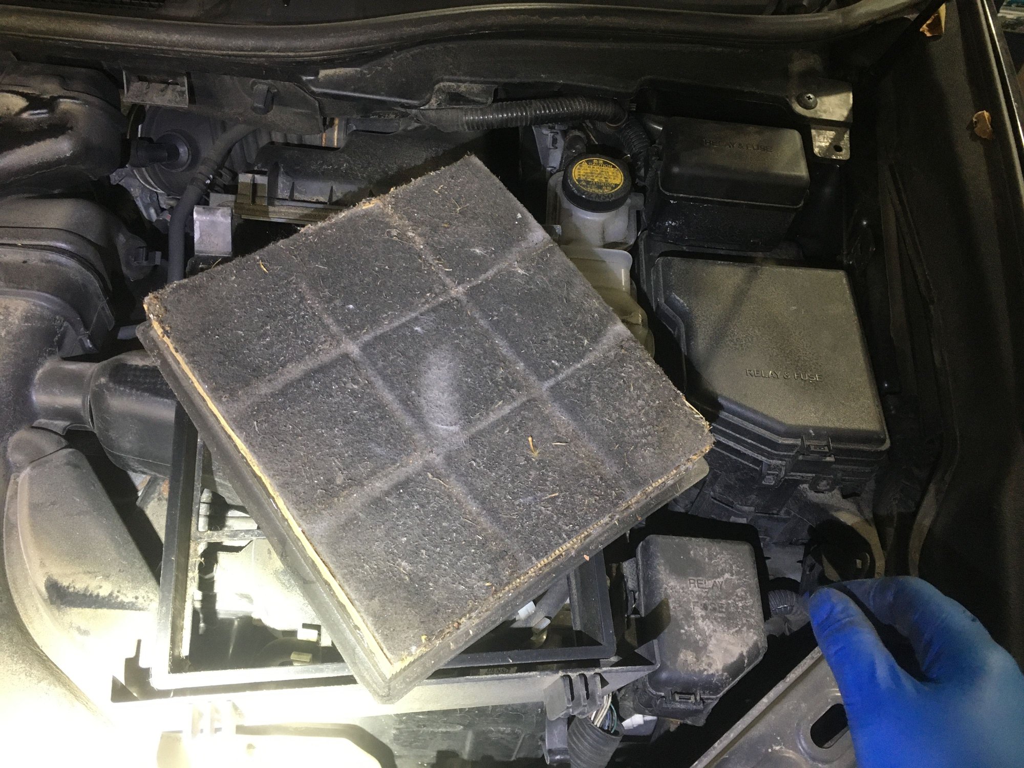

Covers pulled, very very dusty
I am not sure how old this engine filter is, it's VERY dirty though
Just a light finger swipe shows how bad the buildup is
Mouse nest among the injectors and fuel rail, got that cleaned out

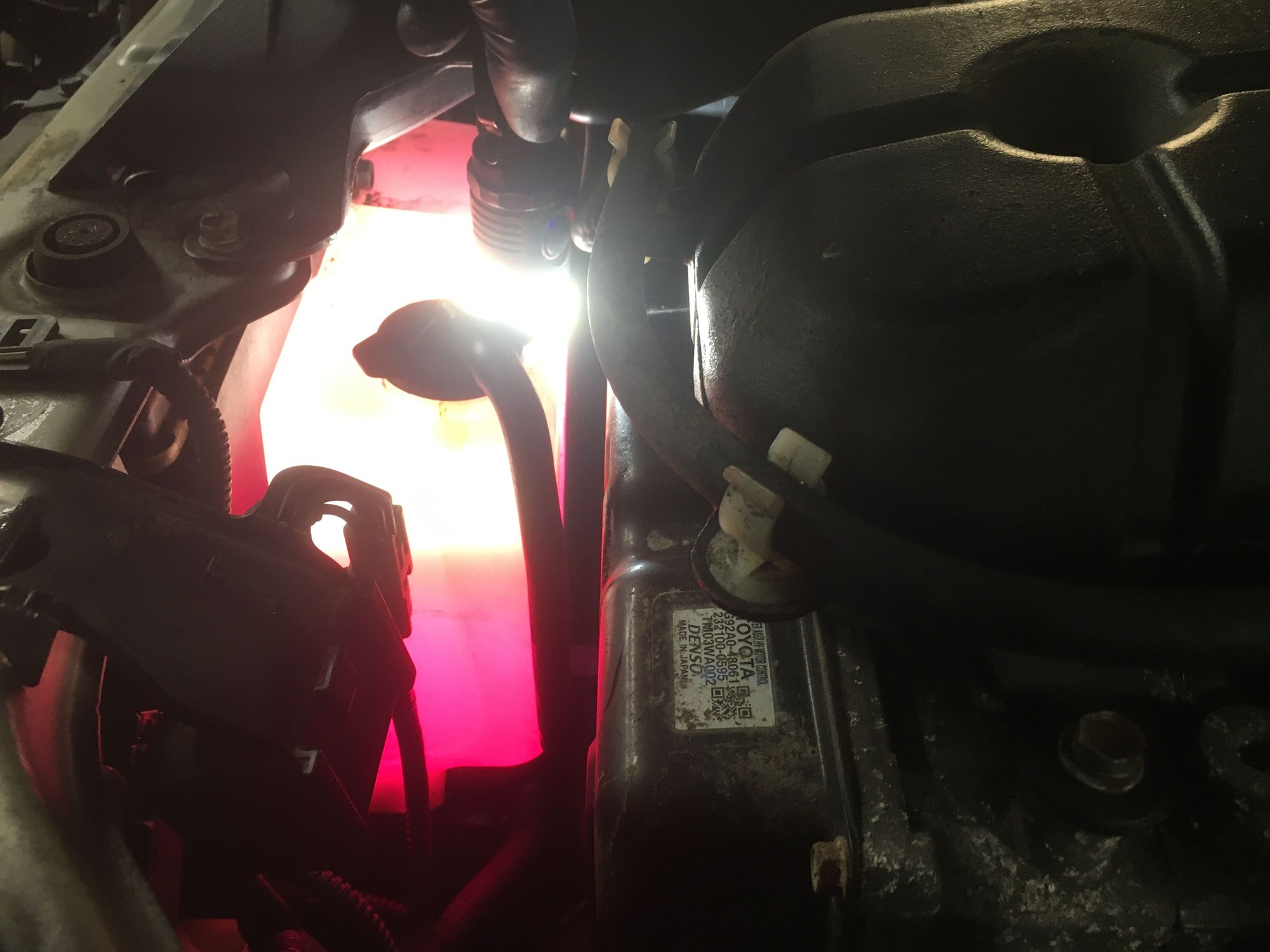

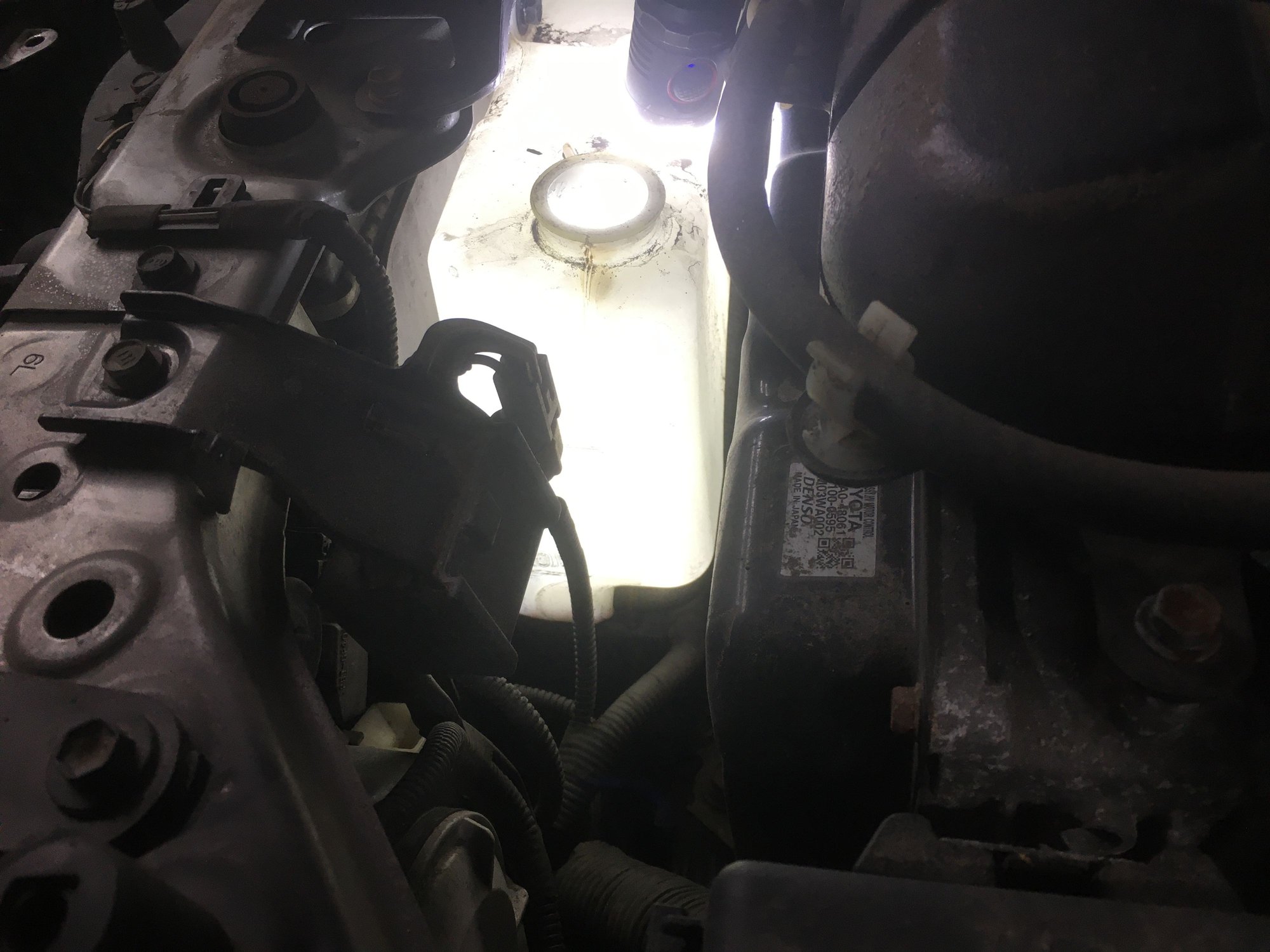

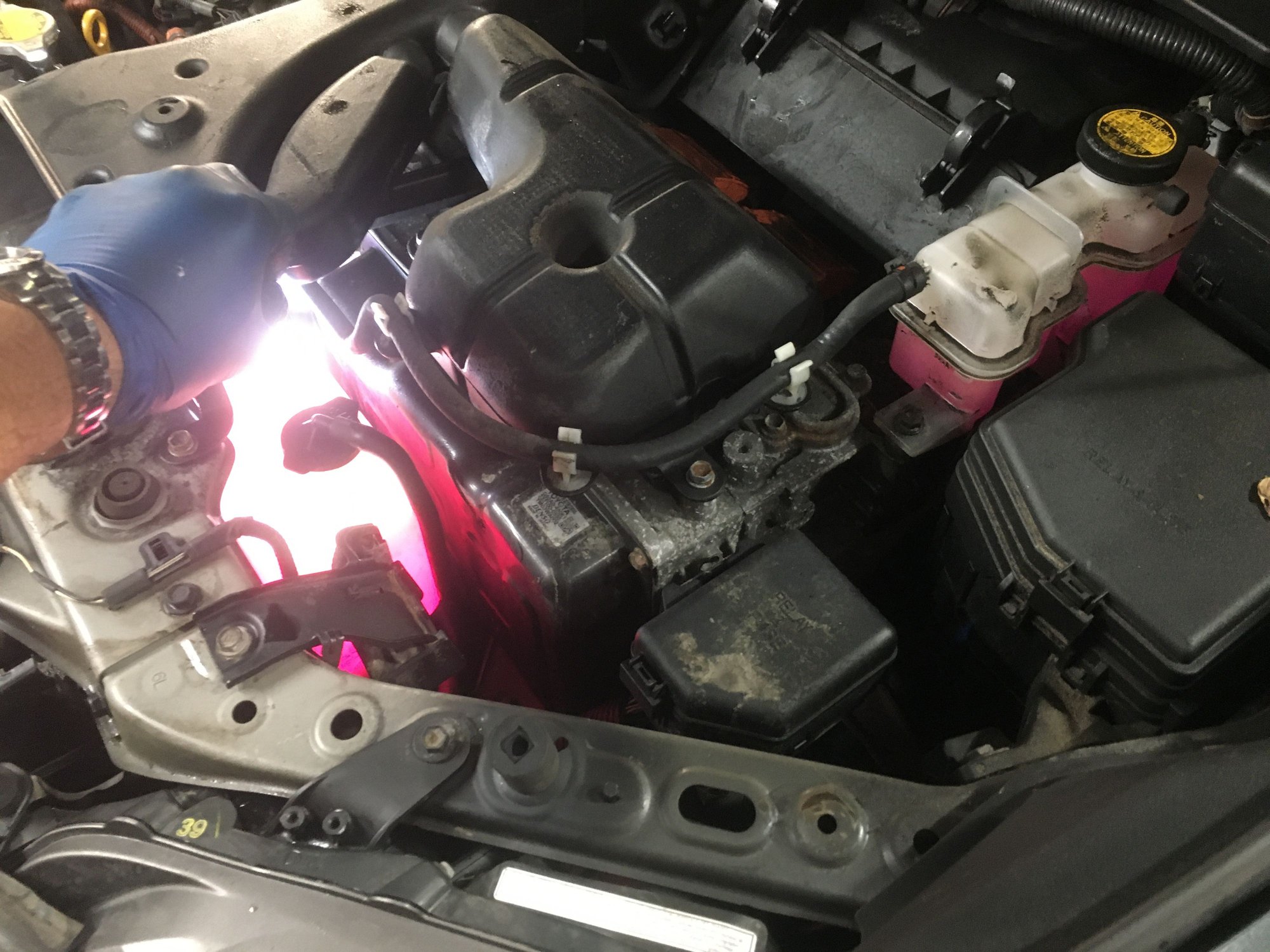

Old coolant was quite orange, I'm certain this was original to the car.
Zero reserve coolant remaining.

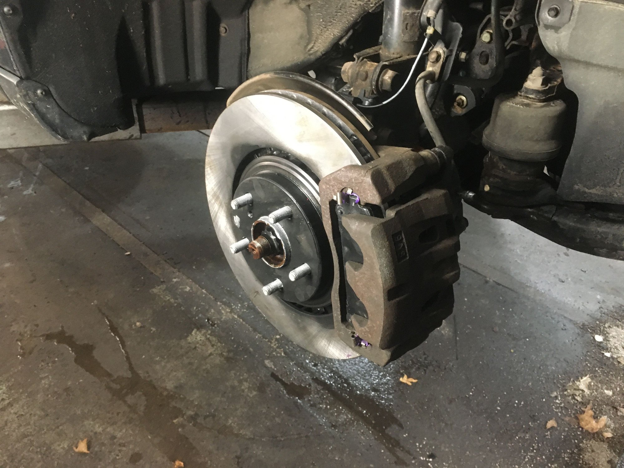

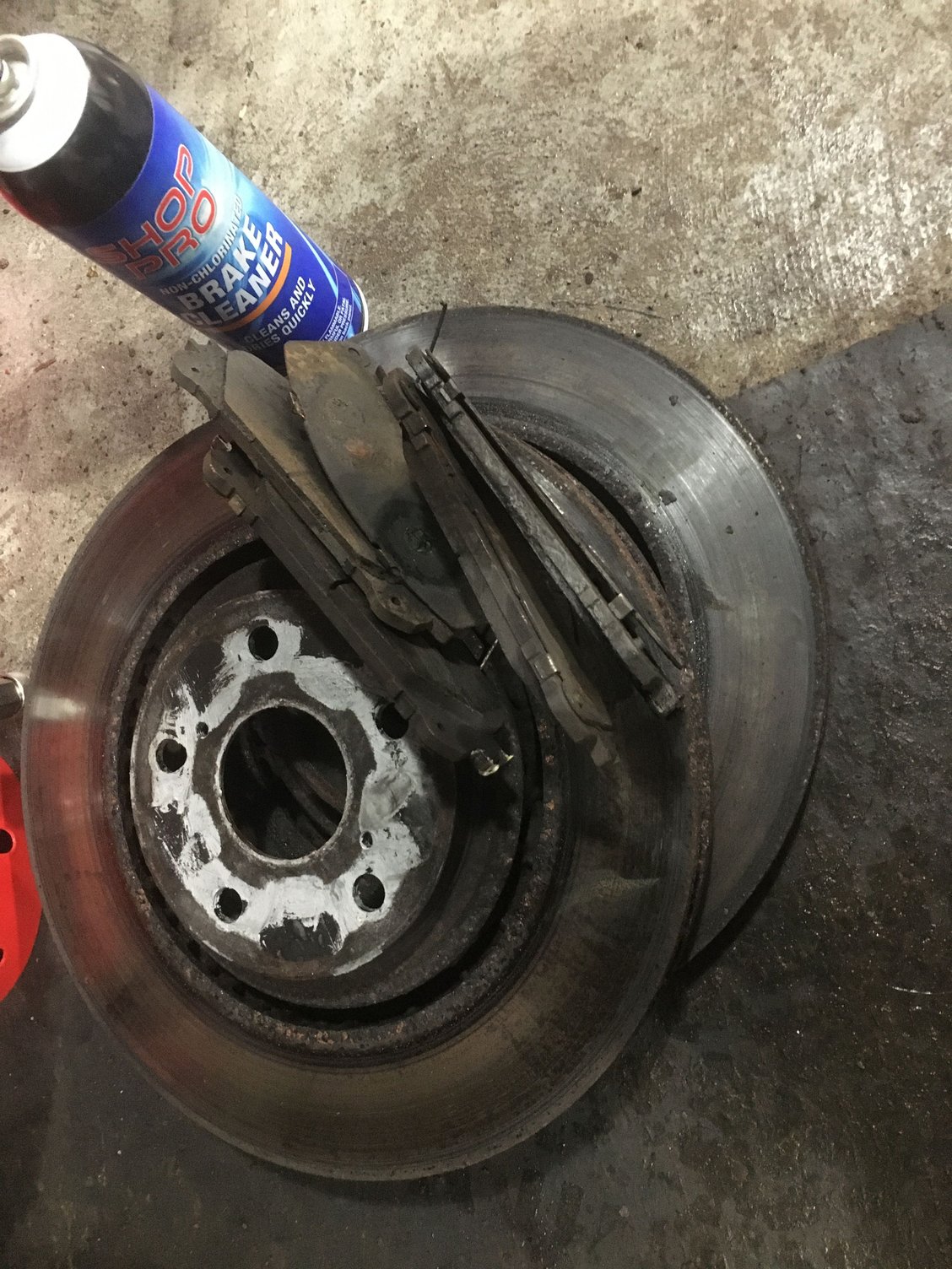

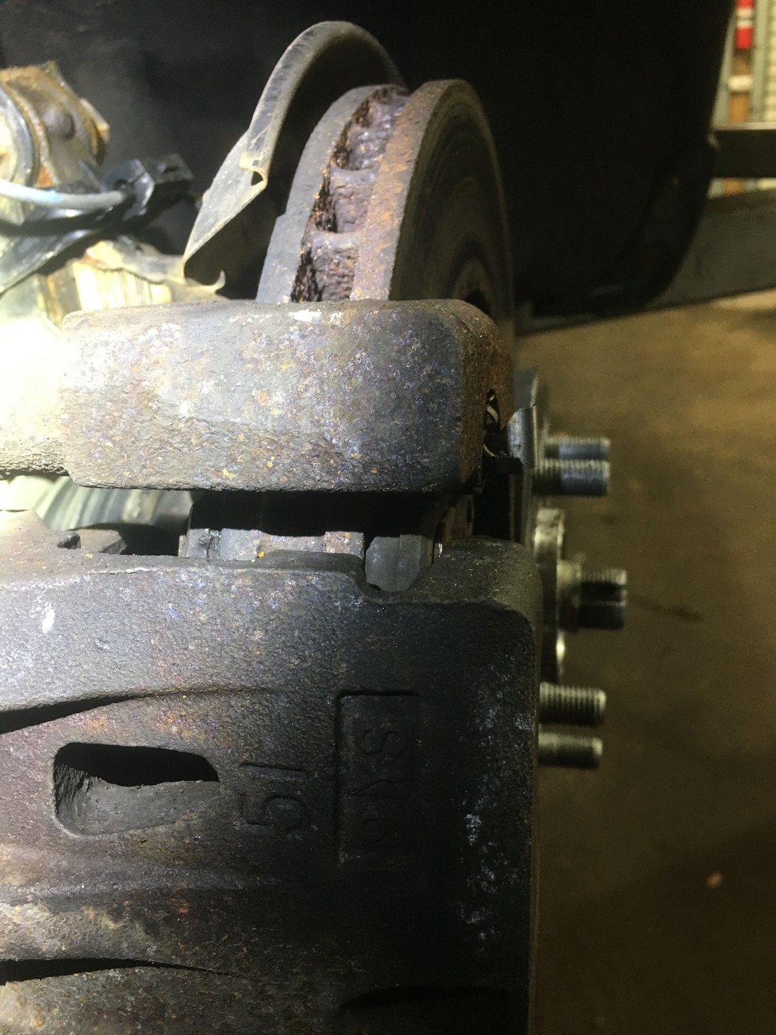

The other reason the car came in, the brakes have been critically low for a long time and have finally gotten to the point they could be felt.
About 1mm inside pad left, way past the point you should replace them.

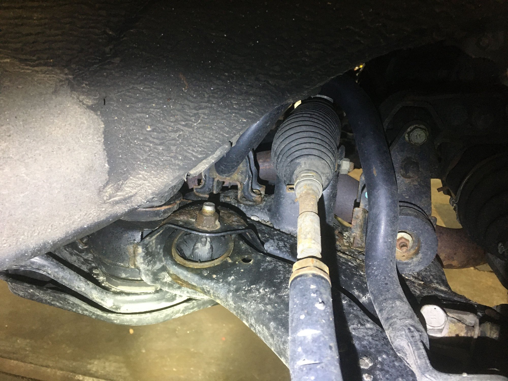

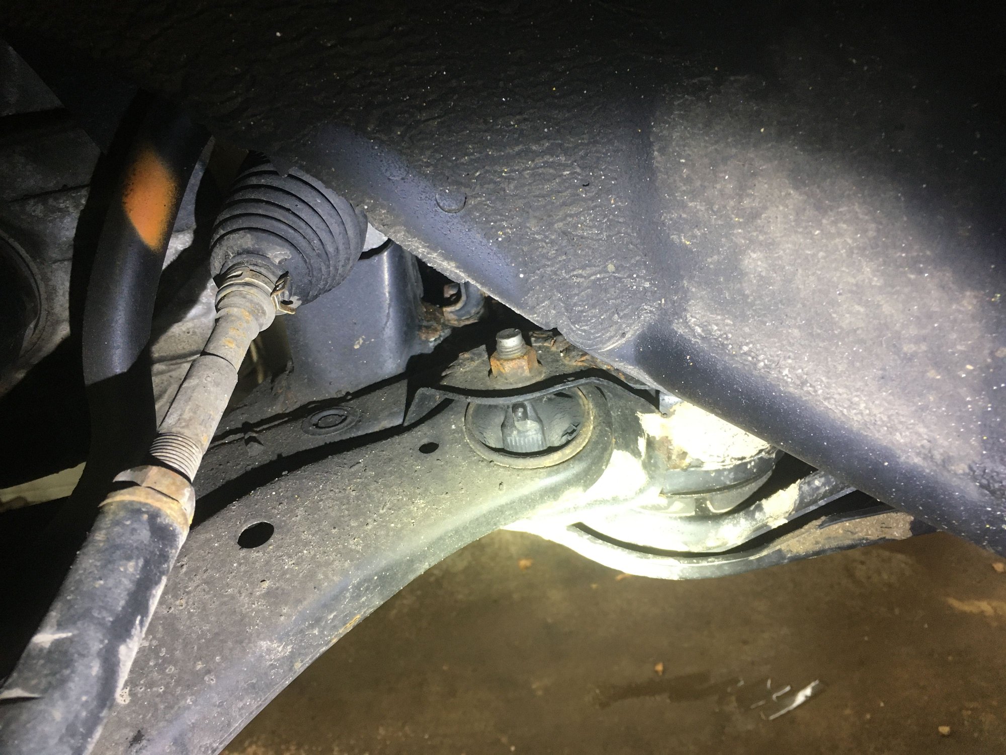

The only thing I could find wrong/worn is the front lower control arm rear bushings have some cracking, not to the point they need addressed yet but still noted.
This is still surprising since this was it. Nothing else is worn/suspect

That's impressive, what are the wheels like? Both my Lexus were plagued by poor quality alloy wheels from new, suffering bubbling and corrosion after 12-18 months. The dealership swopped them for new ones each time without a quibble but the technician said they had a storage unit full of ones to return. It was very disappointing from a premium brand and something I'd never encountered before.

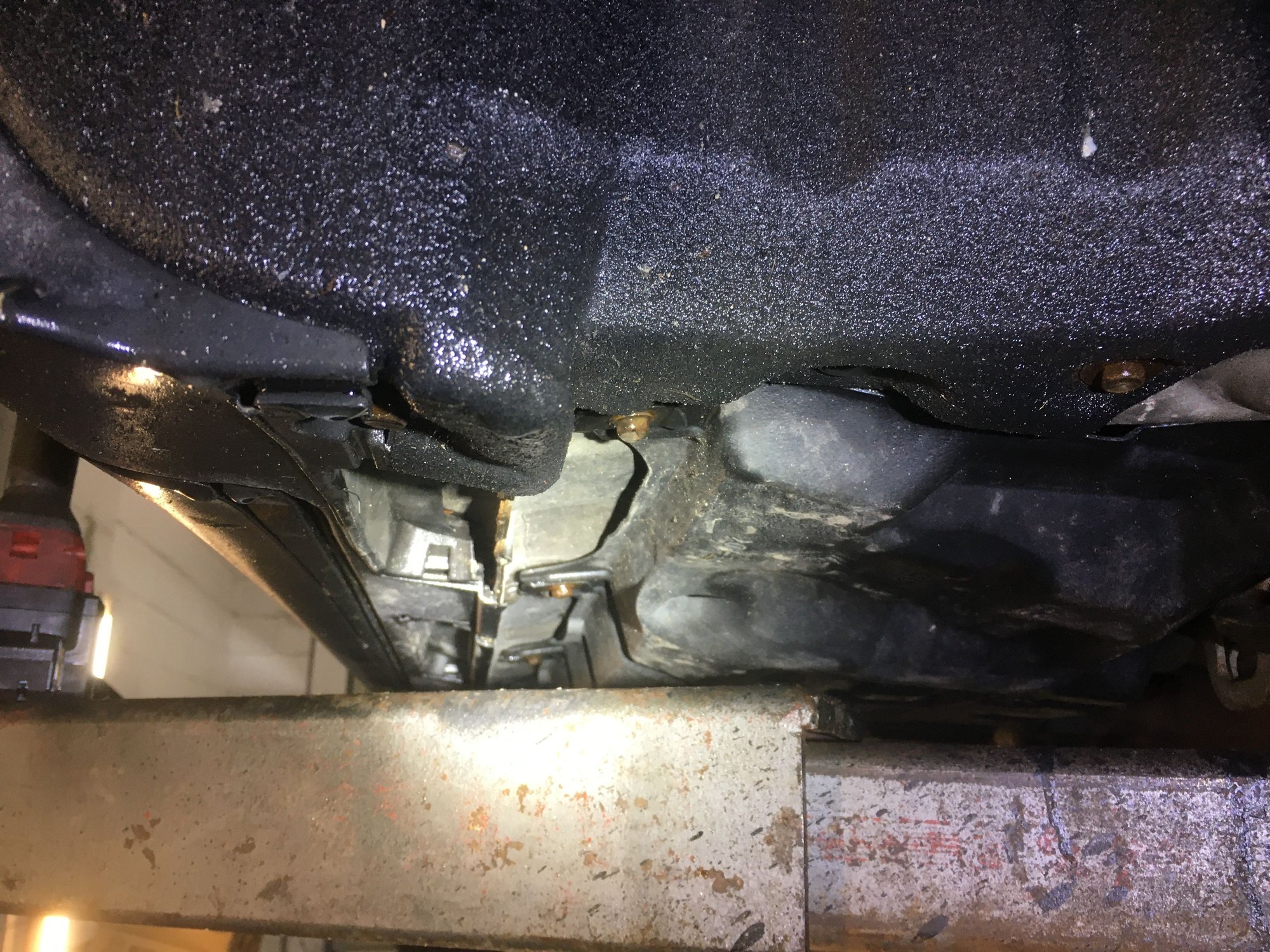

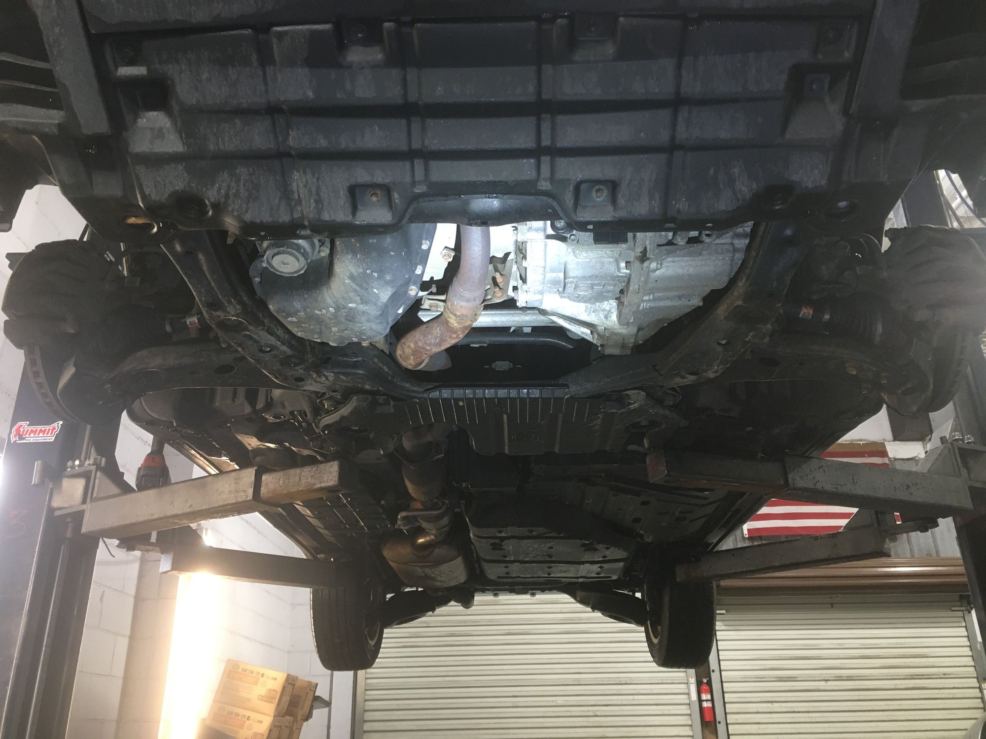

No leaks
No rust
No problems
Even the rear barely has any surface rust
This car has the E-axle, I recommended service at some point but for now the diff oil looks perfect.
One more shot of the underside
Even the active mount is good to go, these usually don't last past 160-180k on gas only cars.

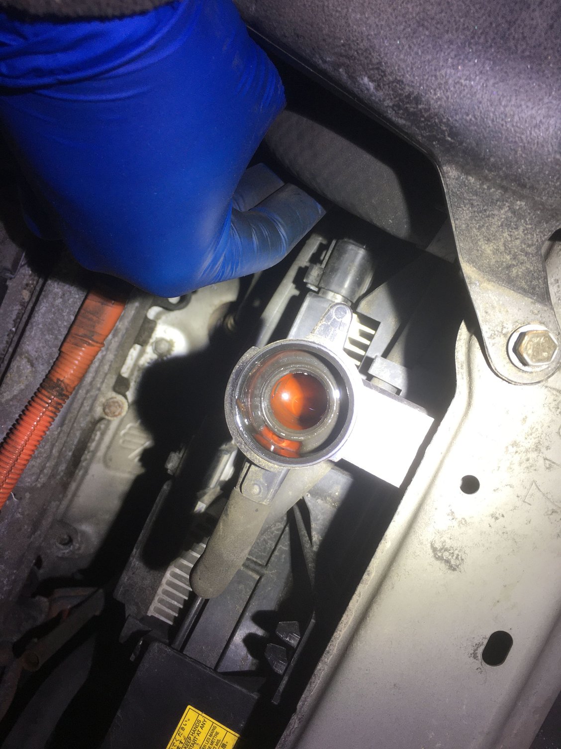

Inverter coolant drain
Main coolant drain

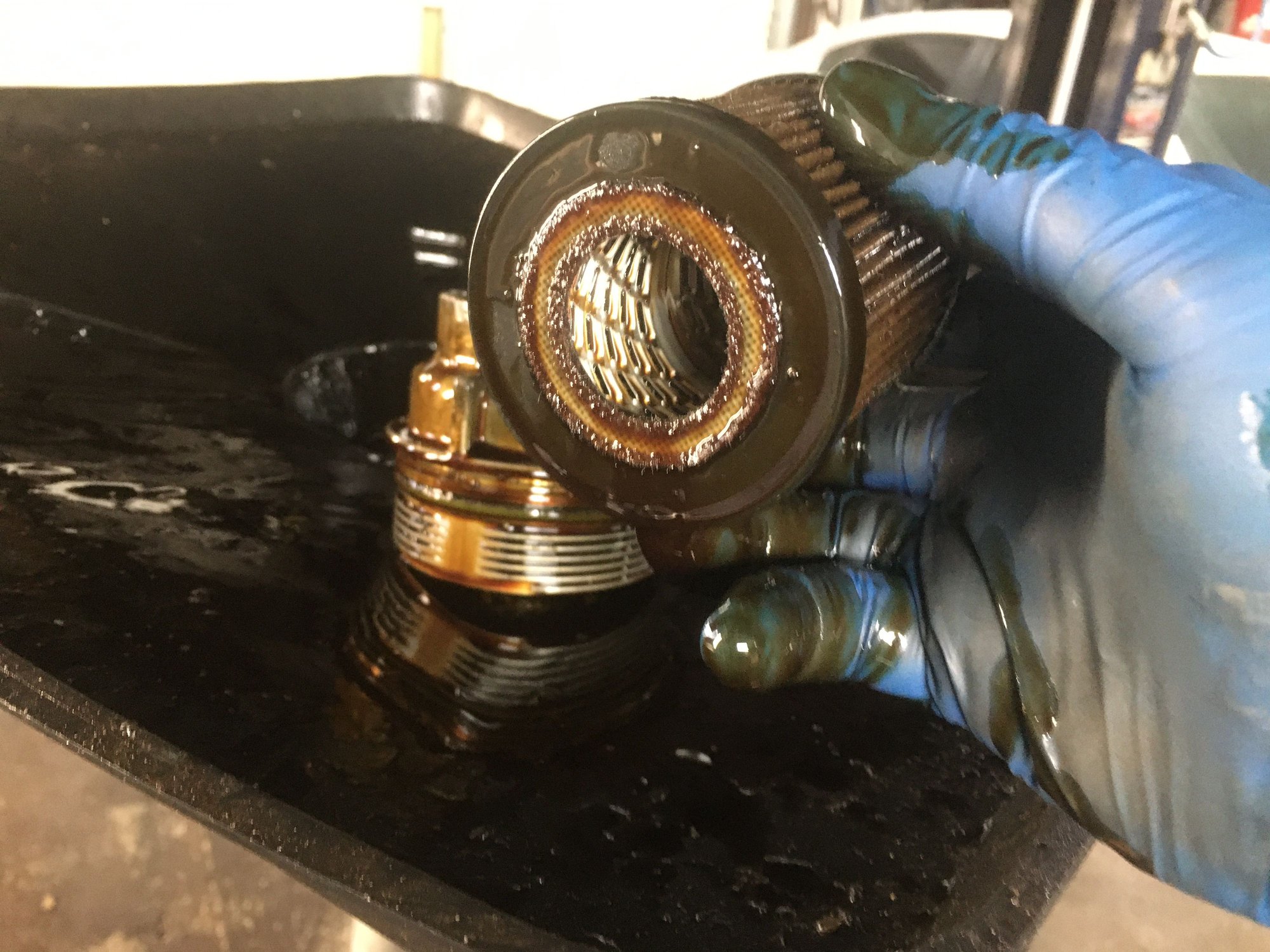

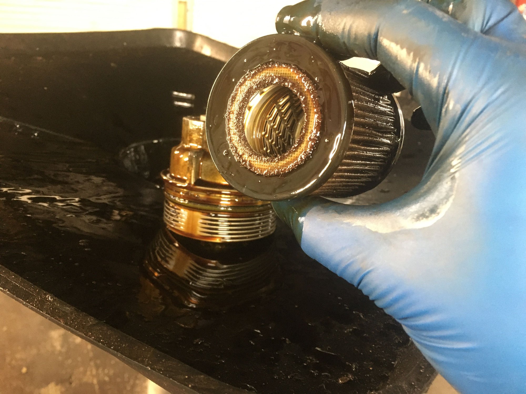

Filter looks very nice
Draining all the fluids

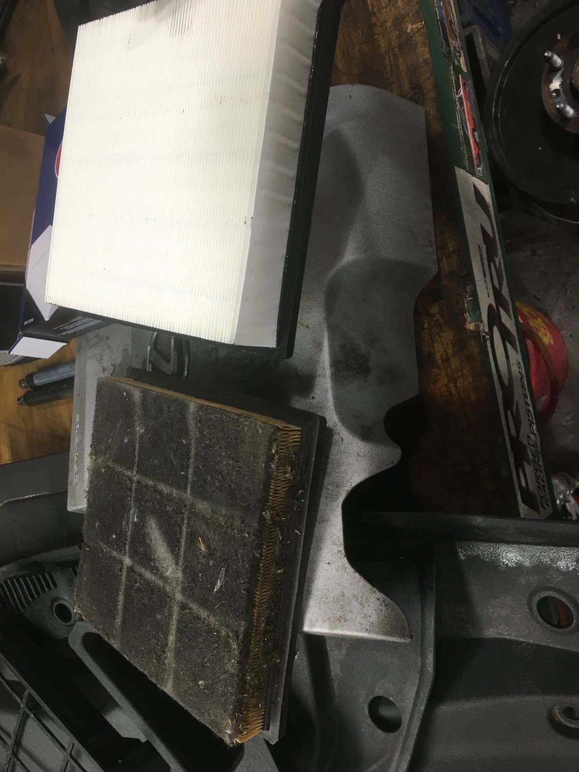

Just a slight difference.....
Shockingly good shape, usually the shield rusts at this point
New brakes, I paint the hats if they don't come coated.
Other side
Coolant is purged, filled, and the overflow actually has a working fill now lol!
All the coolant is bright pink
Old junk
I have no idea how old these brakes are, perhaps original to the car
Really nice old filter, not sure what it is but it's high quality
Near perfect, no bubbling or even brake dust buildup. Very high quality IMO

Japan, this is a 450h from early production. Hybrid system is untouched till now for the inverter coolant change and trans fluid check, no issues.
