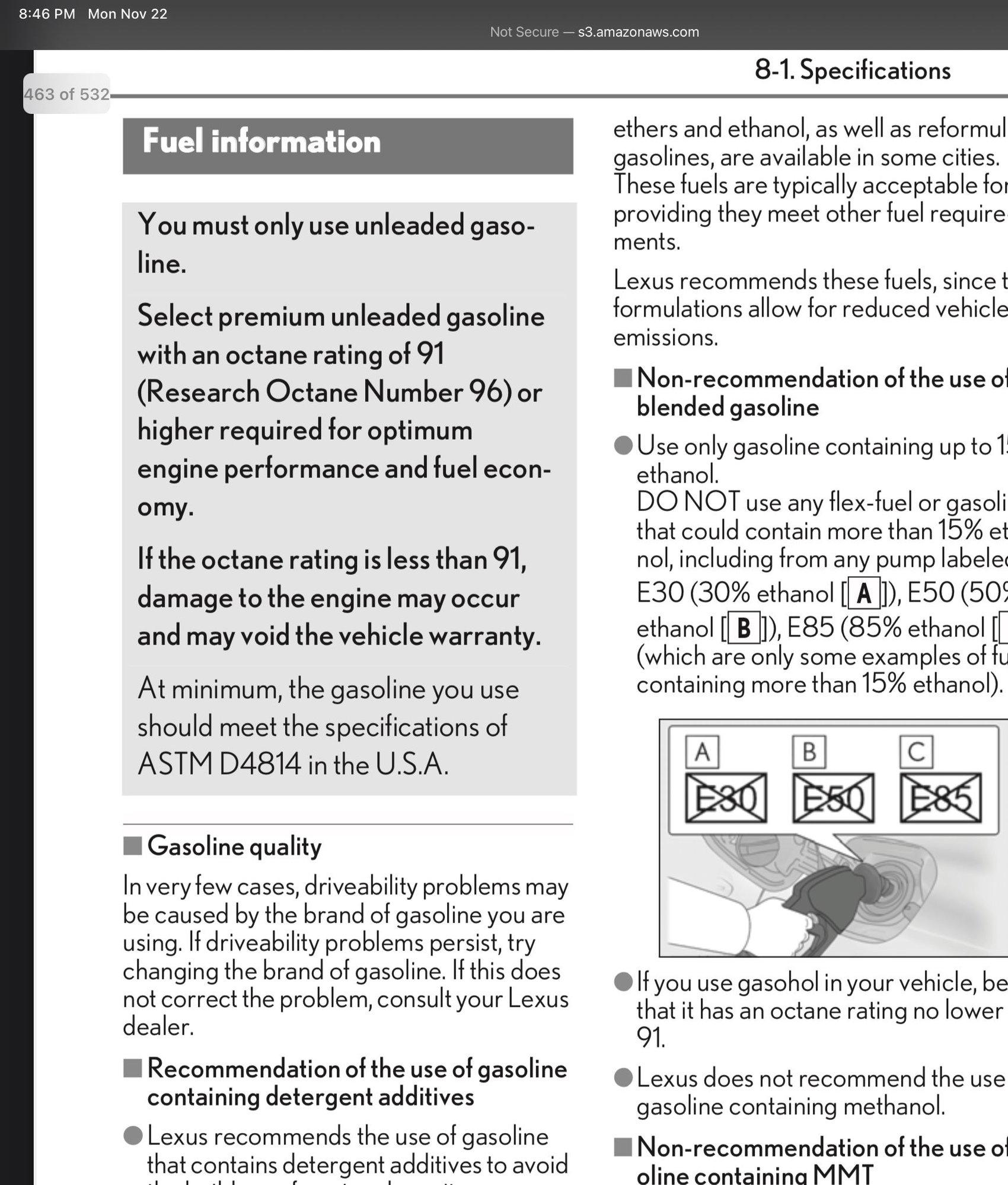

here is what is listed in your manual.
Quote:
One time you’re good. Just don’t do it all the time. Originally Posted by Primolexus
Yes I read that. Reason I am somewhat concerned. Thanks.
