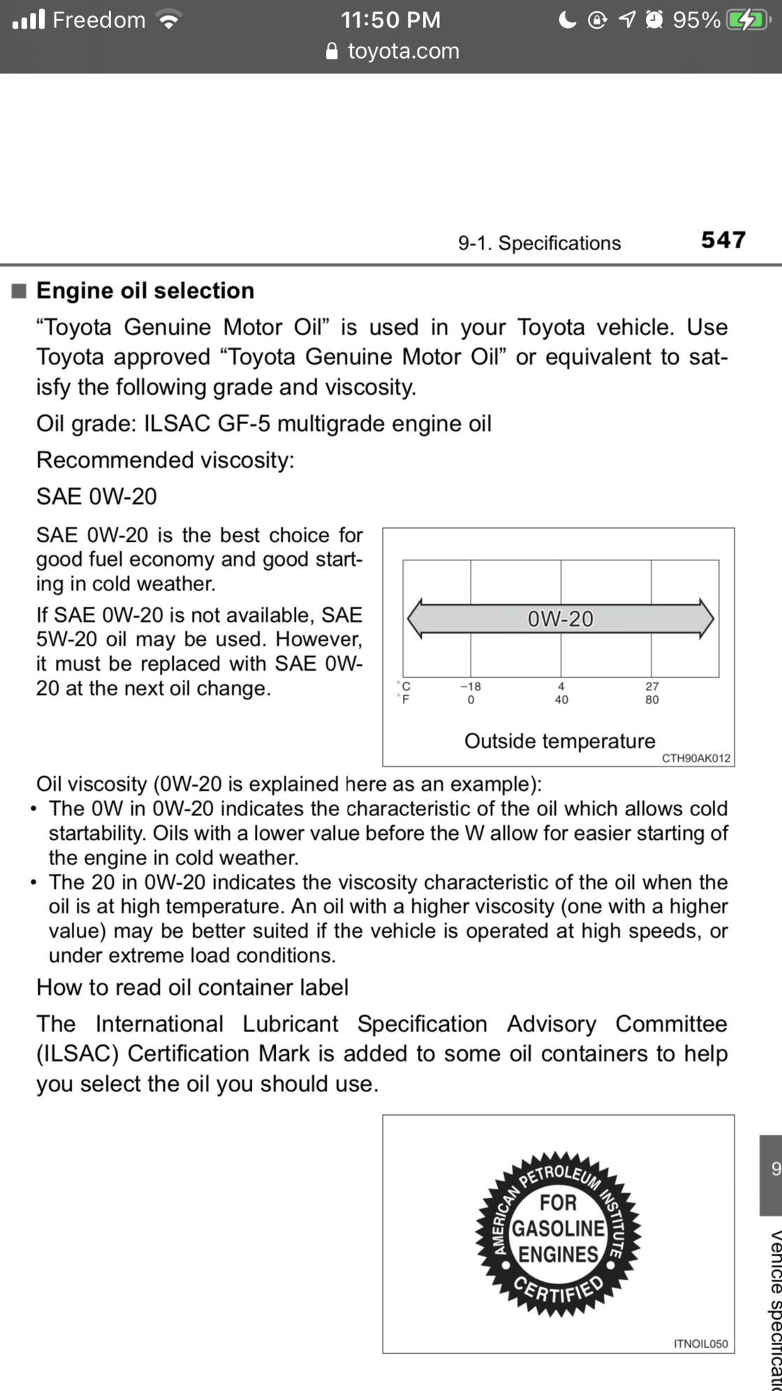

I didn’t watch the video but I saw this comment. I wouldn’t change what the manual specs. Toyota actually says to go up, not down if your oil is actually not available. I don’t really pay attention to the other brands out there but for Toyota I think it is the cas
Originally Posted by Wilson2000
I liked the concept put forth in the video which said one could change weights, as long as one stays within the original boundaries. For instance, my vehicles specs 5W-30, so I could go to 5W-20, but not to 0W-30 or 0W-20.
I think Toyota let’s you go 5W-30 or 0W-20 on some of the older engines. LX570 is one them.
