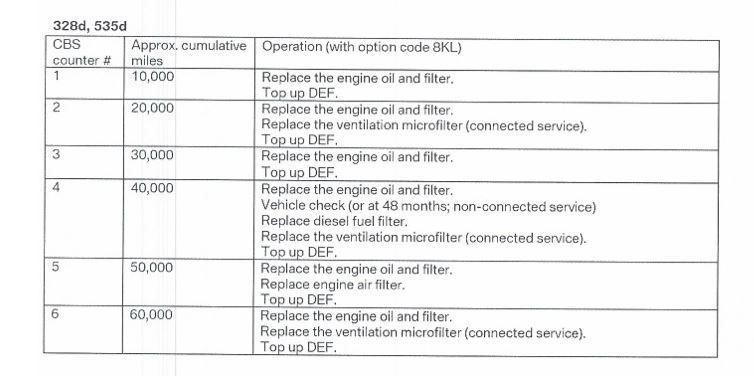

Posts: 9,383
Likes: 620
Originally Posted by bagwell
didn't BMW changes the interval to 10K?
http://f30.bimmerpost.com/forums/sho...d.php?t=868291
I don't have a 2014+ F30. I have a 2011 E90.
After the change and reset of the service indicator, it looks like my interval is actually 13k. Was definitely between 17-18k on the old E46.
isn't the exact same motor in the 14 535d?
Old Mar 10, 2016 | 07:44 AM
  #41
geko29's Avatar
geko29
Posts: 9,383
Likes: 620
Nope, not even close. I have an M57TU2, twin turbo with a cast iron block, 7.5L sump, and the timing chain on the front. The 535d has an N57, single variable turbo with an aluminum alloy block, 6.5L sump, and the timing chain on the rear. Totally different designs. They're both 3L straight-sixes with glow plugs and direct injection--that's about where the similarities end.
