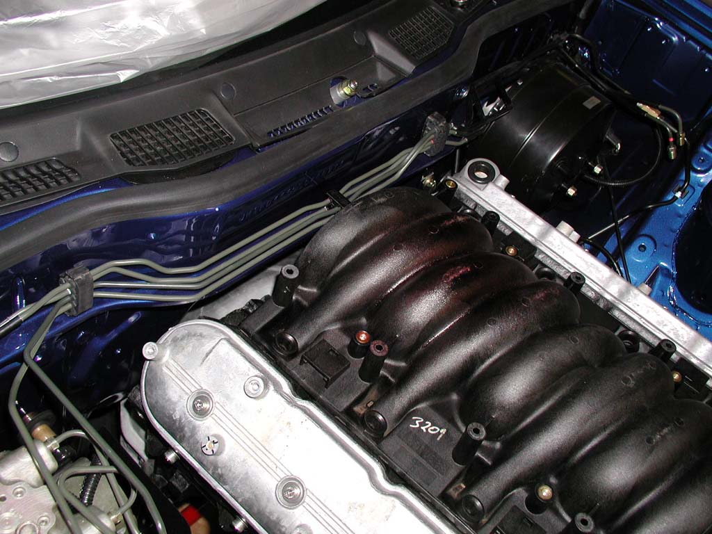

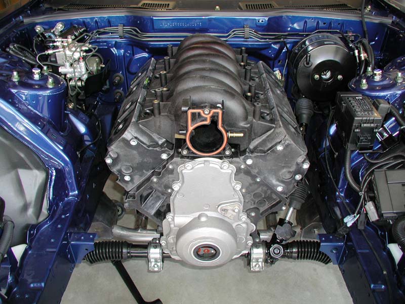

While the 13B-REW is smaller, you're only refering to the short-block. Once you dress the motor up with its heavier cast-iron components, the weight quickly increases. If you think about it, the fact that you can fit a V8 into the engine bay of such a small rotary motor, says something...the turbo plumbing and other accessories add a lot of bulk/weight to the engine.
While the aluminum LS does add a bit more weight, you're talking about a very small amount, and even then, the majority of the weight sits behind the front axle*. While weight isn't desirable, its also a matter of where you place it. The rotaries e-shaft sits higher, which also means the tranny sits higher in the stock car**. The LS' crankshaft and tranny both sit lower. Compensating for the remaining weight is trivial, when you consider a battery relocation easily shifts 40+ lbs from the upper front of the car. When you consider the weight difference in the swap is roughly 50lbs, it requires little relative effort to regain the 50/50 weight distribution (which isn't as important as made out to be). The cars handling remains excellent and many competition V8 RX-7s outperform their rotary counterparts, though thats due to a few other factors/bonuses, such as the difference in torque curve, gearing, and tires.
* http://www.rx7club.com/attachment.ph...1&d=1189361834
Up against the firewall
http://www.rx7club.com/attachment.ph...1&d=1180322876
**Tranny tunnel is huge...large enough to fit the Chevy T56.
