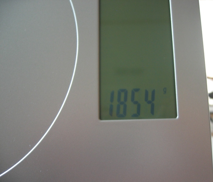

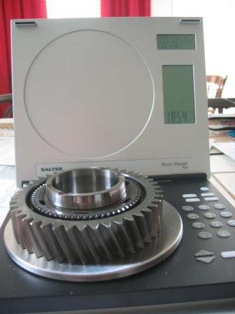

I own and drive both. I never thought I'd like an automatic, but the paddle shift in the IS-F really is hands down better than a manual. It never makes a mistake and it never lets you do something idiotic like downshift into first while still moving. Yes, shifting into first while moving is dumb. Here's why:
Getrag 233 (Toyota V-160) First gear
Yes, that gear weighs over 4 lbs! And all you have to stop it from spinning is a little synchronizer ring with (in this case) three cones hoping for the best. There is no need to shift a street car into first once you are in motion. You're just damaging your gearbox. AMHIK.
To ice the cake, the IS-F won't let you lug the engine either, so Lexus has done a lot to ensure you don't do anything stupid and damage the car with attempts to do the ill-advised or impossible. Ever miss a downshift, stuff it in a gear too low and let out the clutch only to have your engine scream to 11,000 rpm (4200 past redline)? Can't do it with the F. Ever.
So, despite driving manuals and not even owning an automatic anything for MANY years (been driving stick for 42 years - since I was 6 on a tractor in the barnyard), I have to say I really like what Lexus has done with the F. And if I do decide I want to humble myself, I can always get in the Supra and remember how impossible it is to shift 100% smoothly and consistently.
