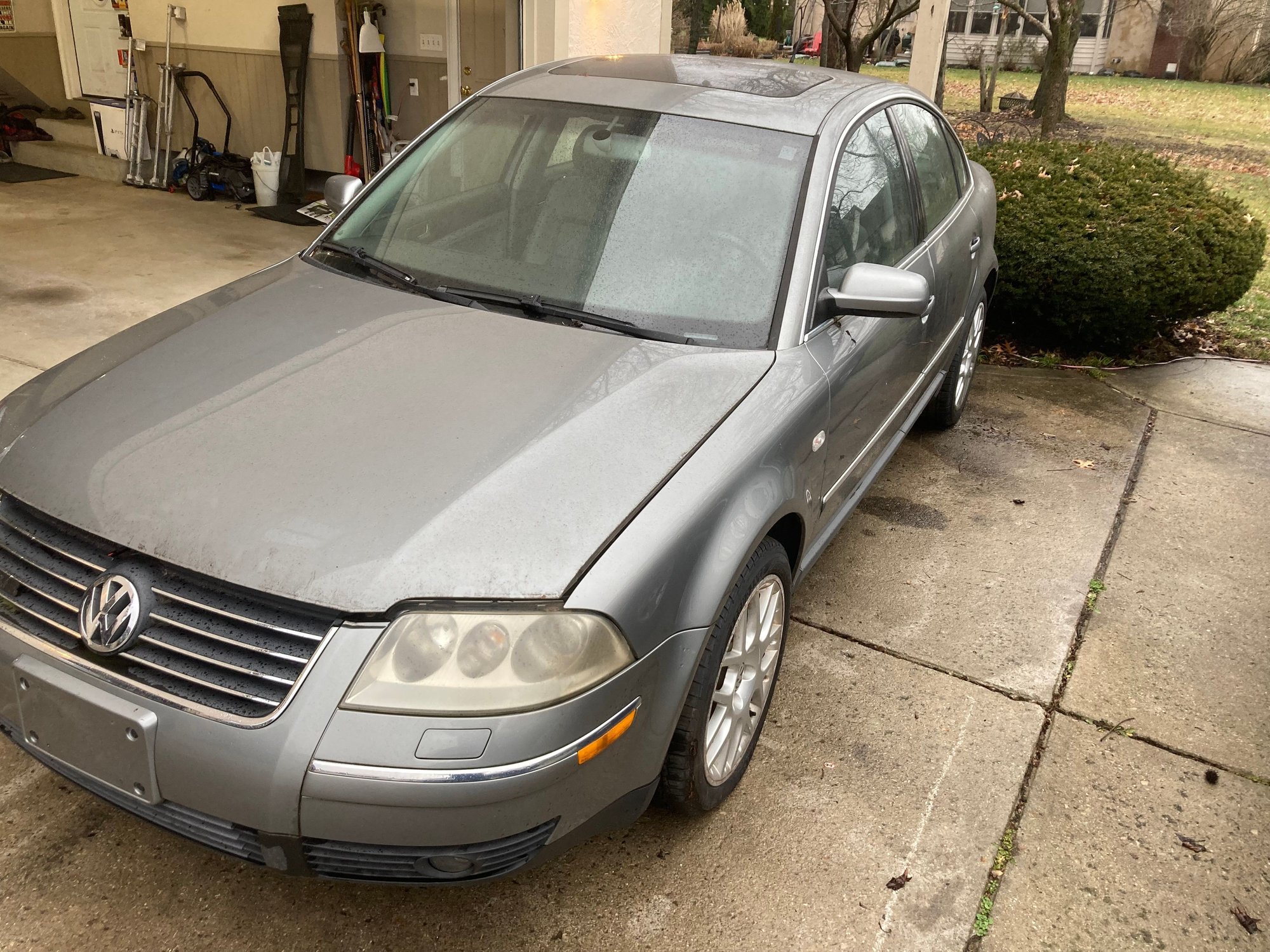

Picked up another rare and difficult to work on car! Not running naturally, $500 and a quick trailer trip home and now I have a new toy!

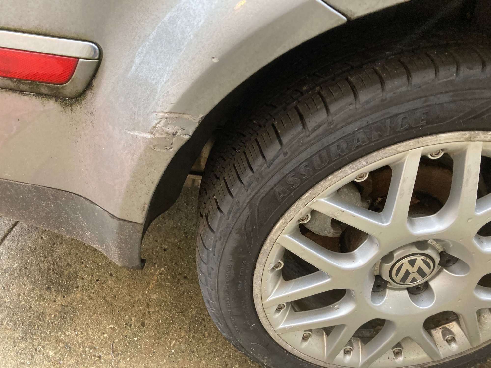

Condition is fine, horribly dirty but no serious damage or paint issues. There is one point of damage on the right rear bumper front, I'll see how badly I'm bothered by it.

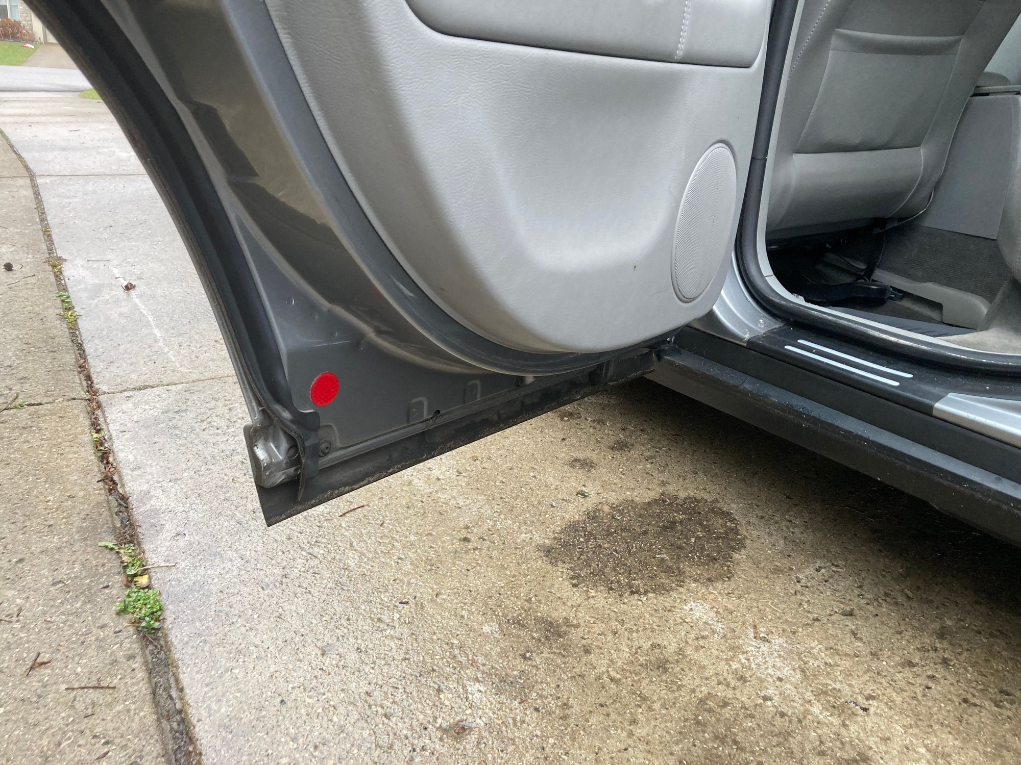

Poor thing has been sitting for a long while

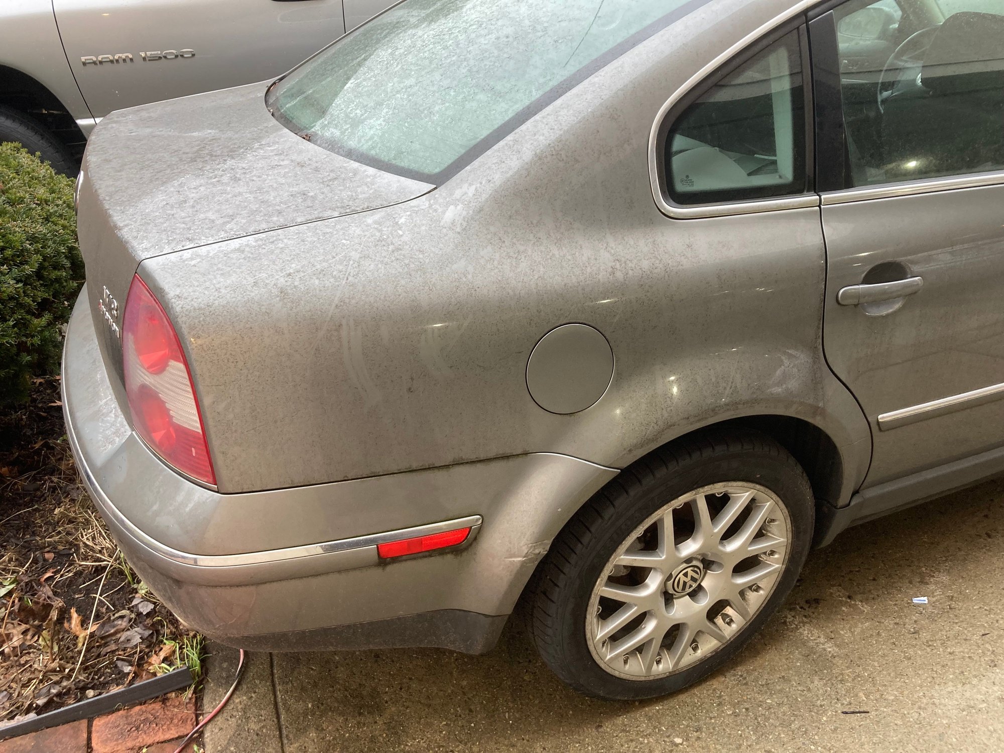

Point of major damage, Im going to see how much it bothers me after paint correction
Point of major damage, I'm going to see how much it bothers me after paint correction
No rust though
No rust though
All the areas that rust first look good

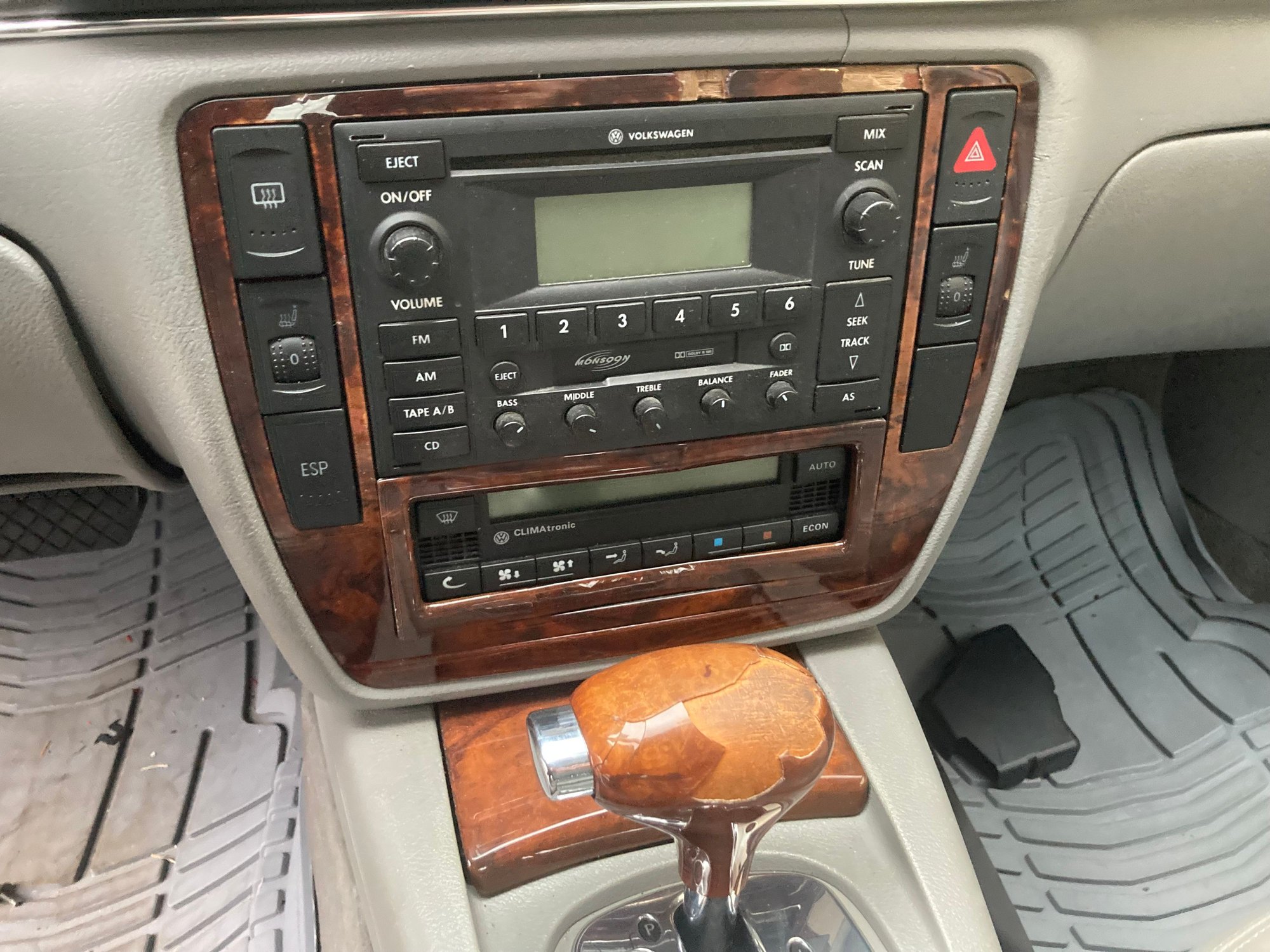

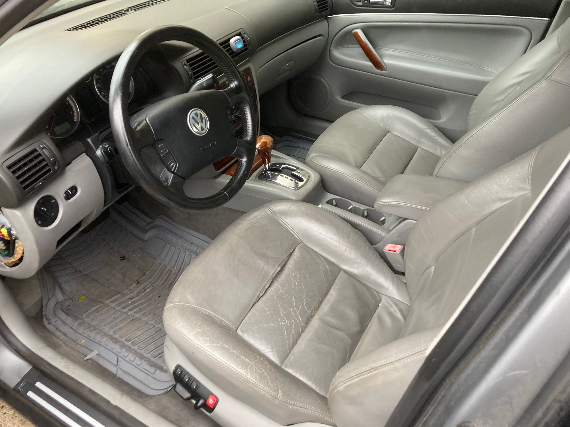

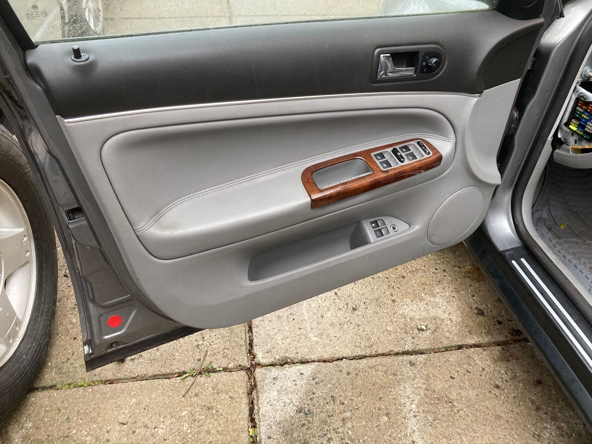

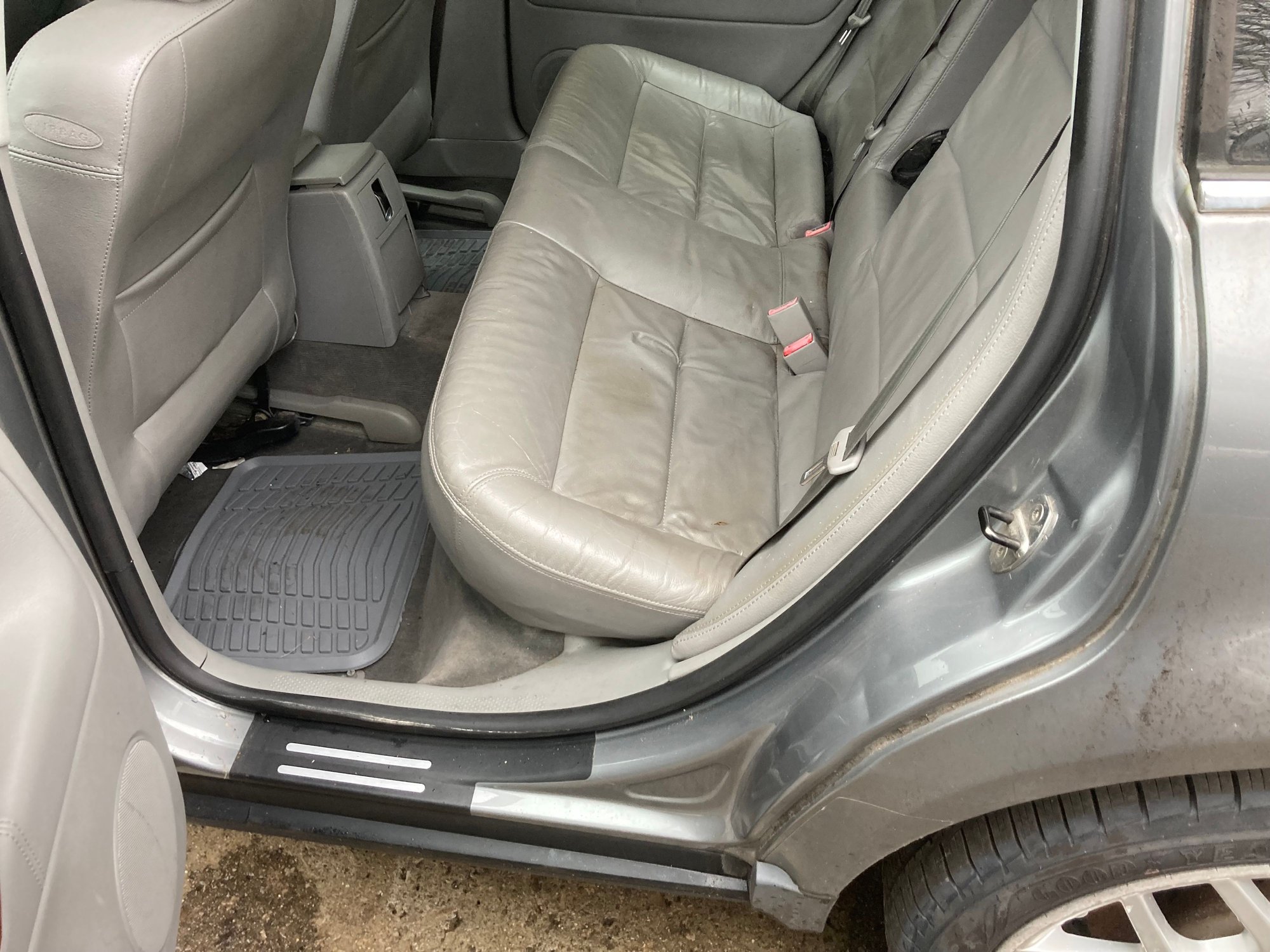

I hate the interior color though, Im already shopping for an all black set to swap in
I hate the interior color though, I'm already shopping for an all black set to swap in
Wood is cracked as well, annoyingly expensive as well
Wood is cracked as well, annoyingly expensive too

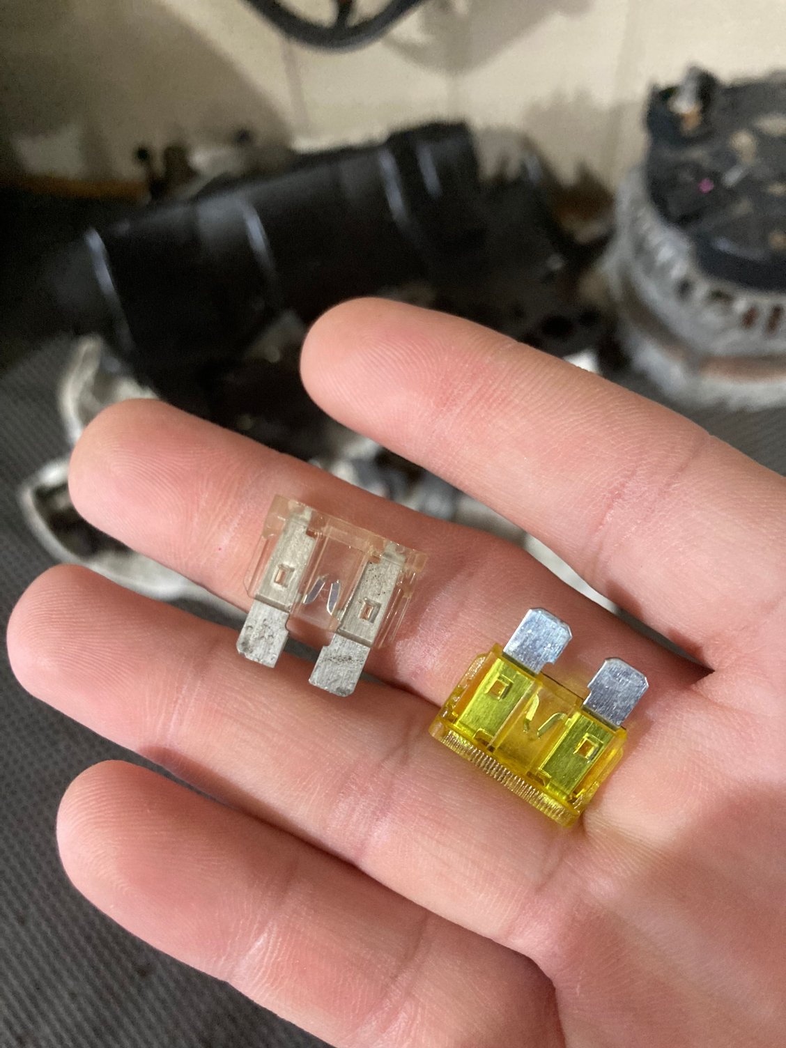

Found these in the car.....

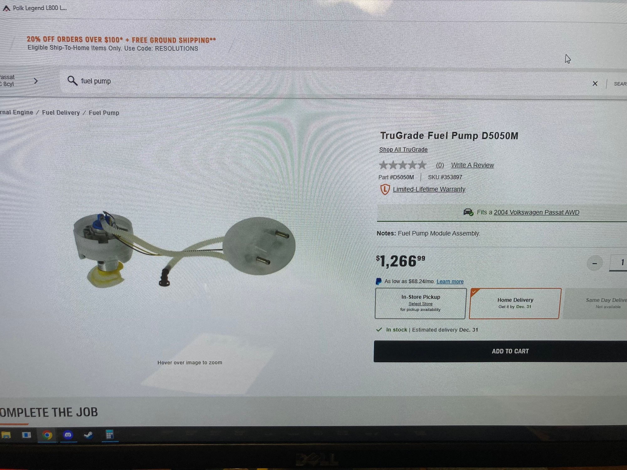

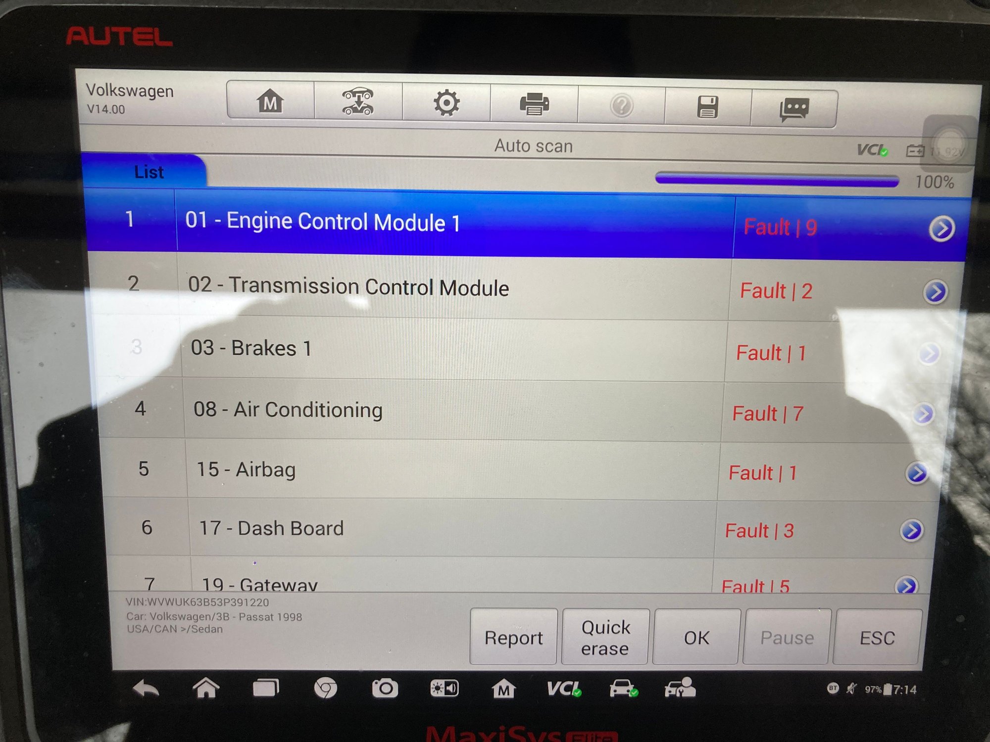

New record! Literally everything is coding. I reset most of it and only a CANbus error came back, I was able to find and fix it as well as diag the no start today though. Just needs a new main fuel pump and the control module harness repaired, these have two fuel tanks, 3 pumps (one main, one syphon and one transfer) and 4 level sensors and the module controls all but the main pump

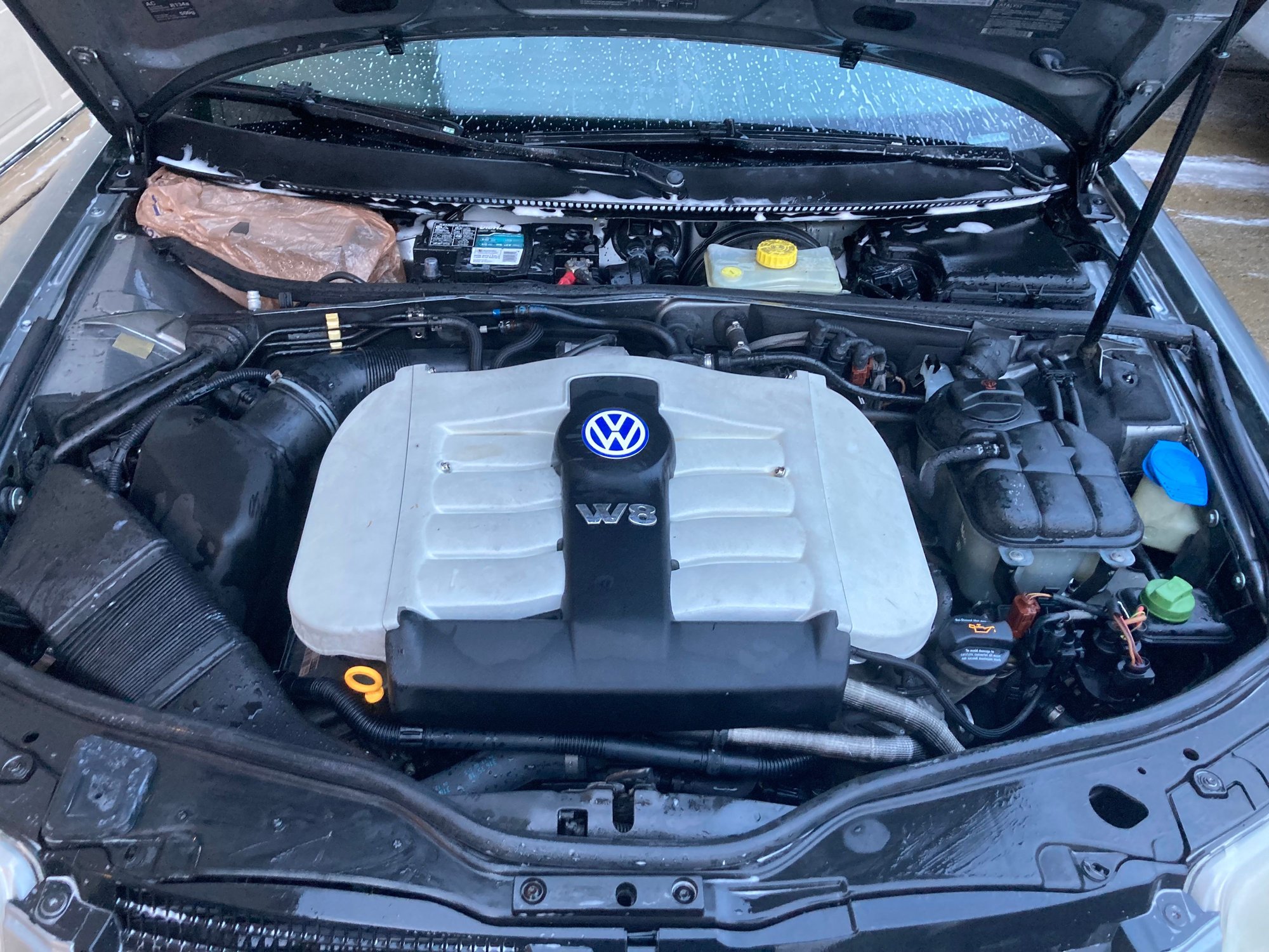

Threw a spare H5 into it, everything is horridly dirty and rodents got into the engine bay so Im sure I will have to fix something on the engine harness.
Threw a spare H5 into it, everything is horridly dirty and rodents got into the engine bay so I'm sure I will have to fix something on the engine harness.

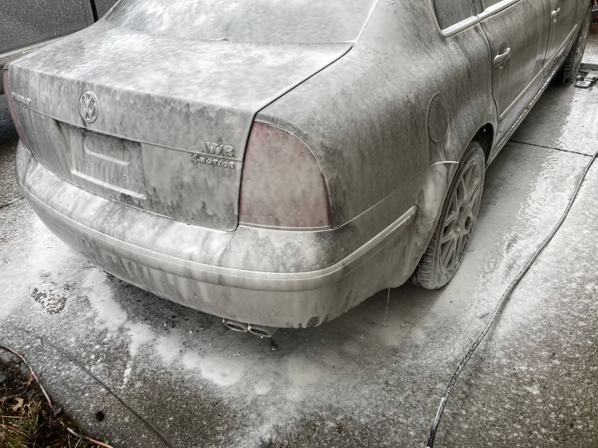

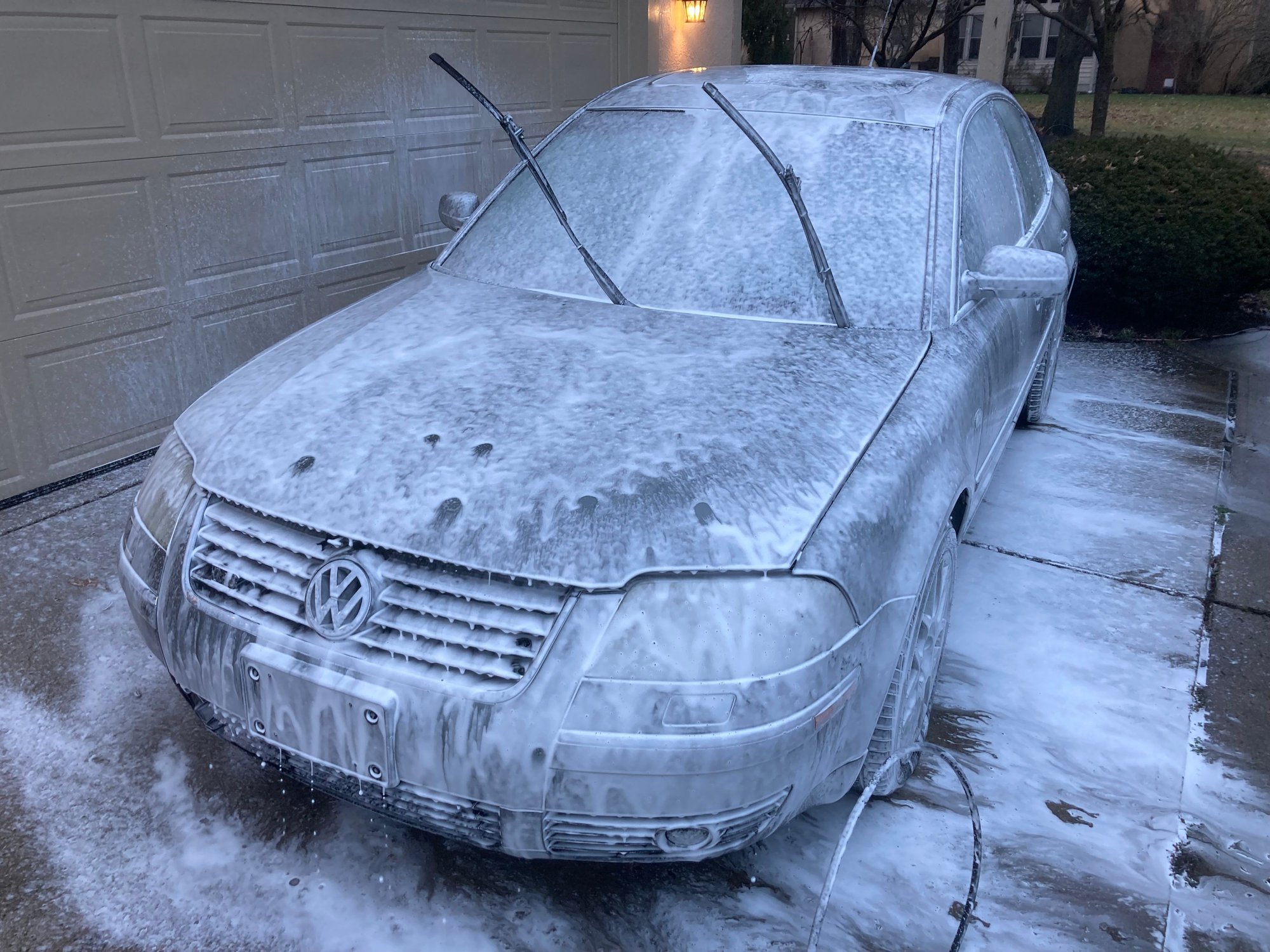

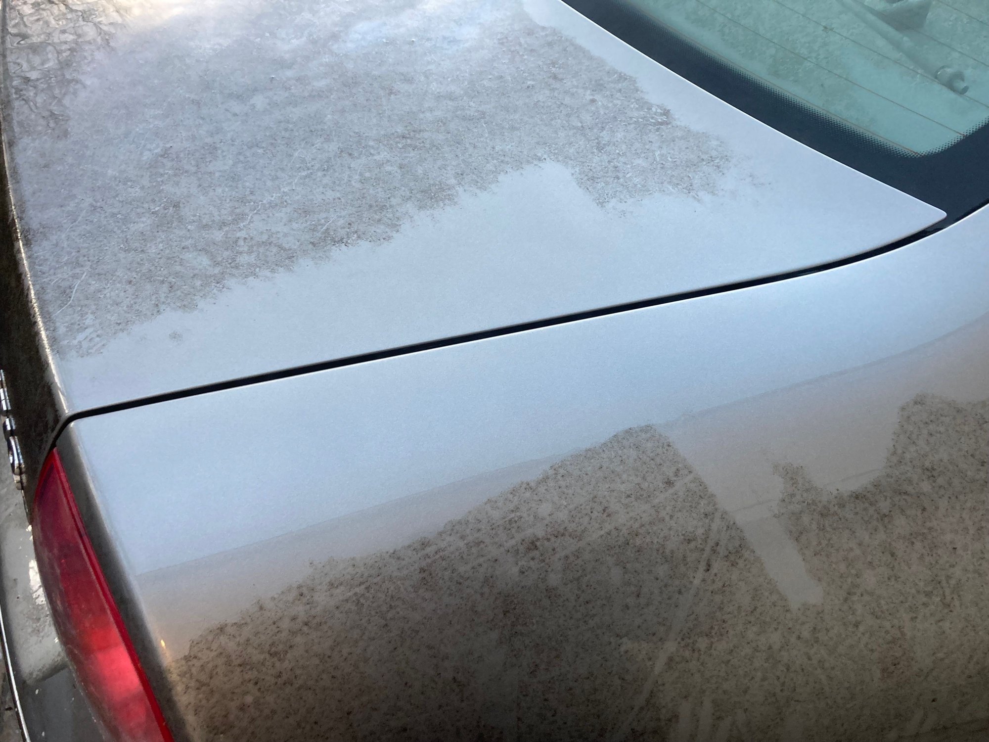

First pass with just hot water, dirt levels were so bad I didnt bother with a contact wash yet
First pass with just hot water, dirt levels were so bad I didn't bother with a contact wash yet
Rinse bucket....after one rinse.

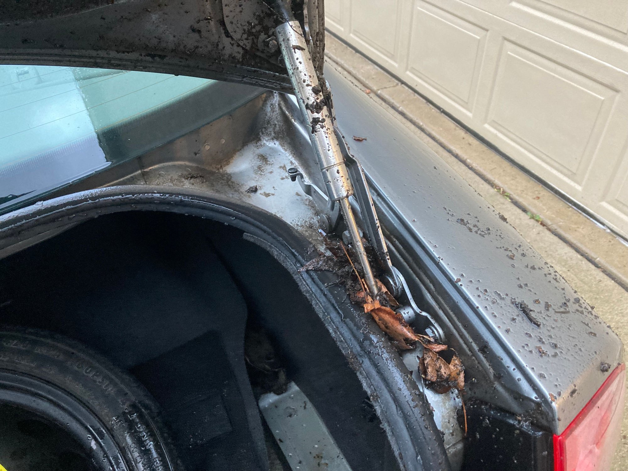

This is after I already hit the trunk lid channel a little. There was a crazy amount of stuff built up everywhere

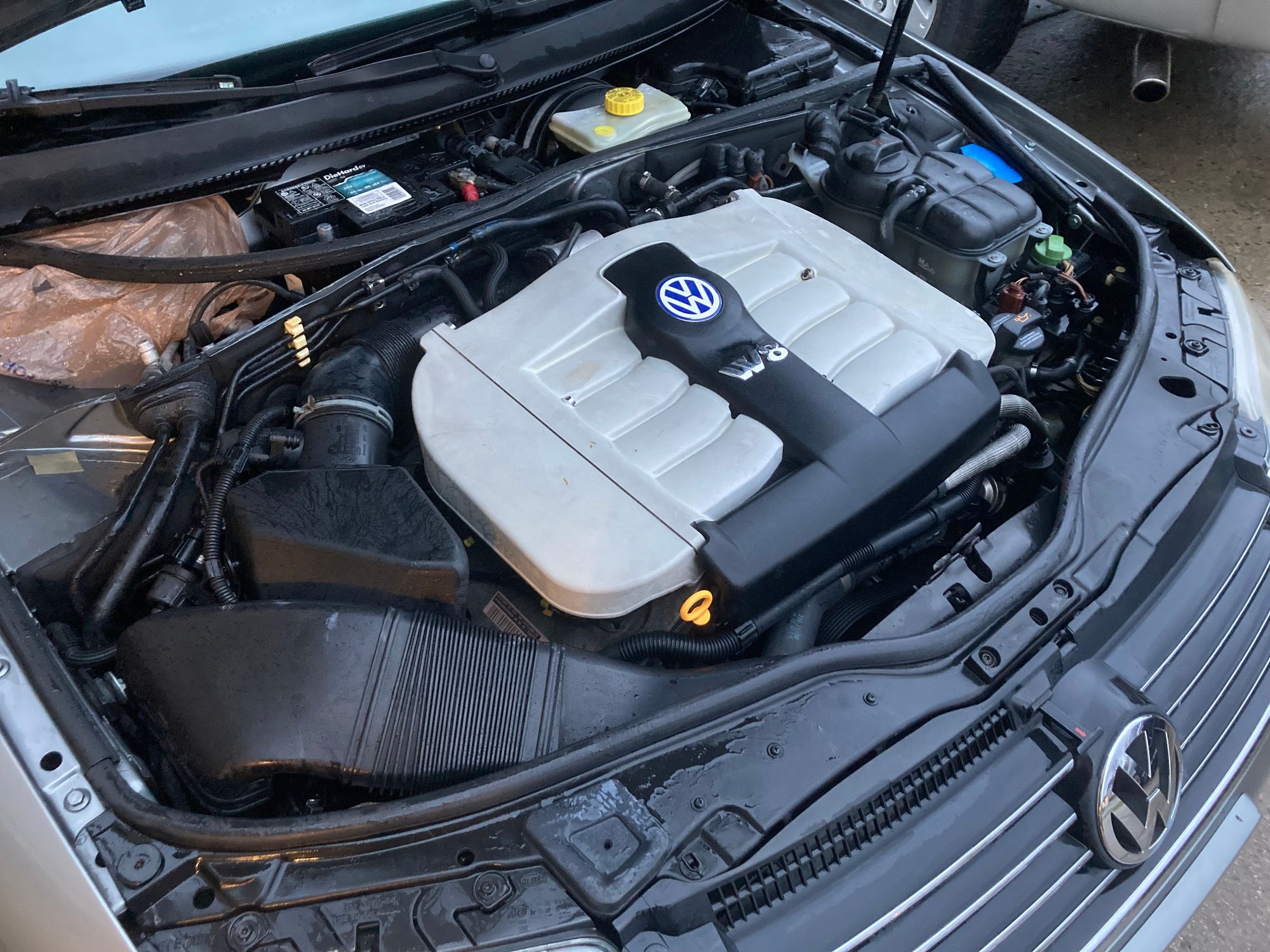

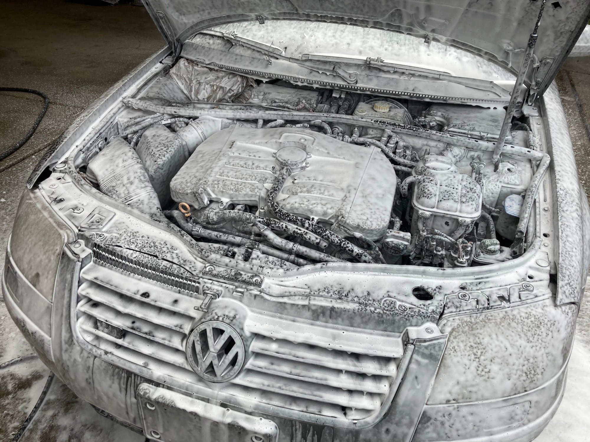

Foam time, engine bay got DEEP cleaned
Thats better
That's better

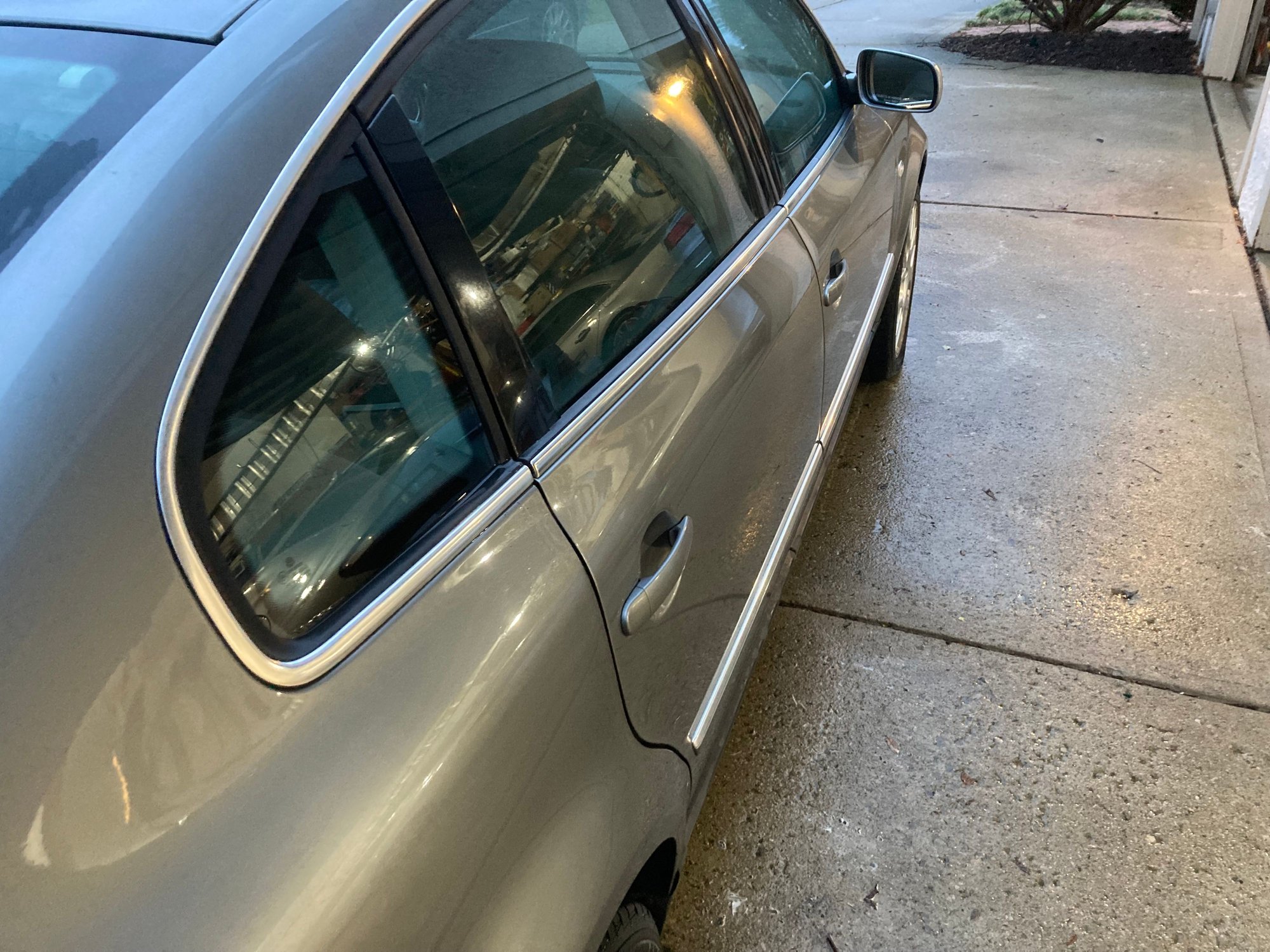

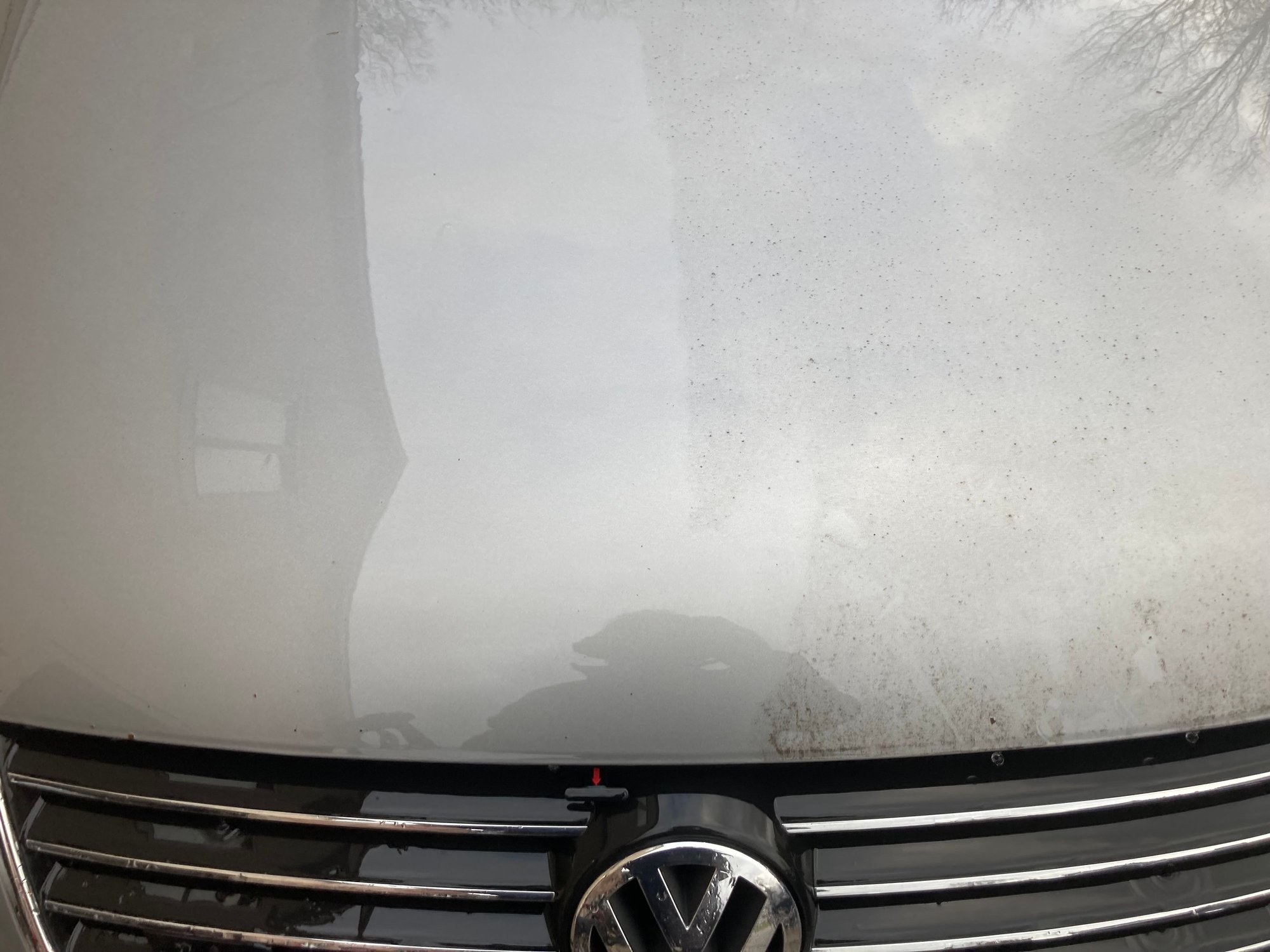

Needs paint correction but the clear coat is strong and even thickness so it will clean up well

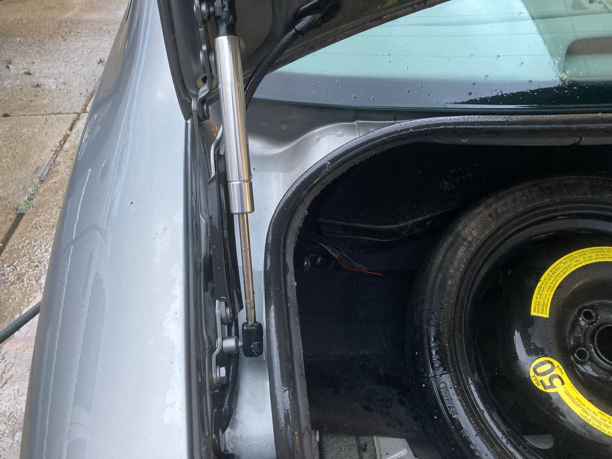

EDIT: All glass is original, all trim is present and I successfully pulled the staining out of the engine intake magnesium. I also for the first time (not counting the LS460) have a new set of matching tires included with the car! Nothing amazing but not having to buy tires is awesome on a cheap car.
Interior pull is Tuesday, it's a "normal step" when I buy new cars I intend to keep but this car actually requires it. Paint correction will likely occur after it's on the road and fully shaken down so if it needs more work I don't have to freak about touching it.

for the broken wiring, are you planning to add a few splices, or will you replace a section of harness? And how hard are fuel pump swaps on these? Tank-drop or in-cabin access?

The secondary tank is a drop at the rear of the car, main tank is in car under the seat and I don't think is something I would consider hard. There looks to be one connector for the return side of the fuel system that may be hard to reach.
I think the reason it got "totaled" is the cheapest pump in any parts network is over $1000 and they were not willing to pay that on top of the needed harness repairs to the aux tank control module.
Interestingly the main pump that actually provides rail pressure had ability to run as a stand-alone even if the rest of the system is dead

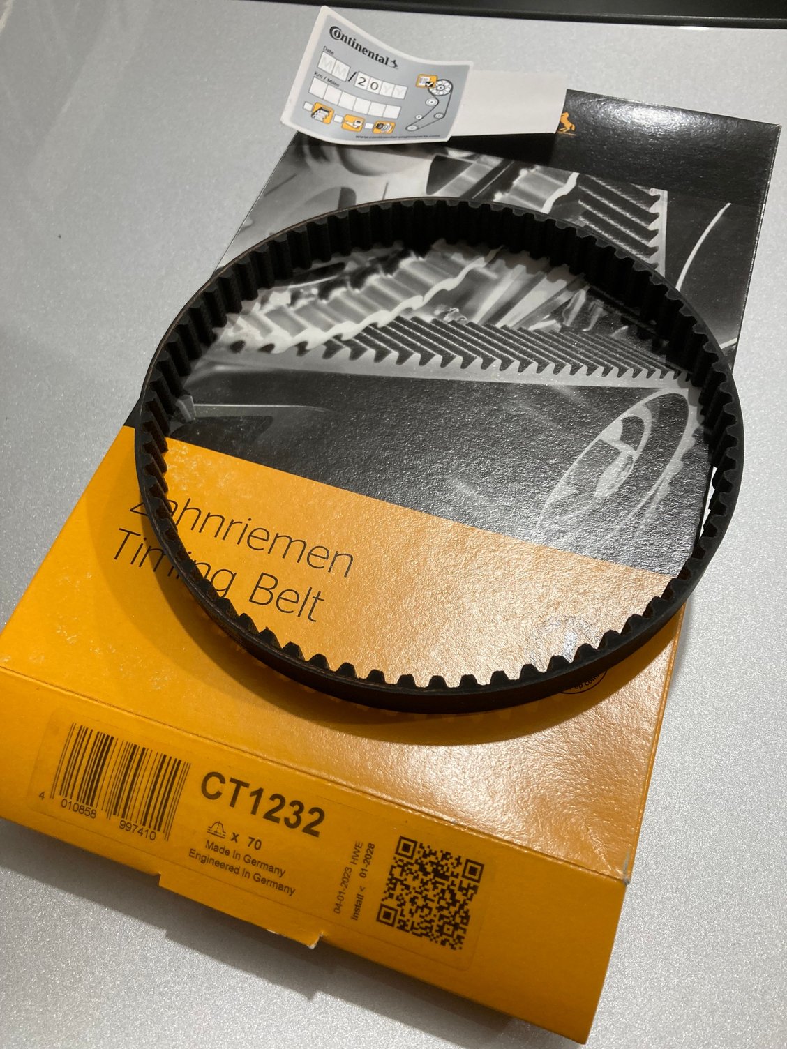

Took a second to find but I have a spare balance shaft belt now. Going to try and get the car running tomorrow

Dumb question, what's that for?
I know nothing about W engines.lol
What's it balancing?
Old Jan 7, 2025 | 05:50 AM
Posts: 18,558
Likes: 1,836
The W8 is not an inherently balanced engine since it's technically a flat plane type crank, same exact issue as a cross plane vs flat plane V8 engine in that a flat plane has some serious vibration issues.
VAG didn't like this as the whole point to the W engines was compactness and power but also smoothness and as close to dead flat TQ shelves as possible. The W8 was on thin ice since it only maintained peak TQ from 2700-5252 vs like 1200-5252 for the W12s....and since the W8 is also a flat plane it vibrates too much. They fixed it by running a balance module that is timed to the crank, it works by rotating an imbalanced pair of shafts at 2x crank speed to cancel out the harmonic imbalance.
Think ANC headphones but for mechanical parts
